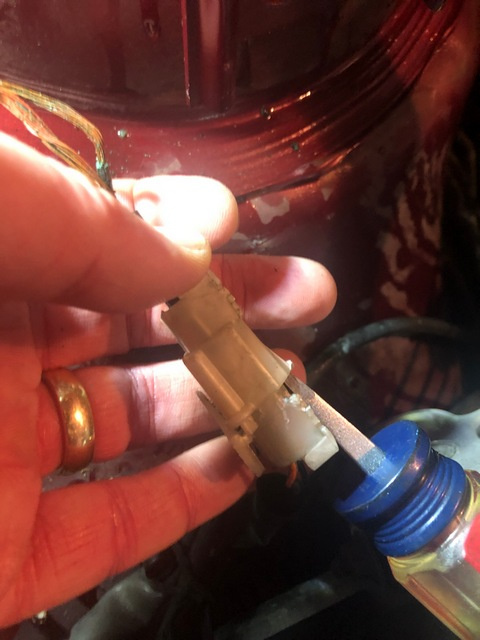

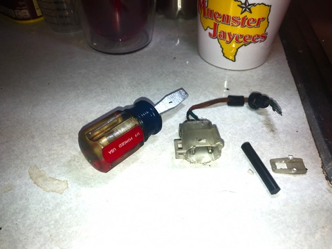

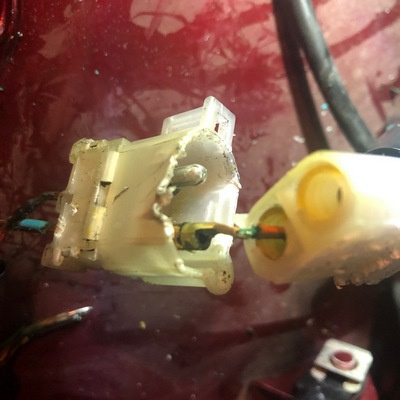

Argh. Clearly it needed to be replaced, but in the end, it did not make my light go out. There was lots of corrosion in the plug itself which made it hard to get out. The cylinder of the old sensor came apart in the tank shaft, and I didn't realize it didn't come out at first. Had to fish it out it with an allen wrench. The old socket was stuck on the old plug, so even after I pried it apart, still had to use needle nose to get the thing apart.
After I found and got the old sensor out of the tank, the new one went in well and plugged in. However....in the end, I still have a light on.
The magnet seemed to be rattling around in there, so I assumed it was still doing its job, but I'm guessing the next step is a new tank.
See images for my handywork. hah!
