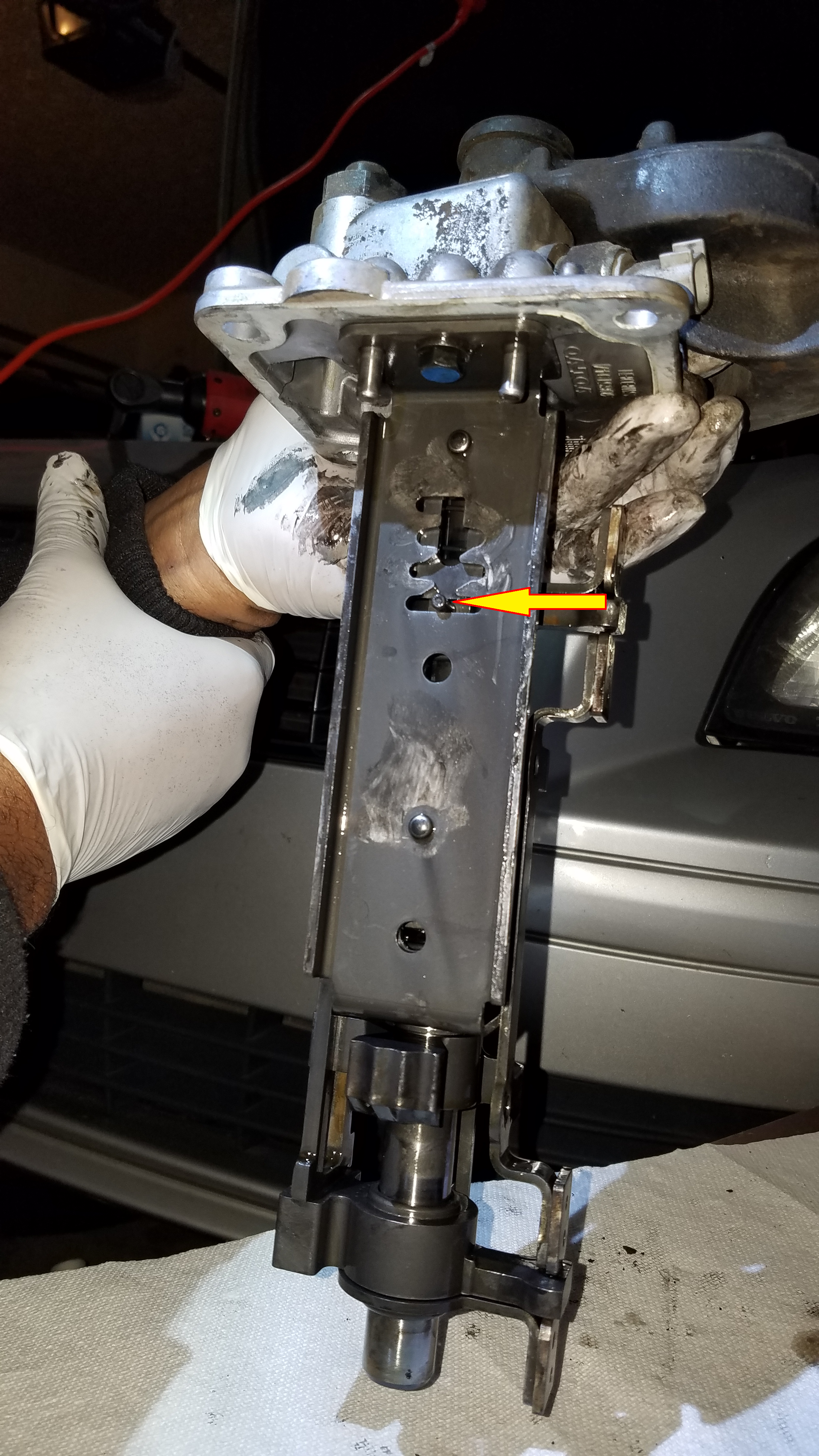

Post by askperry »
I've confirmed that the problem is in the Gear Selector module. I don't know what is causing the problem yet. The pin in the shift gate still won't move back to the neutral position unless it's bumped or hit. In the picture below, the pin is sitting on the side (bottom) of the shift gate when my hands off of the selectors on top.

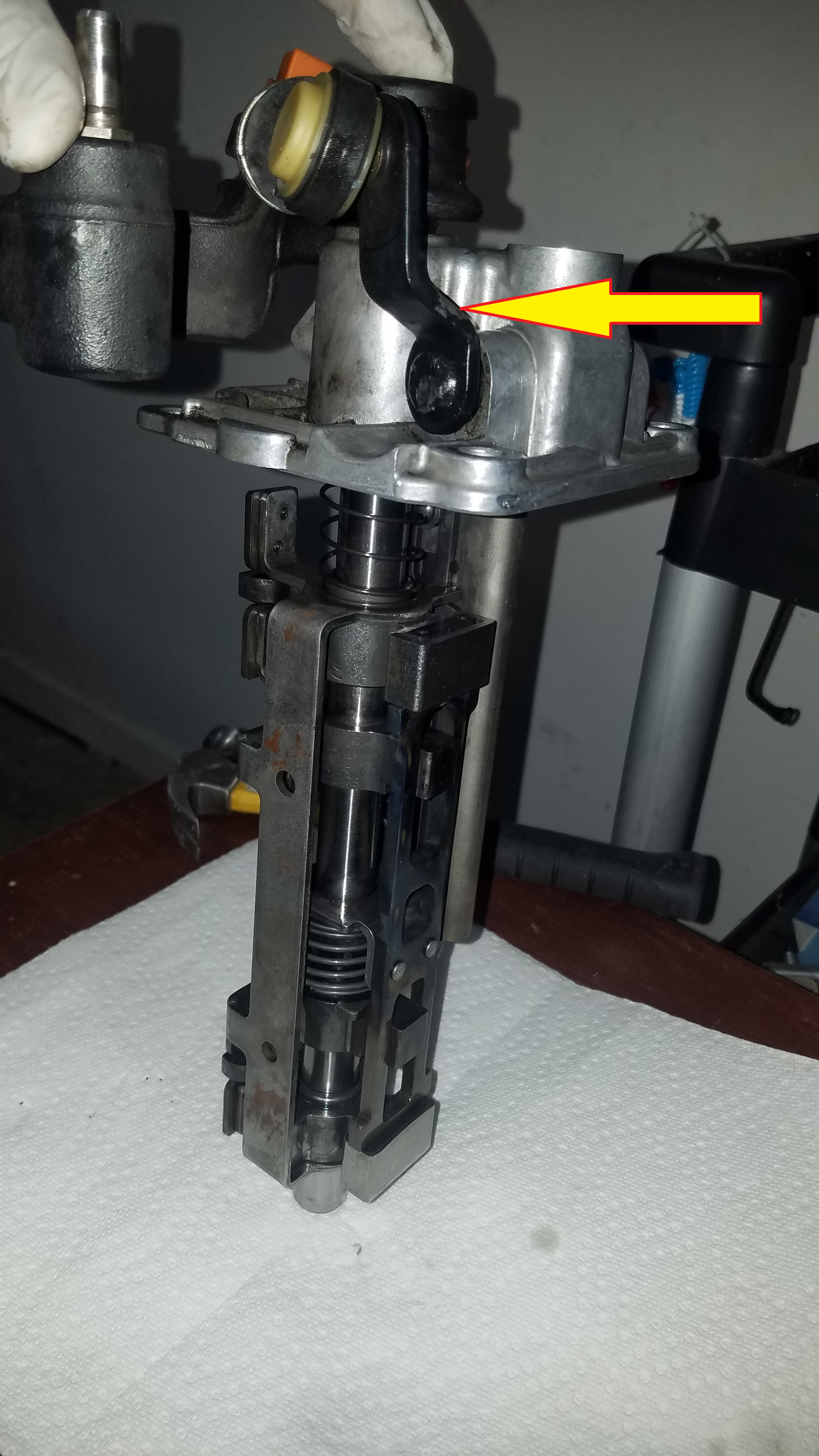

Post by askperry »
After beating, cleaning, fine-sanding and re-lubing every contact point I could find, I decided it was just time to buy a replacement. Just when I was about to put it down, I hard tapped the lateral shift lever, 3 times with a hammer, where it enters the top of the gear select module. That did the trick. The module works now.
