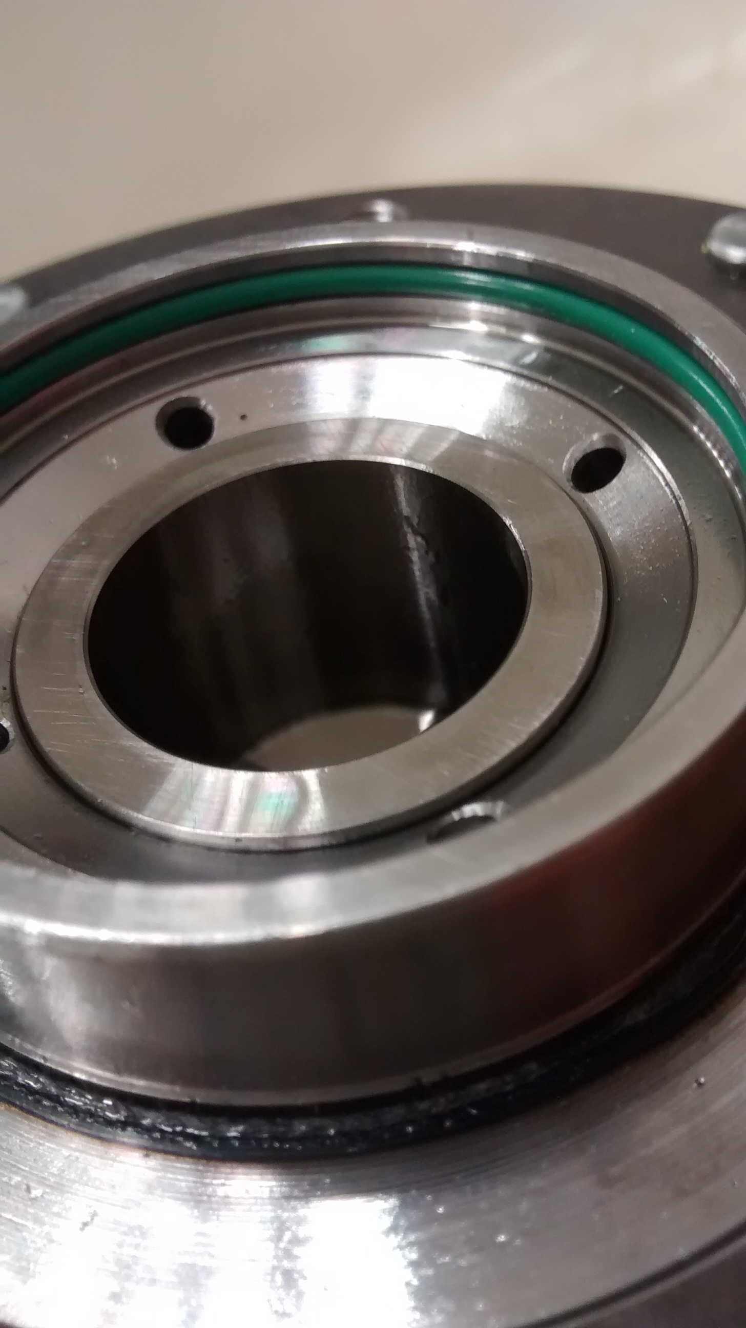

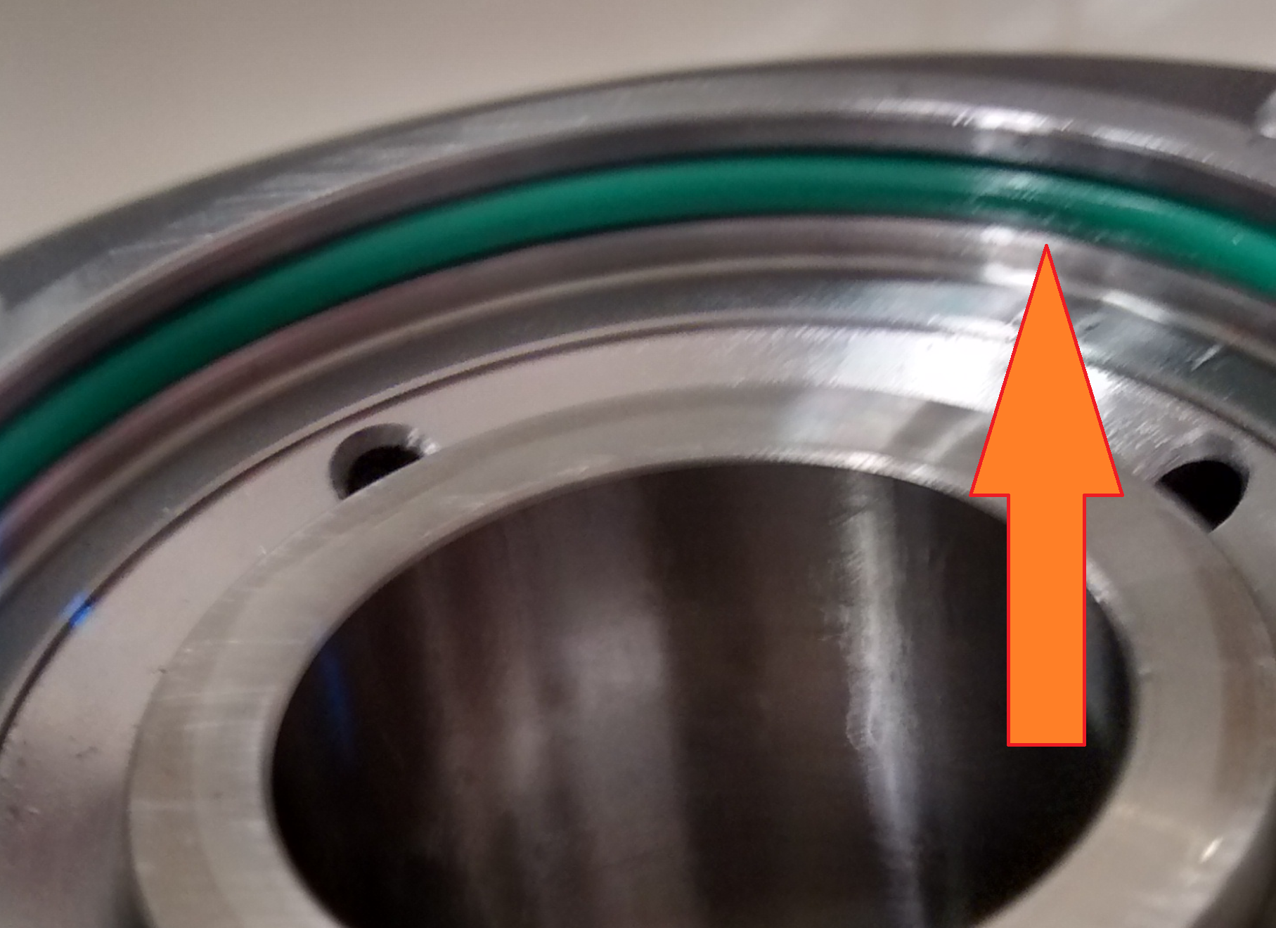

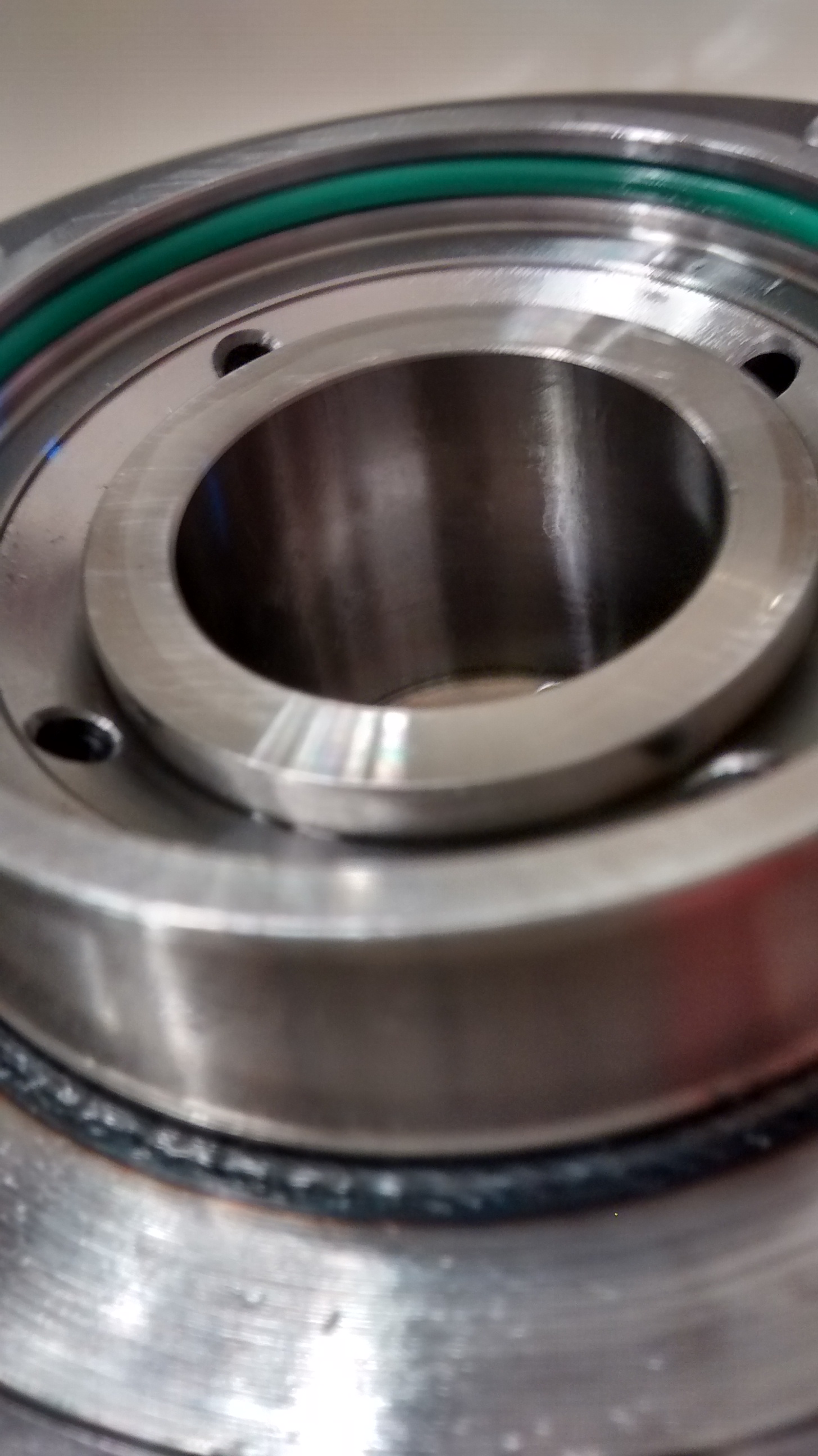

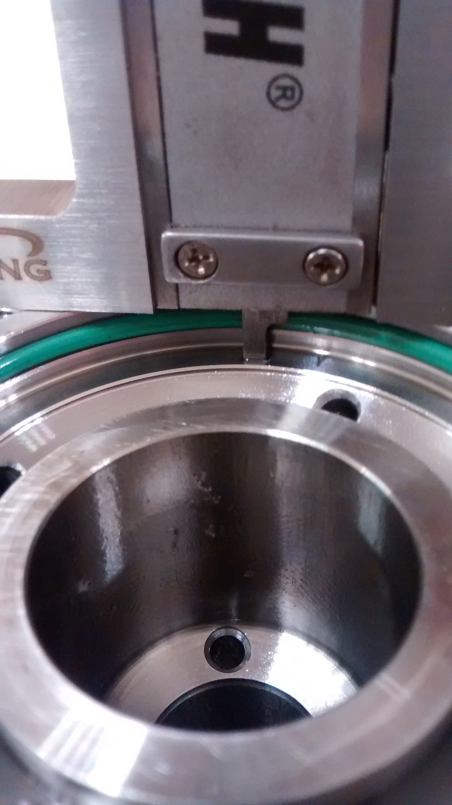

SlowLane wrote: 26 Jan 2020, 22:41 The new VVT hub has just arrived, but I'm afraid that it may be defective. It has about 3 mm of axial play on the inner collar, but having never handled one before, I can't judge whether that's normal or not. I will be planning a trip to the local wreckers soon to see if I can pull off some sample VVT hubs and get a better feel for them.
Thought I would follow up by answering my own question about the VVT hub.
Here is what had me concerned that the new hub was defective. The center collar could easily be moved in and out by a couple of mm with light finger pressure. This concern was reinforced by a couple of officious-sounding YooToob videos which identified such play as a sign of a faulty hub.
So I took a field trip to the local pick'n'pull to educate myself about VVT hubs and get some practice at removing one. I discovered that when unmounted, the hub I removed had about the same amount of play as my new one, but when mounted had virtually no play at all. Closer examination of how the hub mounted onto the camshaft revealed that two surfaces of the hub abut onto the camshaft mounting surface: the collar itself and the annular ring around the periphery of the hub socket. When the hub is bolted onto the camshaft, the collar fully extends, which means that the amount of end play is determined by the difference between the annular mounting surface and the mounting surface of the collar. In the pictures below I show how measured the difference between the two, which turned out to be 0.004". I'm quite happy with that, and also happy that I didn't waste $300 on a boat anchor that would undoubtedly be a struggle to return.

Post by MoVolvos »
While you're at it change the seal.

MoVolvos wrote: 10 Feb 2020, 15:47 -
Thanks. Sharp eyes, there.
However, it's a brand new seal, supplied with the brand new hub. The apparent damage in the photo is a trick of the light, compounded by the light machine oil coating. I just inspected the seal again and it's about as good as a new seal can be.
