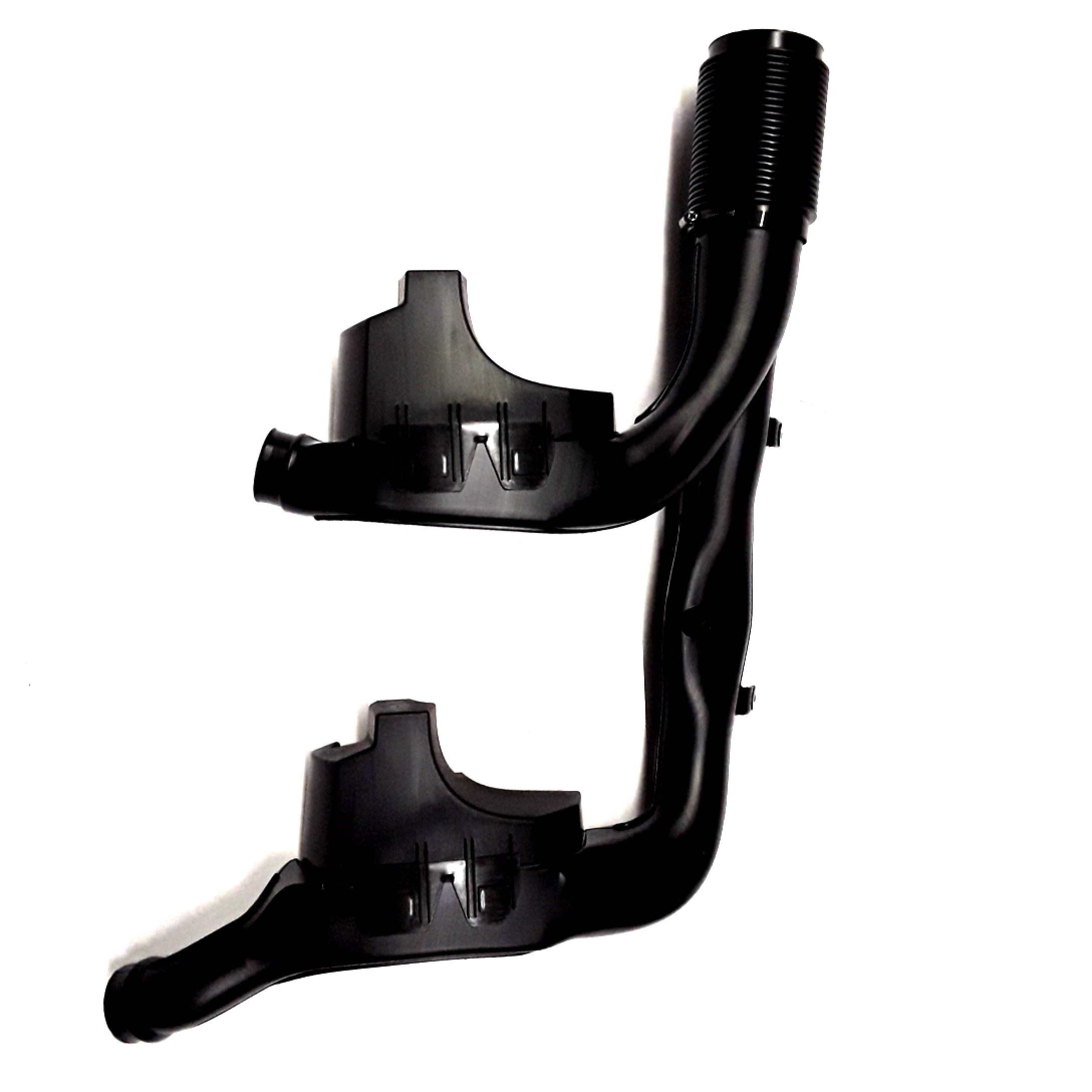

Does your Fresh air hose to the turbos have the boxy baffles on the sides of the pipes? The rubber seals on the baffles can leak.

No baffles on this one. They are straight and we’re pretty easy to clean. I am getting ready to reinstall the air box now and see if the reading changes. Thanks for the advice I knew these maf sensors were finicky, just did not know how much.
