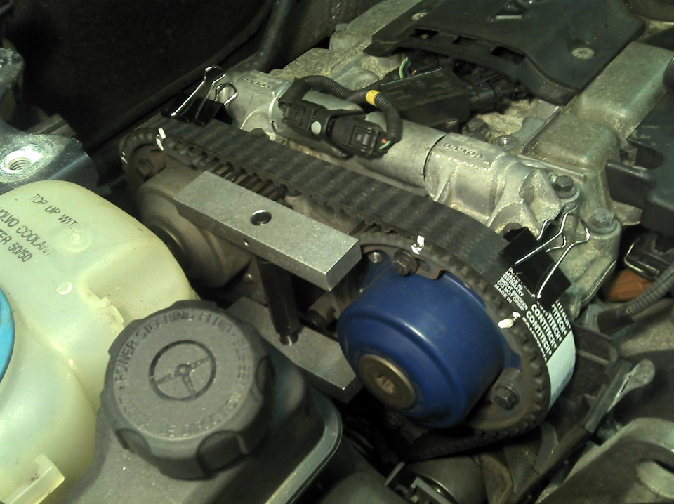

Are you replacing camshaft seal or VVT hub? For t-belt alone locking tool is not needed...
As said, do marks on old t-belt and all sprockets (two camshafts, one crankshaft), remove t-belt, transfer marks to new t-belt, count teeth between marks twice, install. Use paper clips to hold t-belt on camshaft sprockets:
Here on the pic I did my first t-belt and have used a sprockets lock tool, but it was not needed at all. It turns out I did two marks on each sprocket, just to play safe.
Also, don't use Contitech belts for this engine, they are not good :)

Yes to the paper clips! Thanks for that VTL. I’ve used the miniature Irwin quick clamps to hold the belt to the sprockets. And the paint mark on the crank pulley/belt is a must too.
The VVT hub on yours may be the spring loaded type. Mine was. Since I reused the hub the quick clamps were also a must. The new hubs aren’t spring loaded.
VTL - could you expound on why you recommended against Contitech belts?
I’d have to look, but I know I have them on 2/4 cars right now. Probably 3/4. I change them at 75-80k & have never had a problem.
