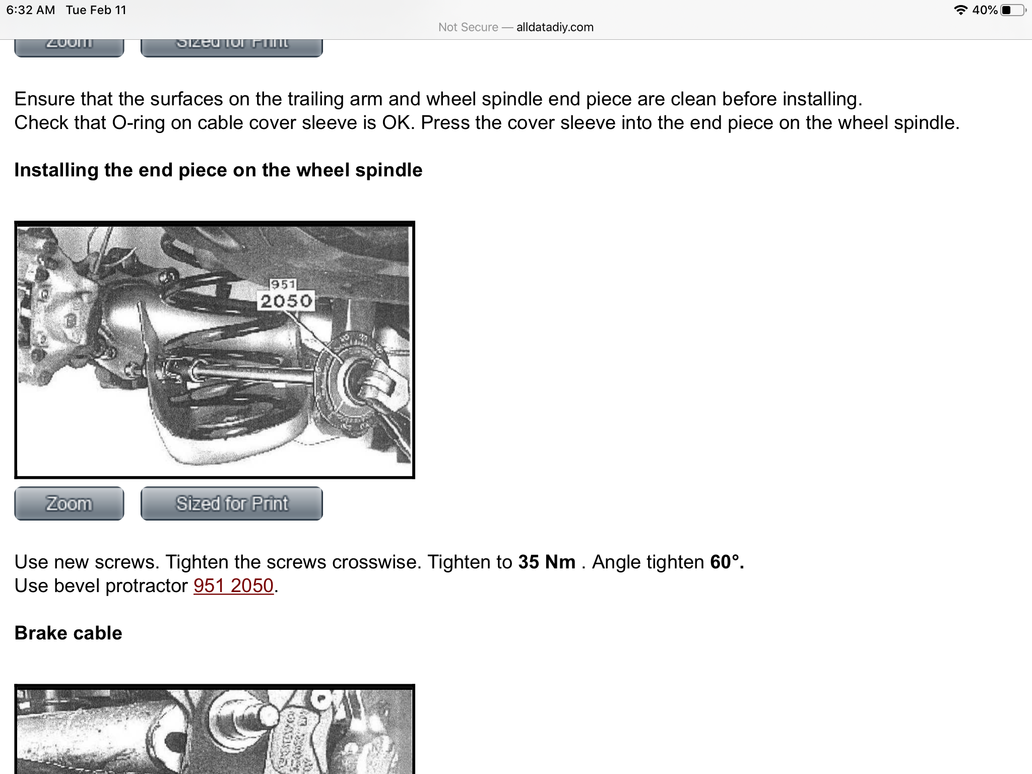

- Posts: 36138
- Been thanked: 4064 times
I see lower torque in Alldata, 35 Nm and 60 degree angle
Note that new hardware is also specified.
