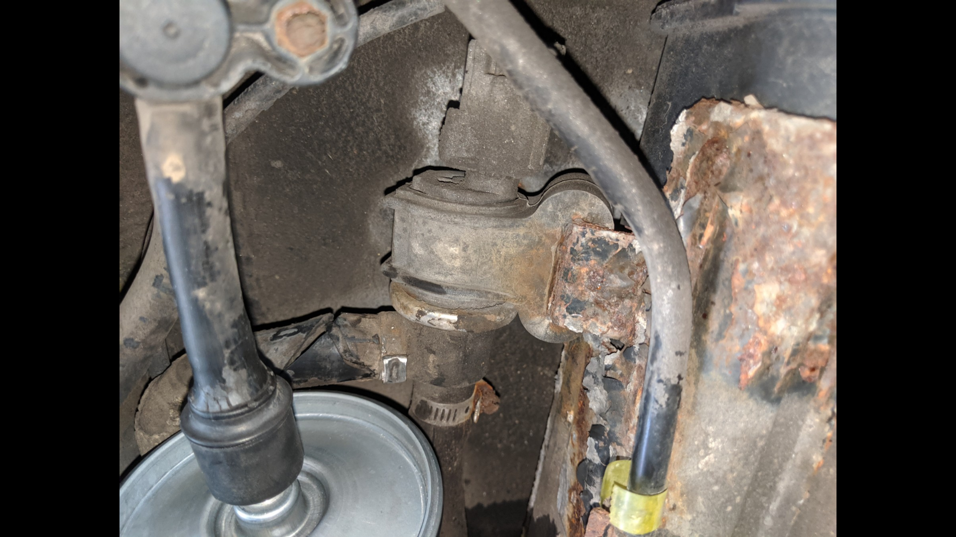

Maybe this is what I'm dealing with then, as the problem started after I replaced this torn vac tube pictured in the bottom left. I'll look into roll over valve. But for OP I'm not sure if I have enough experience to add to this conversationscot850 wrote: 31 Jan 2020, 22:07 Other thing to check is the roll-over valve is operating correctly. They can jam and restrict air flow through the gas system

I had similar trouble at the filling station too. In my case, the hose at the roll over valve was damaged and restricted. I replaced it and haven't had trouble since. Pictures here:

On the '97, the roll over valve is near the right rear wheel, under the car next to the fuel filter. I'm not sure where it's located on the '98.
