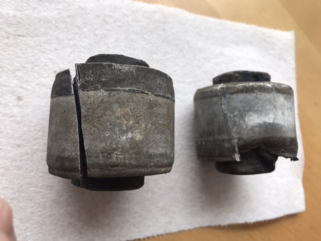

One thing that’s always bothered me about P2’s is how the arse end of these cars reminds me rather vividly of a “sulky”. As in, the little trailer that is towed behind a walk-behind zero-turn mower - the operator stands on it whilst operating said ZT mower.

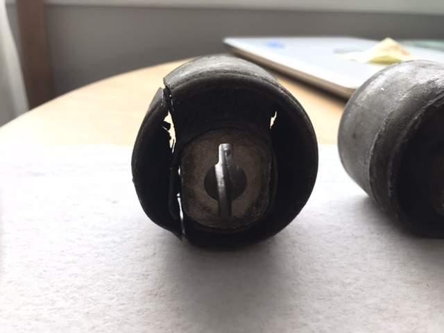

I’ve replaced quite a few parts trying to mitigate this handling annoyance but never successfully pinpointed the source of why the back end of these has always felt like it’s disconnected, along for the ride, just kinda wandering around back there...until now. Hit a bump & you feel the rear end squirm around in an unpredictable manner. I’ve seen the term “side-hop” used in reference to P2 Volvo’s, particularly the S/VR’s. I don't know if that's what I've felt for so many years, but after having done these bushings I feel like there's a greater sense of confidence & composure in corners, especially corners with dips, bumps, any imperfections really.
I’m sure lots of you have looked at the various moving parts in your rear suspension & have noticed there’s so many things connecting this to that, and that to the subframe etc. Amazing how it all works, well sort of works. You’ve also probably noticed torn bushings at the front attachment point for your trailing arms.

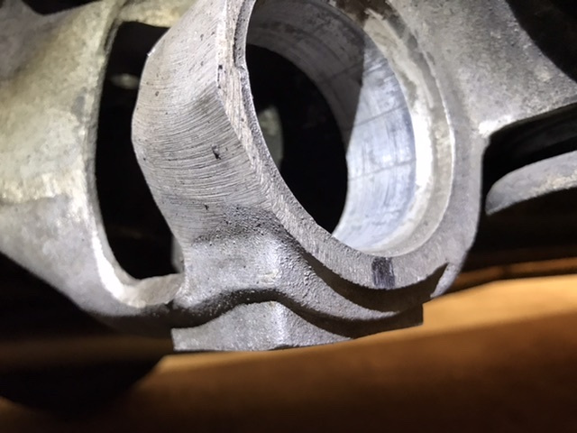

For the longest time I just thought the area where the tear is plainly visible on the front & rear of where the bolt passes through was there for a reason; to allow movement as the suspension travels up and down. Well looking at the new bushings there really is no way for them to allow for as much movement as the bushings these cars originally came with.
My theory is that the old bushing allowed for, over many years of use and hundreds of thousands of push/pulls, too much movement, and as a result the loosey goosey rear end feel. I'm open to ideas here, but to me, the way the original bushings allow for this movement creates a condition where toe is constantly varying depending on how far the rear suspension is compressed or extended. Is that the loosey-goosey I've had my finger on the pulse of?

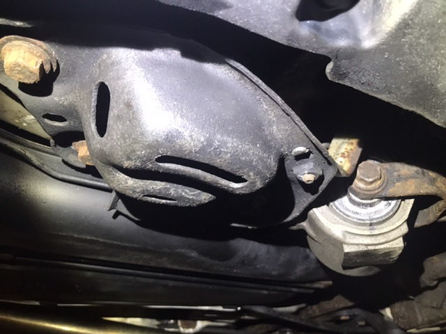

Where I feel the risk to cracking the subframe lies is as follows. To get access to the bushings you will need to remove the trailing arm. Very simple to remove, but you can’t remove the bolts unless the suspension is compressed. This is not a job to do on a lift because it simply doesn't make sense to use a lift. So get your jack under the knuckle/control arm (directly below the lower strut mount) & mash it back up, just to the point before it begins to lift the car off the stands. Now the bolts can come out & trailing arm can be removed.

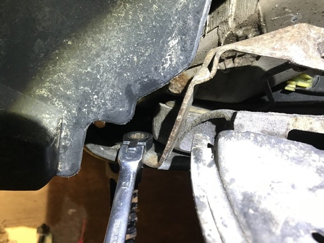

I read that removing the bracket (pic below) that attaches the front of the subframe to the car is necessary so you can get your mini press tool situated to press the old bushing out/new one in. Removing this bracket simply is not necessary, for the record. I would leave it right where it is!
So with my jack keeping the suspension compressed, I took that bracket off. Then, I ever so slowly began to back the pressure off my jack, and stopped almost immediately. I noticed that front corner of the subframe began to lower from the car. The suspension actually twists the entire aluminium subframe as it decompresses. I stopped instantly & realized this has got to be why cracked rear subframes exist due to replacing these bushings. So mashed the suspension back up & put the bracket back on.
You do need to take this bracket & move it out of the way. There is a plastic push clip that secures the hard brake line to the backside of the bracket I mentioned/pictured just above this paragraph.

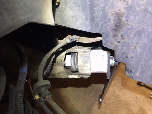

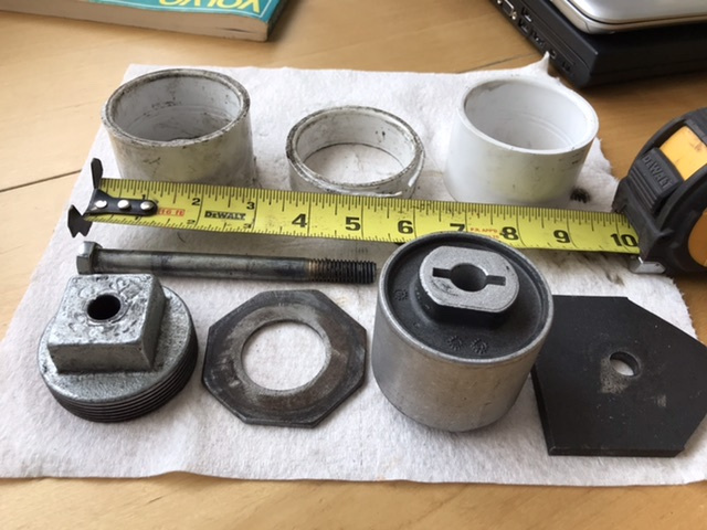

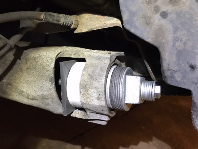

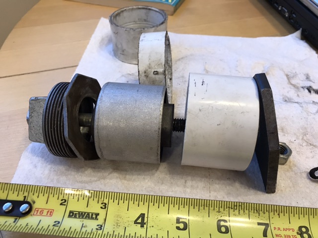

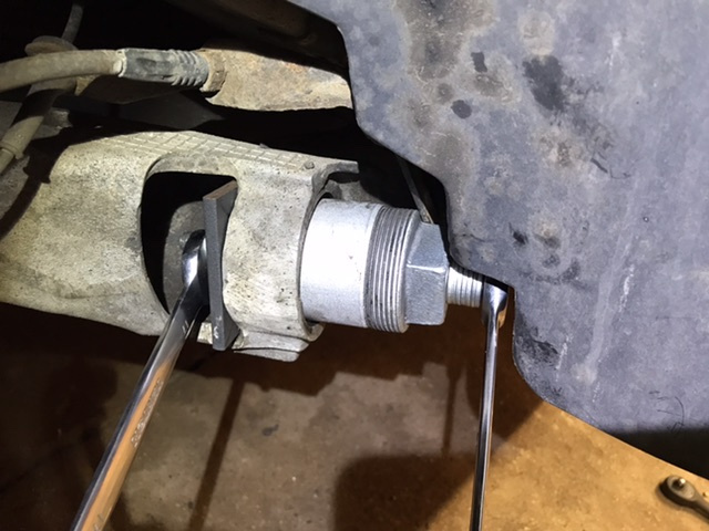

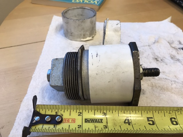

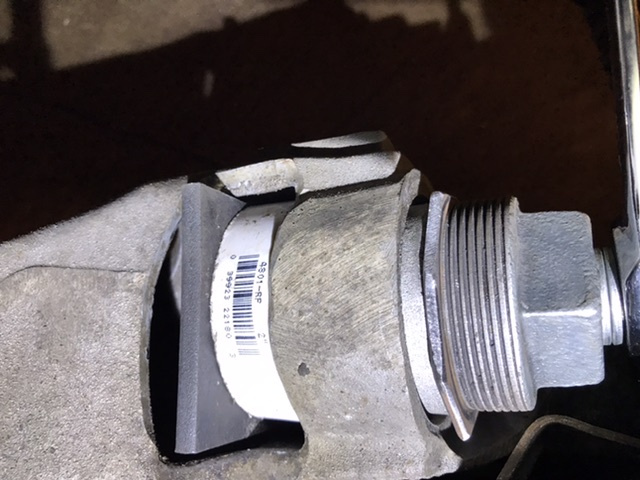

Here’s the press tool I rigged up. A few 2” PVC repair couplings, one of which you cut in half (have a couple spares in case one cracks), a modified 2” galvanized plug, 7/16” grade 8 bolt, washers that fit on it, nut, and a couple steel plates cut & drilled to fit. I used a coarse thread bolt & even after doing (edit) 8 (technically 16) bushings with the same bolt and nut the threads hadn’t deformed at all. The 1/4" plate actually bends inward towards the 7/16" hole on the really stubborn ones, so flip it over when you start to notice it becoming concave. If anyone wants to borrow it just gimme a holler.

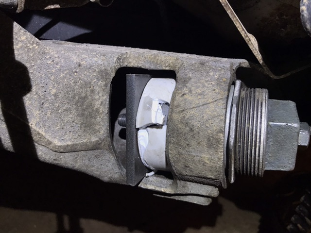

Here’s my 2nd example of a cracked PVC “receiver”. Wear safety glasses, please. I may make a steel or aluminum receiver since I ended up cracking 2 of my PVC ones. Even being cracked they still allowed me to finish fully drawing the bushings in.
On the car:

I just borrowed the tool from Pete and completed this job.
The tool came neatly packaged like a professional toolkit. The dimensions fit the tight spaces perfectly, so that indeed only the trailing arms and the brake line bracket and nothing else needed to be taken off for this job.
The old bushing came out surprisingly easily, took maybe 5 min each (granted I live in SoCal, corrosion and seized parts are rarely a problem).
Pushing the new bushing in took longer, as almost all my tools are metric, the only SAE tools are some short Harbor Freight wrenches, too short to provide adequate leverage for me. I had to double-wrench on the nut and bolt, slipping constantly, but after some struggle the bushings were finally driven in. If I had bought some long handle wrenches and maybe SAE sockets it would've been much easier. None of the PVC couplers cracked in my job.
The old bushing rubber was completely torn on the top, still attached at the bottom. The improvement was not dramatic but noticeable, there is less wandering and shaking in the rear when going over curves on the highway, pot holes and longitudinal grooves on the road.
