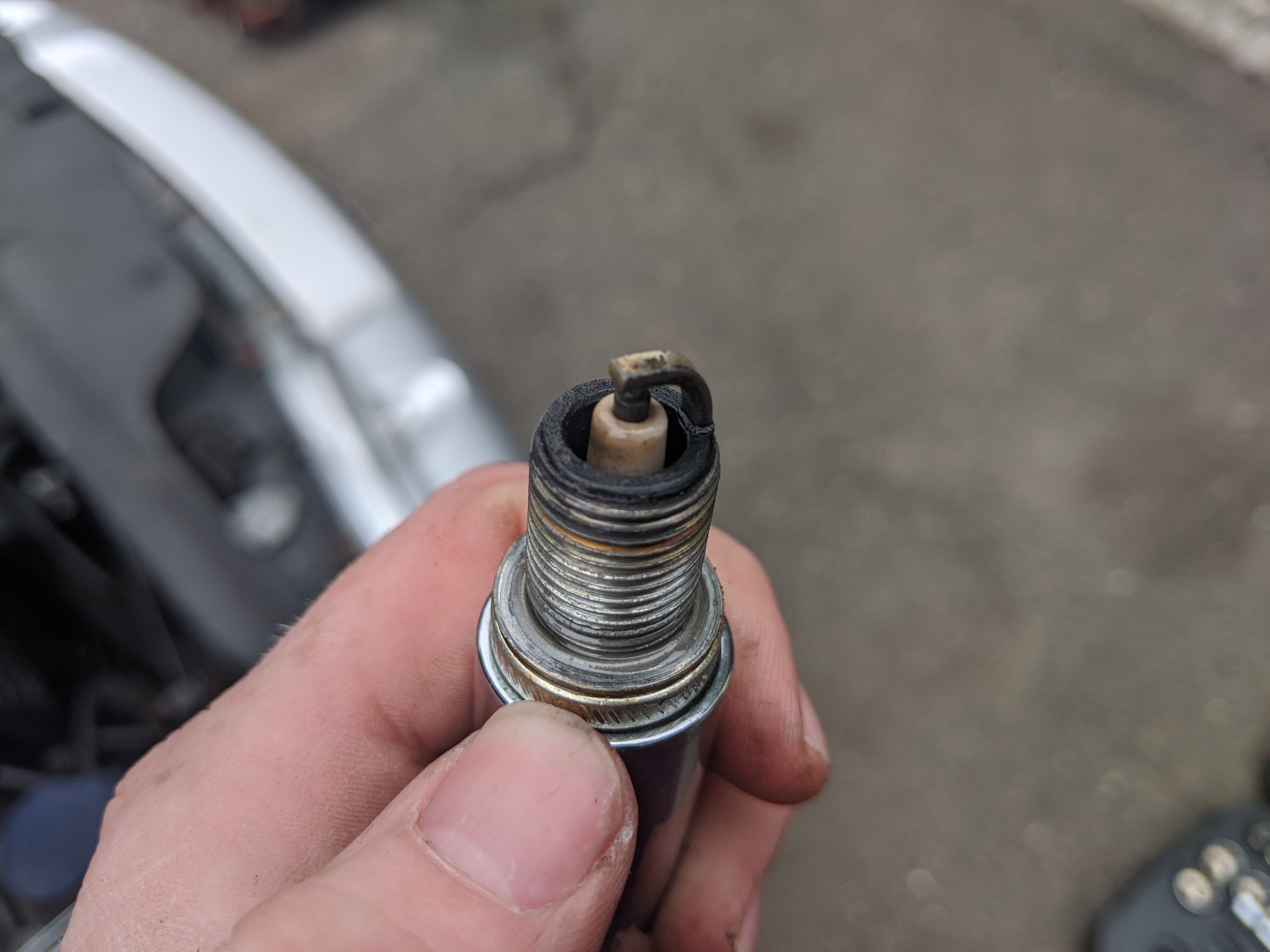

This is spark plug 3 which was giving the code. I swapped it with plug 2 (looked about the same) and the engine still ran rough. I then swapped the coil packs 2 and 3 and still running rough. Now it's giving me p0300 (seems to be multiple misfires).
My suspicion at that point was the coil pack (originally 3rd cylinder, now on the 2nd cylinder). I then went and pulled the fuel injector wiring on each cylinder, one by one starting the car and testing the idle in-between. The car seemed to run best with the injector wiring #2 pulled, so I think the culprit is the ignition coil pack. However, since both sparkplugs I checked seemed to me to be a hit carbon fouled, could it be a larger air/file mixture issue? Input is greatly appreciated!
My plan is to replace one or all of the coil packs (Bosch from FCP) and Put in a new set of spark plugs (Volvo, from FCP). The sparkplugs are 4 months old but they're 'double-platinum' from AutoZone, so I figure I'll just put Volvo in to be done with it.
Ps. These photos are both of the 3rd spark plug, but I checked cylinder 2 and it looked to be about the same.
