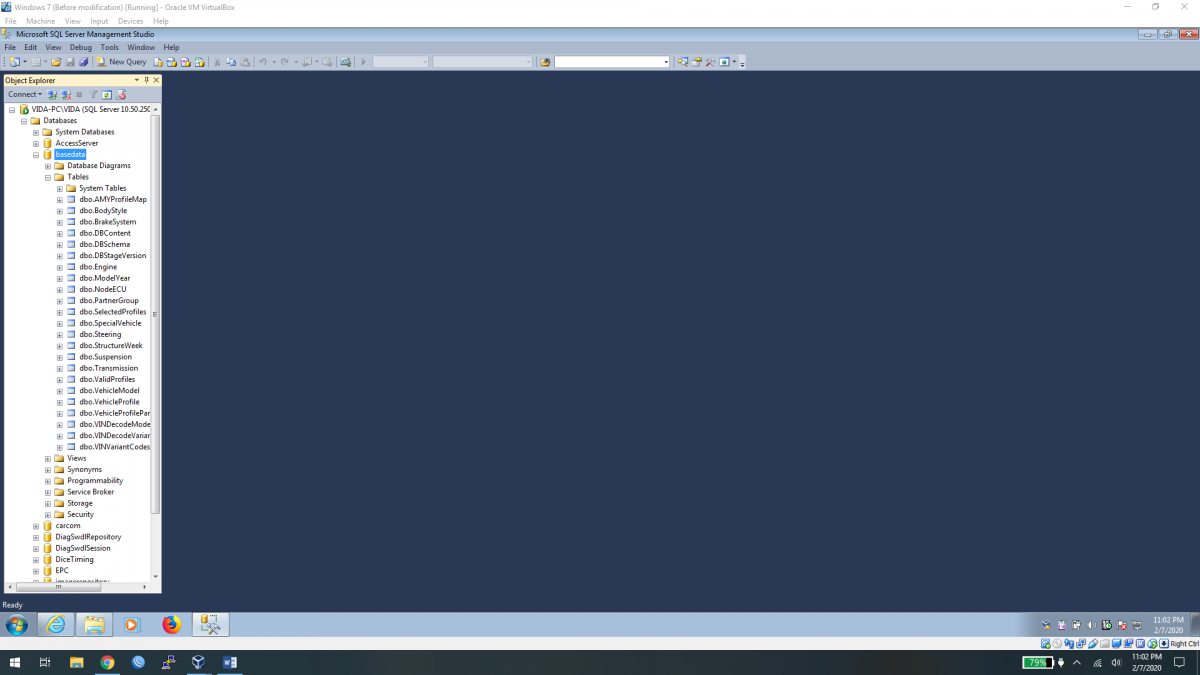

  2. Open the SQL Server Management Studio and open the “basedata” database

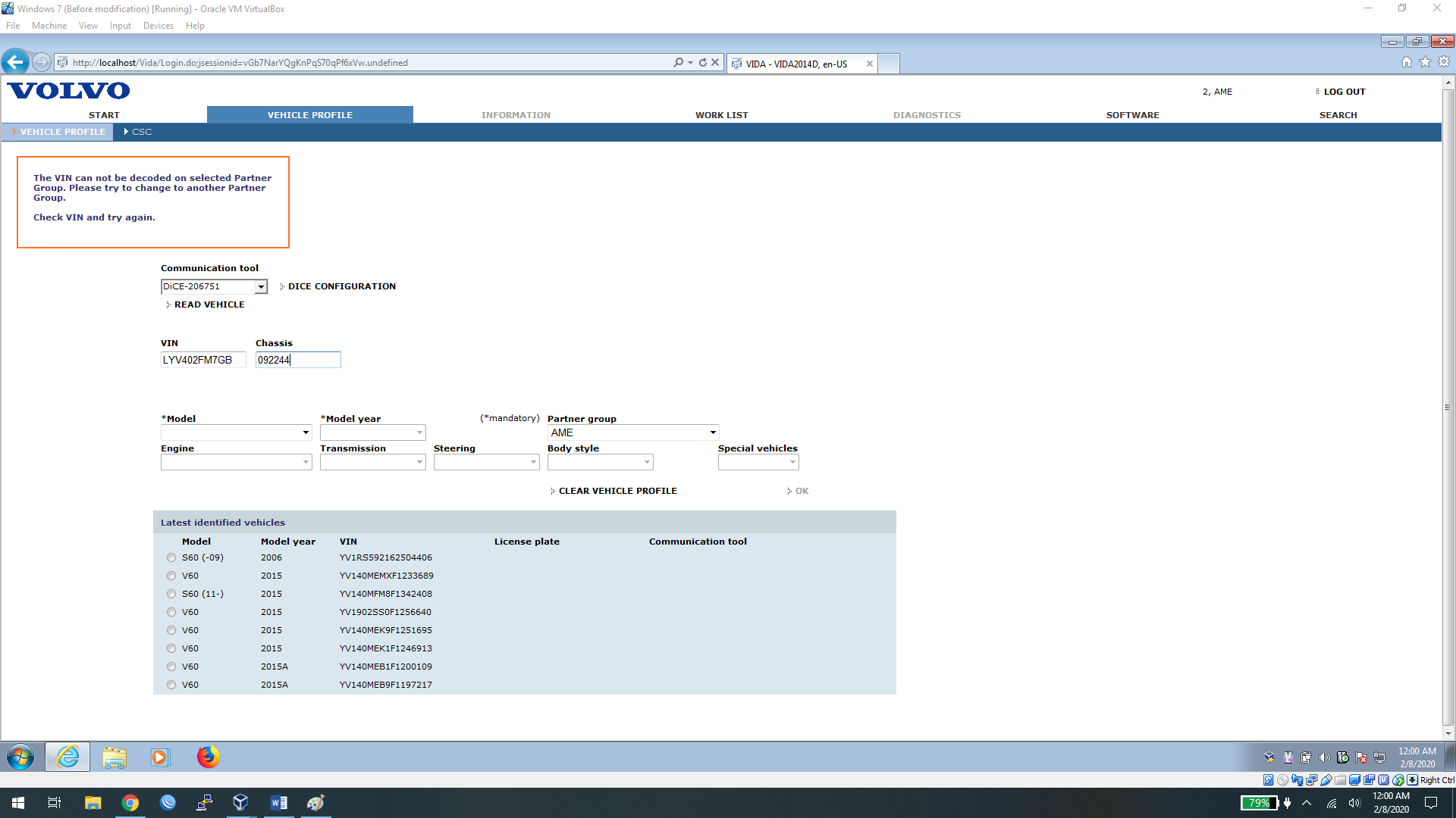

    1. Note that the VIN: LYV402FM7GB092244 in not accepted by VIDA. We will modify the database to recognize this VIN.

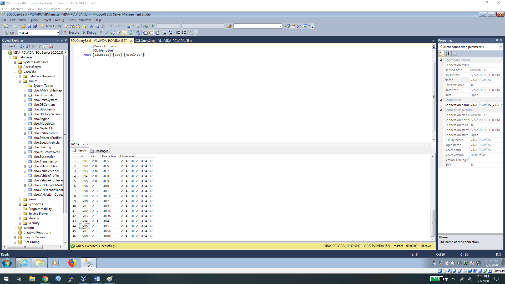

  4. We will tell VIDA that this VIN is a part of 2015 model year. First we have to find ID of 2015 model year in “dbo.ModelYear”. Right click on dbo.ModelYear and select “Select Top 1000 Rows”. 2015 model year has ID “1205”.

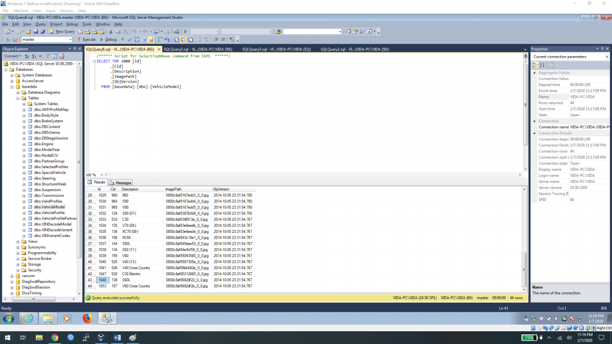

  5. Similarly list “dbo.VehicleModel” and find the ID of your car. S60 has the ID 1038.

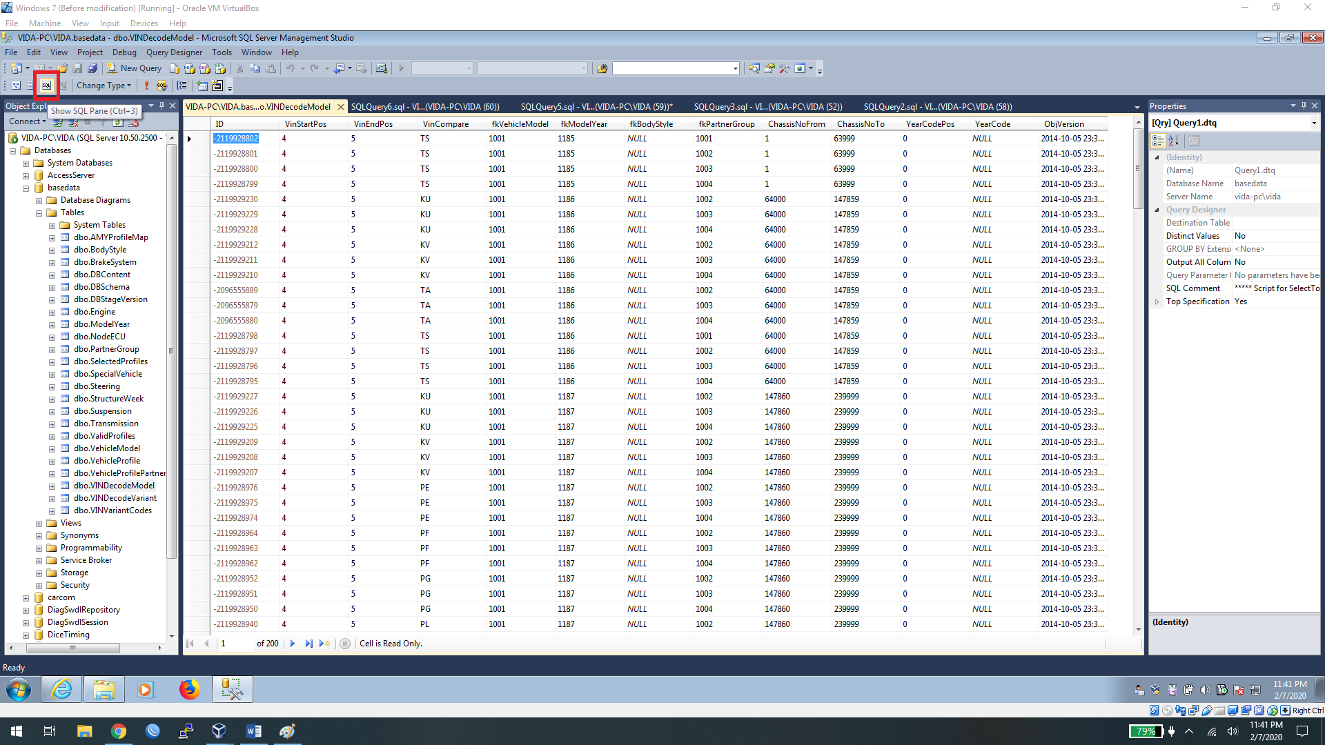

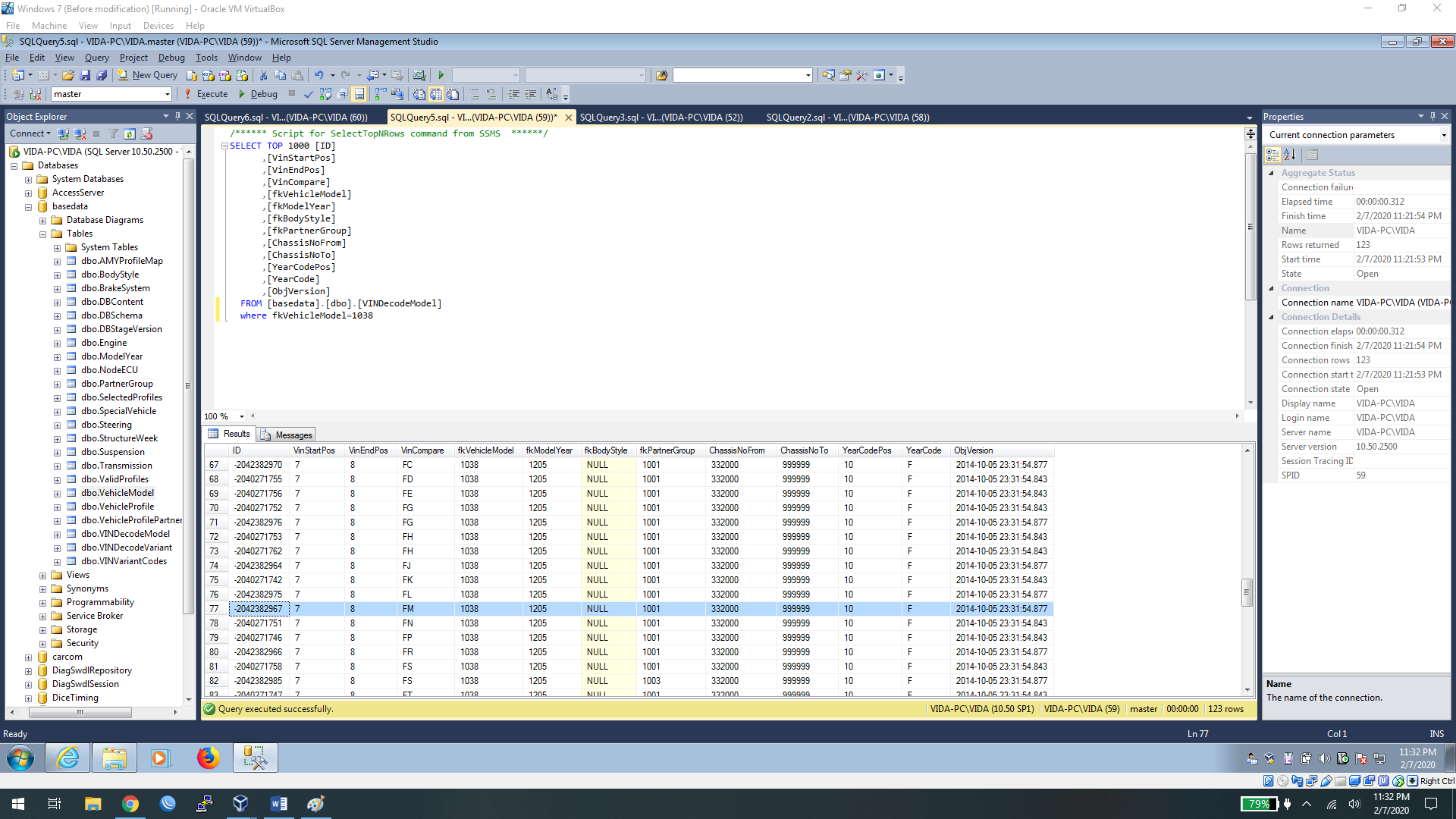

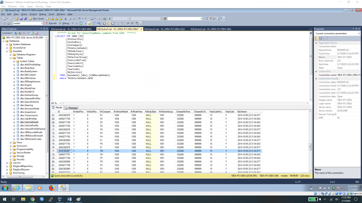

  6. Similarly list “dbo.VINDecodemodel”. This table is used to determine the model and year of a car based on your VIN. We will have to locate a similar car (understand VIN comparisons) that fails ONLY because of the year code in the VIN. We will modify a record that matches our car in everything but the YearCode field.
    1. Modify the SELECT statement to add a filter on your vehicle model by adding “where fkVehicleModel=1038” at the end of the statement. Click F5 to apply this filter.
    2. Scroll through the fields until you find your ModelYear (in the fkModelYear column). Now you have to compare your VIN. Read the data in VinCompare column. This string has to match your car’s VIN between the VinStartPos and VinEndPos positions. Below you can see that the highlighted row matches my VIN since FM is at 7th and 8th position in the VIN.
    3. Looking at the rest of the row, the ChassisNoFrom and ChassisNoTo (chassis number from and to) doesn’t contain our car. The chassis number (last 6 digits, 092244 in our case) is lower than 332000.
    4. The YearCodePos tells you the position of the year code in the VIN. The highlighted row doesn’t correspond to our car because our 10th digit is “G”.

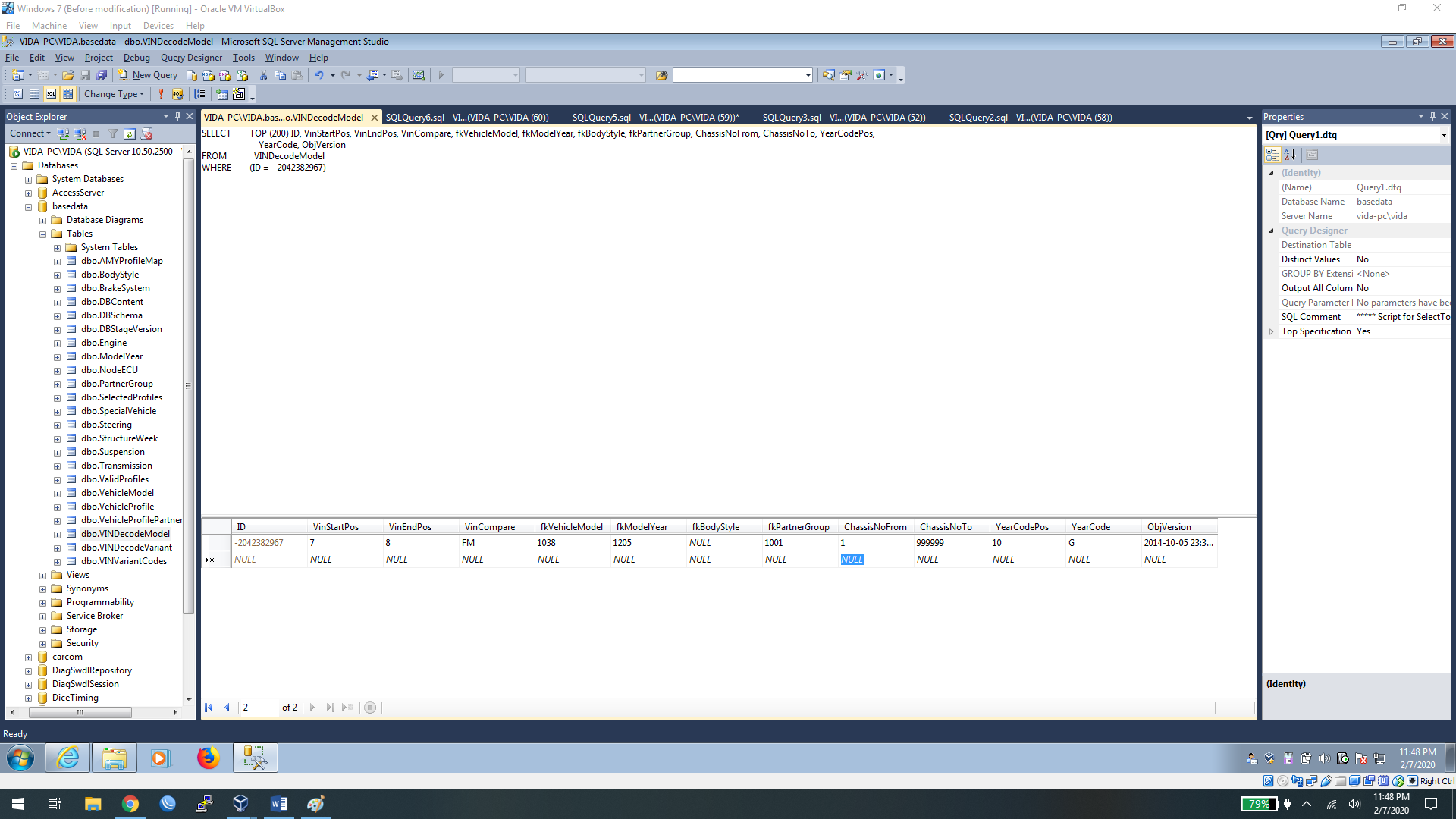

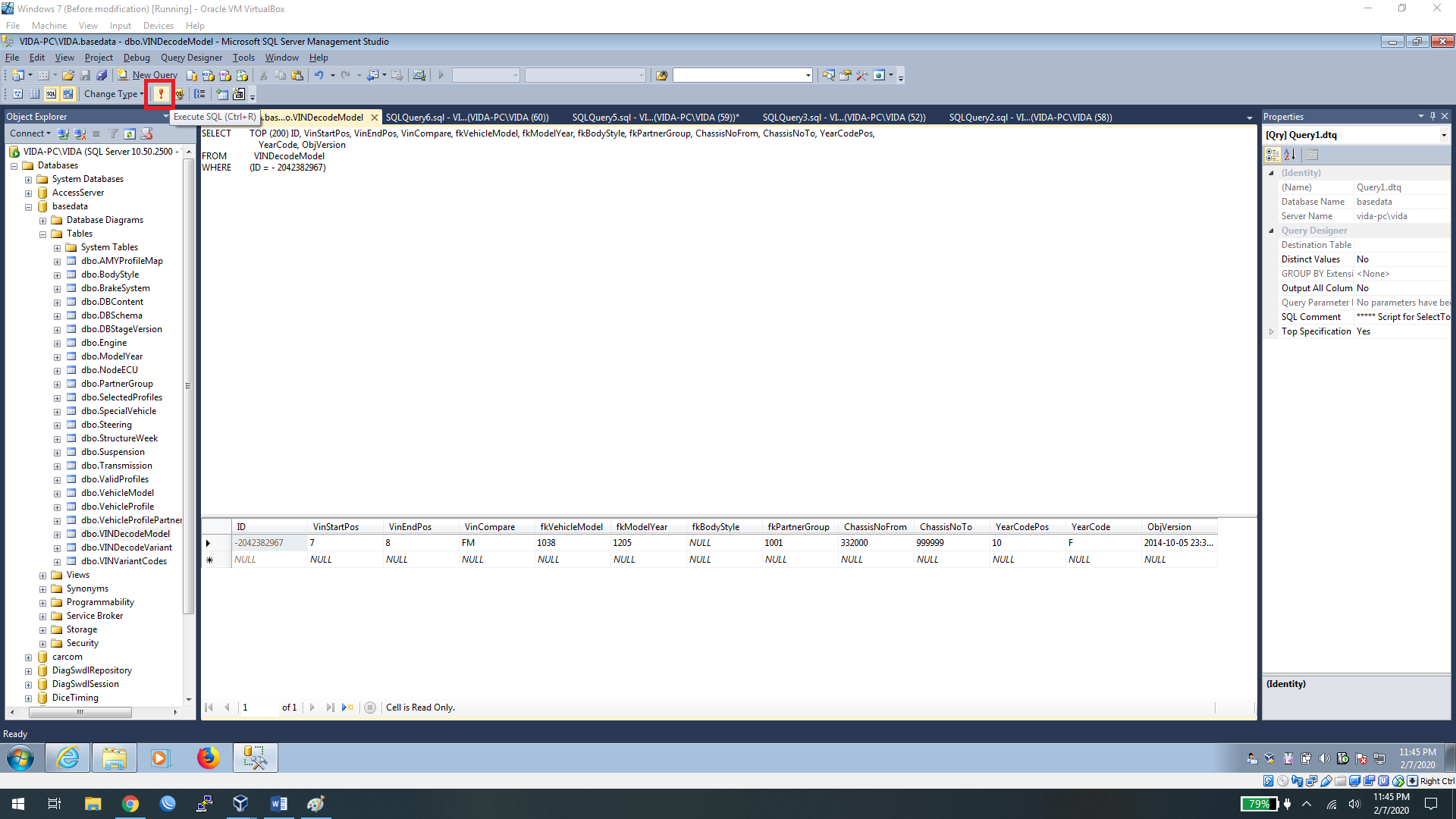

  7. We now modify this row to match our VIN. We will lower the ChassisNoFrom to include 092244 and change the YearCode. Fortunately, I don’t need VIDA to read 2015 cars so I’m going to modify this row. It might be the case that VIDA will stop reading 2015 S60 cars because of this modification. The row ID is -2042382967 (from the picture the first number in the row)

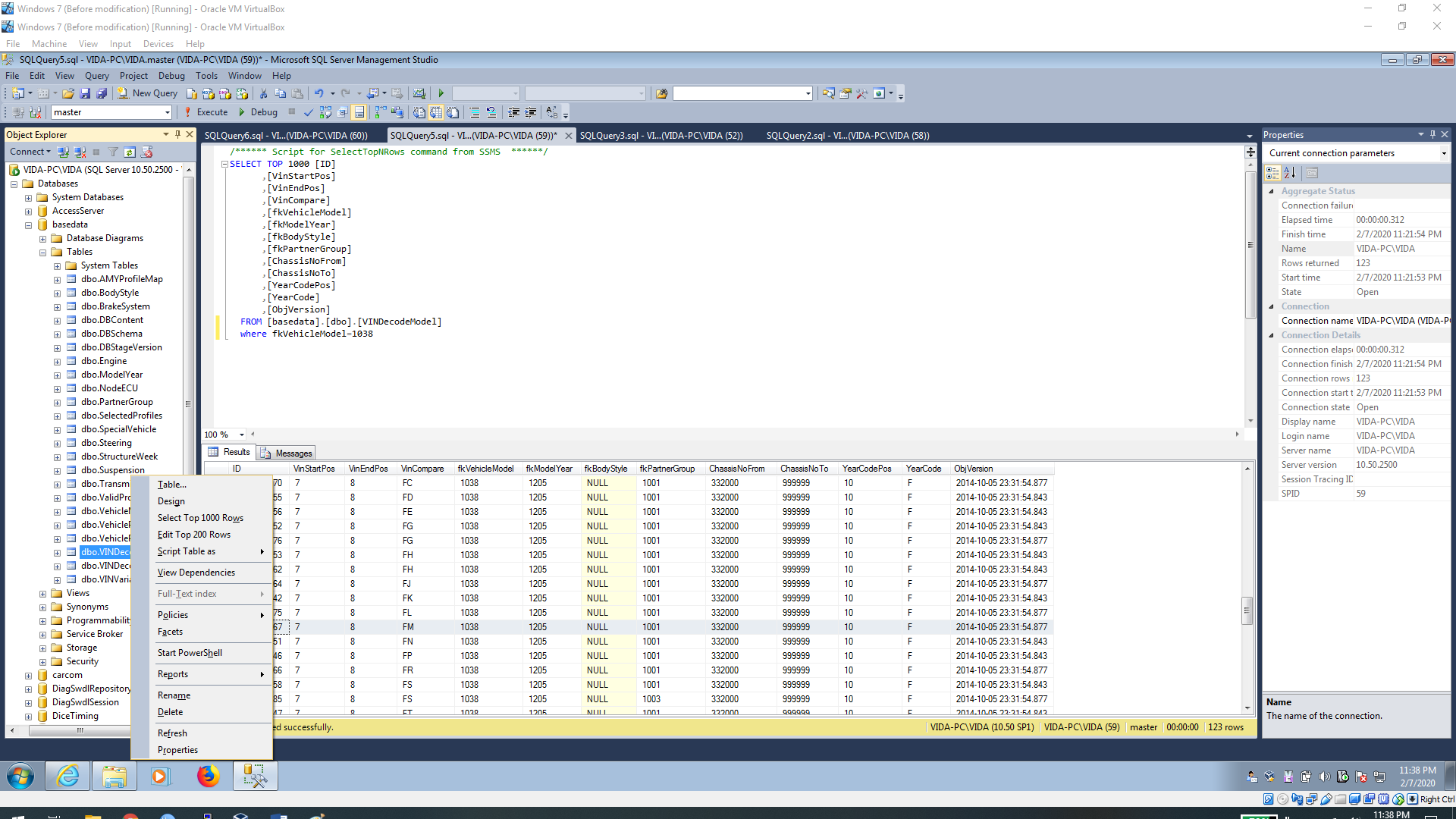

    1. Right click on dbo.VINDecodeModel and select “Edit Top 200 Rows”
    2. We need to add a filter to show only the one particular row. Click on Show SQL Pane button (in red box)
    3. Add “WHERE ID = -2042382967” and execute the statement by Ctrl+R or by hitting this button:
    4. Edit the fields as mentioned before.
    5. Click on the next row for the changes to save. The red exclamation marks should disappear.

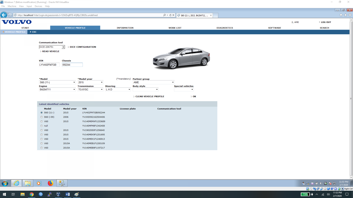

    6. Restart your computer (or restart SQL server and VIDA), enter your VIN.

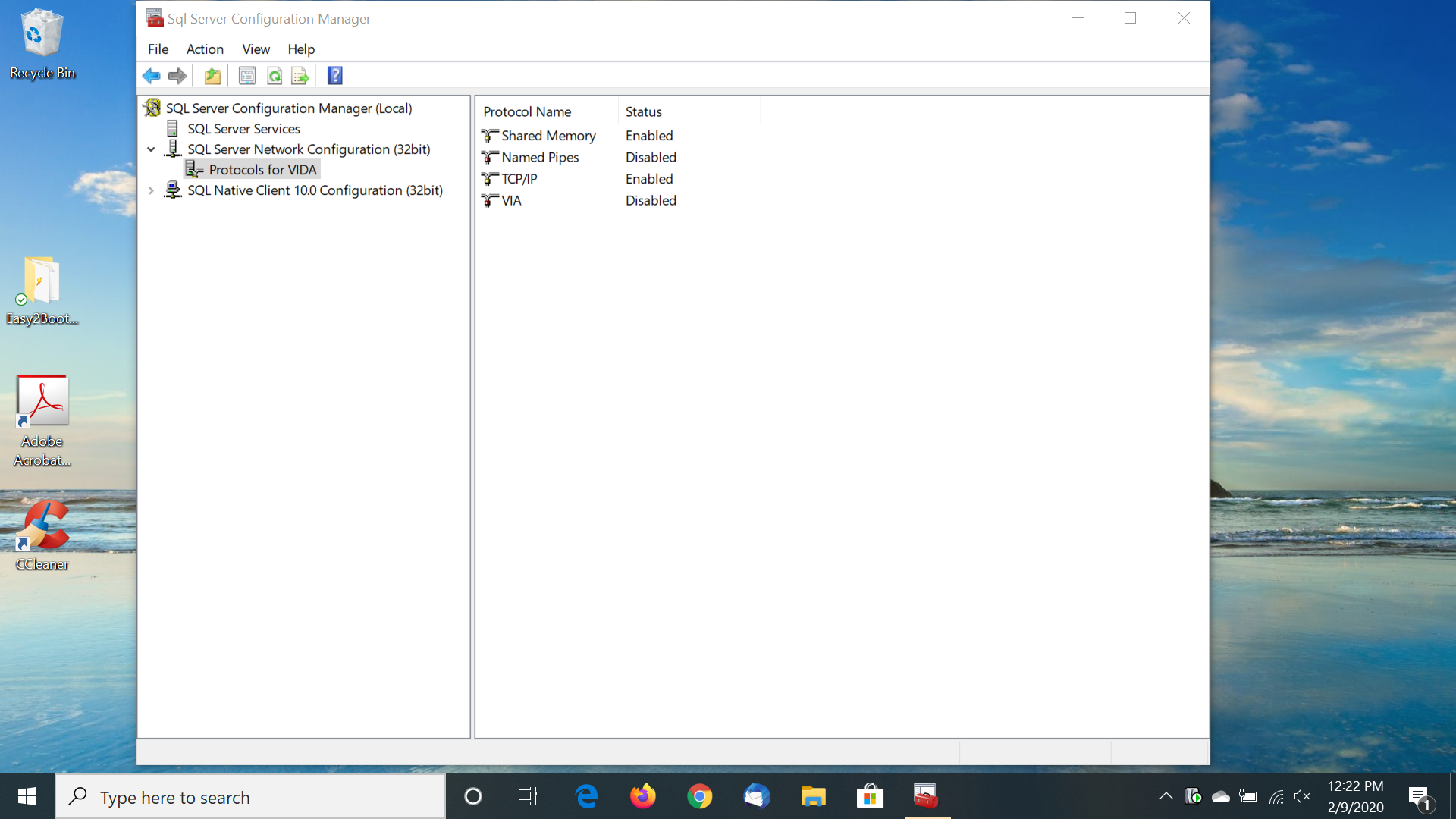

I think I found part of the problem. I installed SQL Server 2014 64 bit. Vida is 32 bit.
I rolled back the SQL Server 2014 64 bit install. Vida is working again.
Perhaps I should use the SQL Server 2014 32 bit to upgrade from 2008 to 2014 ...
My OS is Windows 10 64 bit.

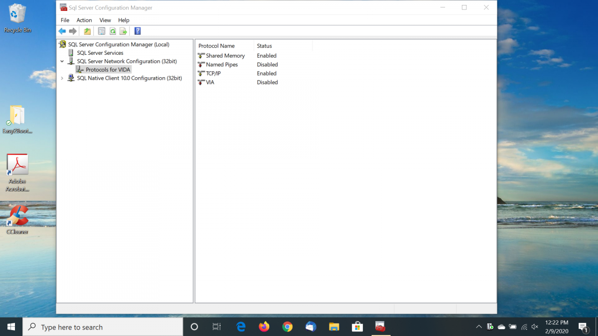

No need to install SQL Server. This might interfere with VIDA. You want to install Management studio that will let you connect to VIDA's SQL server.
This is what can be used for Windows 10: https://docs.microsoft.com/en-us/sql/ss ... rver-ver15
Once you open it you should see something that looks like the screen below. The default settings should let you connect to VIDA. Do NOT use the settings you can see on the picture - this is if you have VIDA in virtual machine...
