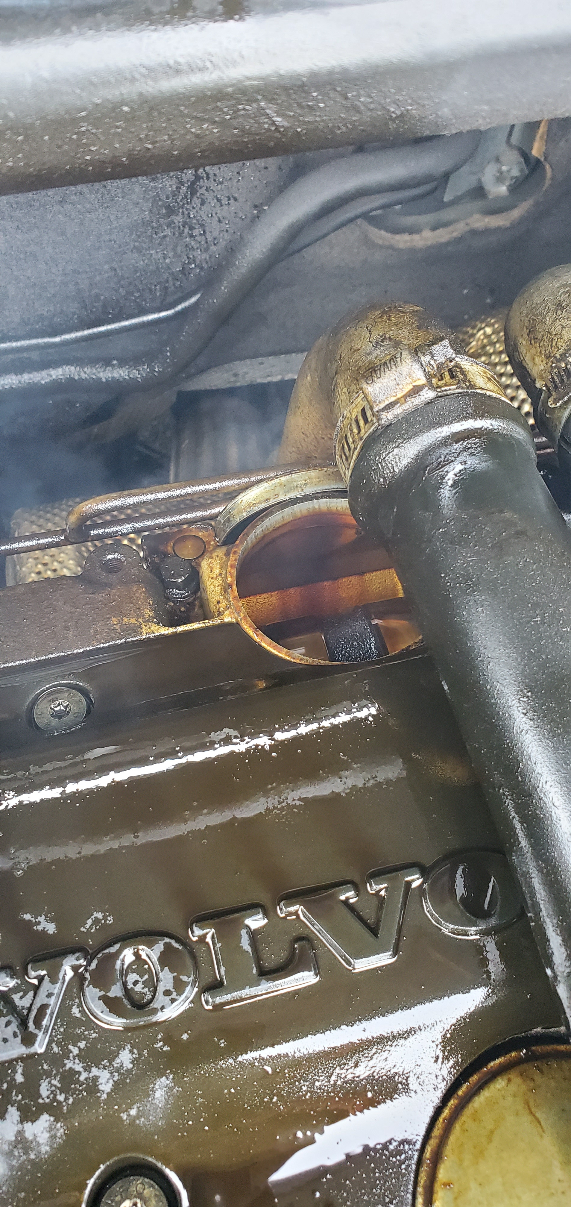

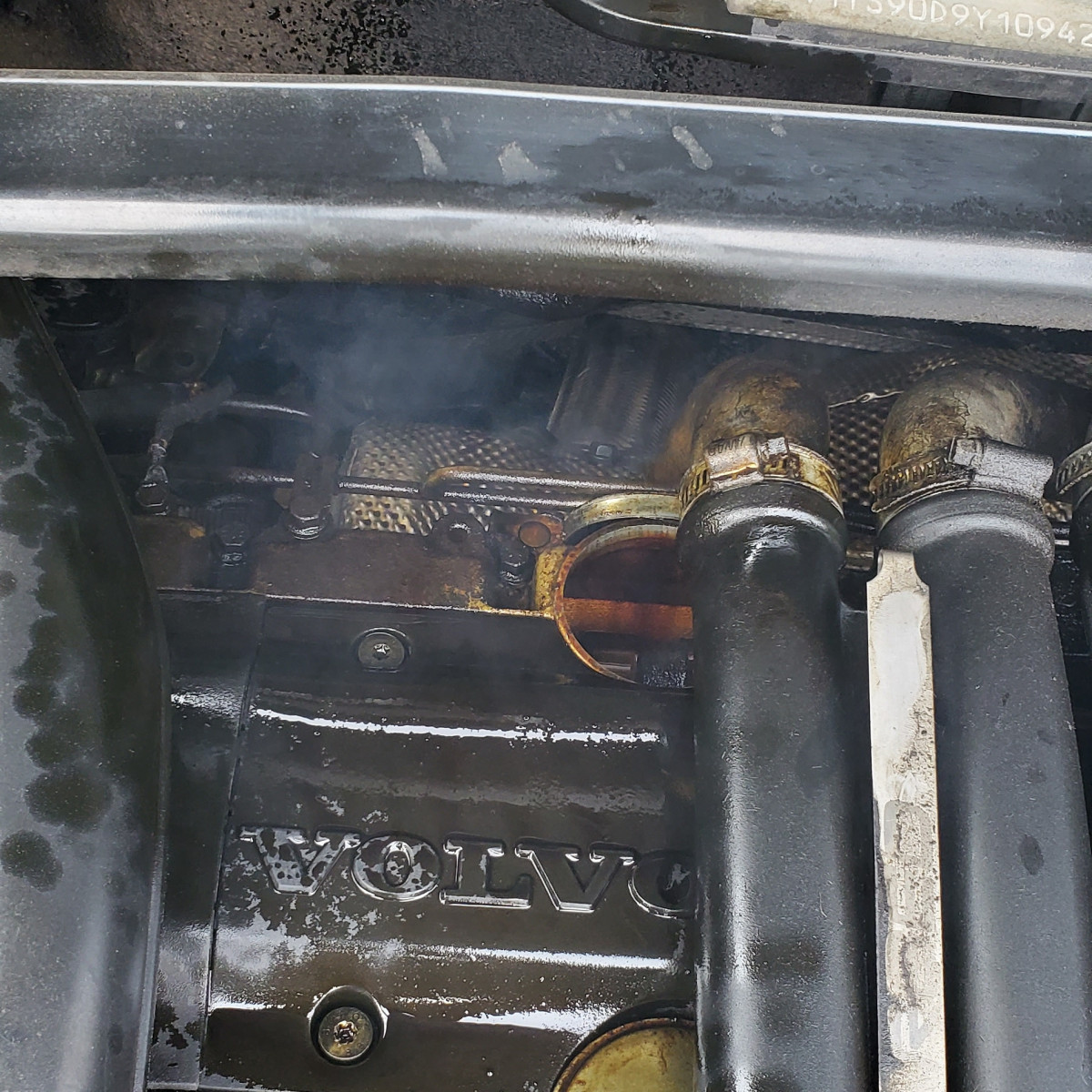

I turned off the engine and lifted the hood to find that this cap (pictured below) was blown out of its hole and there was oil EVERYWHERE. I checked my oil and added about 2 quarts.

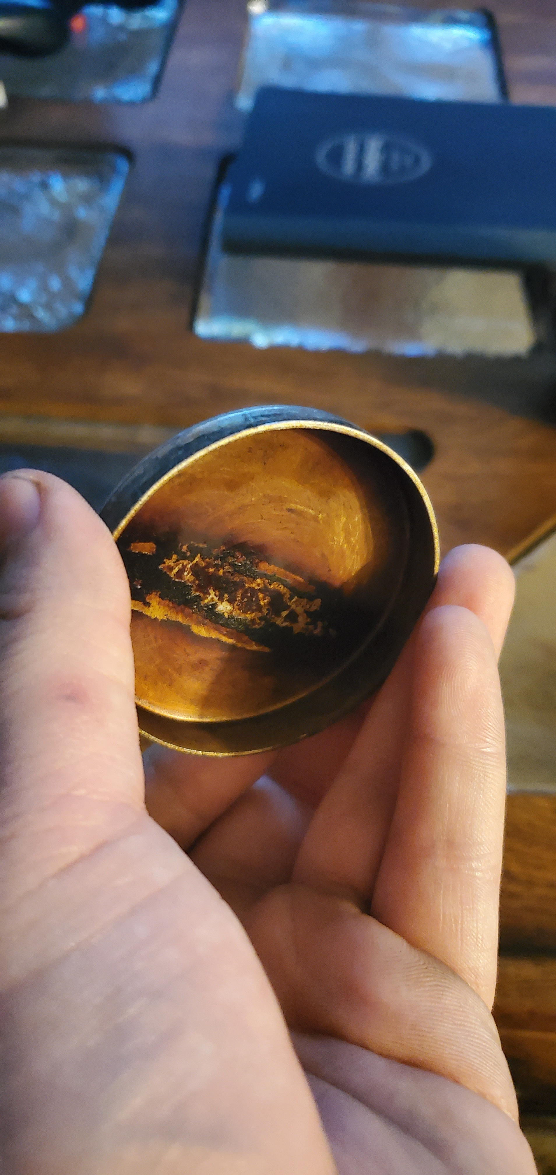

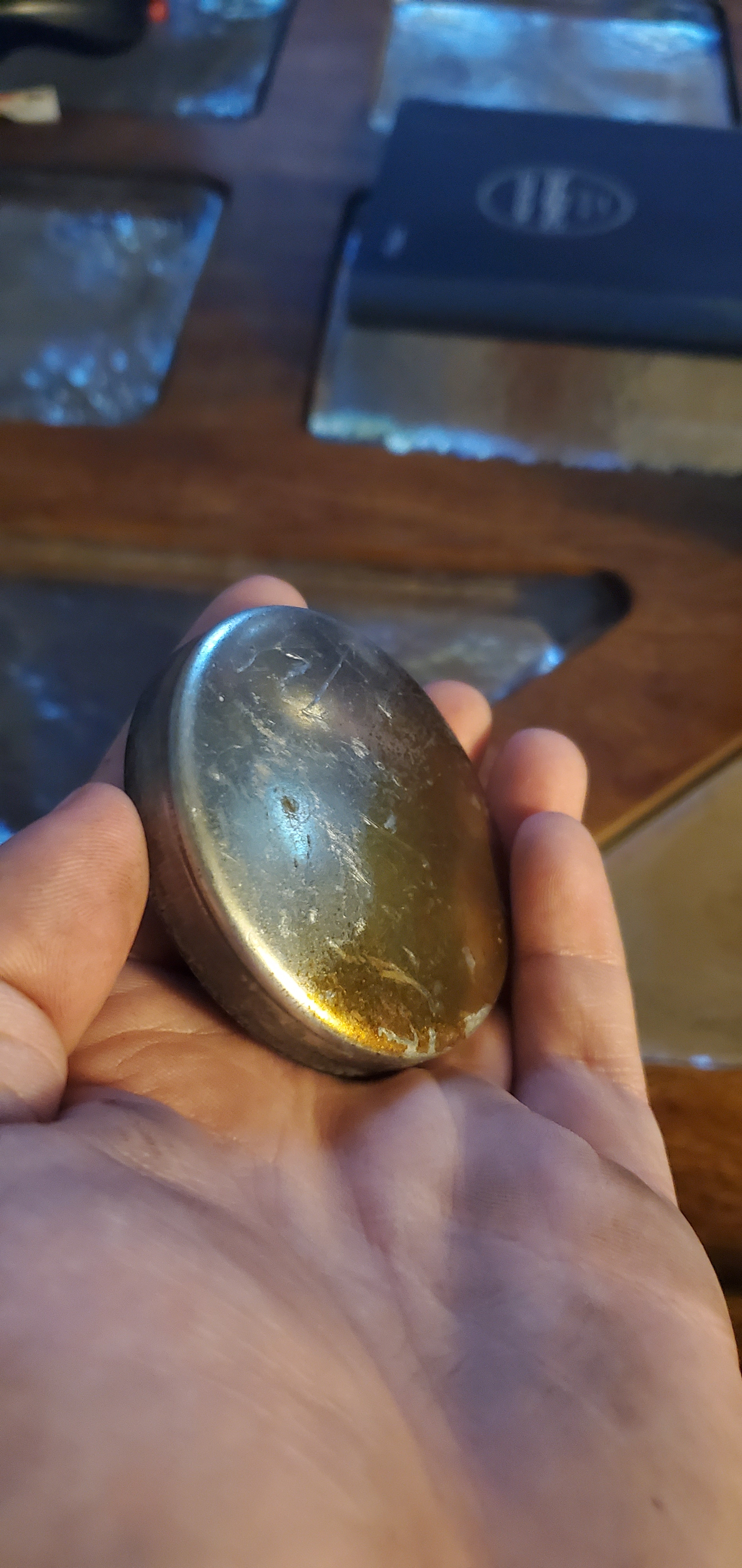

I've been looking everywhere for what this cap is called but I cant find anywhere that can clearly define it. I've seen it called a valve cover, a cam cover, and freeze cap. I just want to know what I need to order in order to fix this thing.
My assumption is that the newly fixed turbo air pressure created a lot of buildup and blew it off.
Also, if I buy a new piece wont the pressure just blow the new one off as well?

Cool - never seen that before. I would start as follows:
1) Check your connections to the turbo boost sensor - are we talking about the one that is on the intercooler - down low, looking at the windshield, on the right? I would expect you to get some overboost errors if you have problems with the boost.
2) Check your PCV system, I suspect this is where your problem is.
As to the cap - for the interim I would clean it up and tap it back in. If you want to go for a long term fix with your current part, clean the cap and the valve cover really well. Don't use a Scotch-Brite on the valve cover as the green filaments ruin engines. You can do it to the cap and then rinse well with water. Once all is clean and dry, apply a thin seal of anaerobic sealant on the inside of the valve cover and on the sides of the cap for good measure. Then tap it home and leave it over night. Should hold and seal.

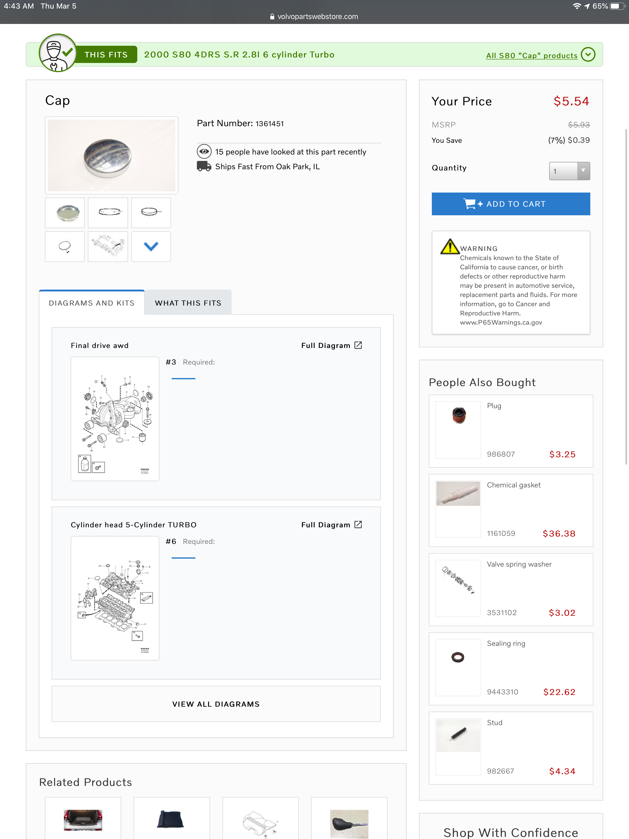

- Posts: 36142
The sealer needed is going to cost more than the cap, but both will still be cheaper than the oil you lost!
From the Volvo web store site...
Volvo trivia ...the same cap is used on the AWD assembly
