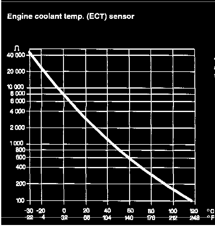

Temperature chart here for the ECT
viewtopic.php?f=35&t=57678&start=20#p427305

ebbie wrote: 13 Feb 2020, 10:23 I checked with a multimeter the ect sensor's contact and it read 4.22 ohm set at 20k Ohm. The car was off and the temperature was maybe 10C. I have no clue if that's any help?
4.22 Ω or 4.22 KΩ?
Is that is sensor only or sensor + wiring?
Engine temperature sensor:
Temperature : °C (°F) / Resistance : Ω
0 °C (32 °F) / 7300 Ω
20 °C (68 °F) / 2800 Ω
40 °C (104 °F) / 1200 Ω
80 °C (176 °F) / 300 Ω
100 °C (212 °F) / 150 Ω

The wire coming out of the sensor. I disconnected it and checked the ohm at the contact to the sensor, where the picture shows.
I had my multimeter set to 20K, so if I understood it right (after googling) my reading of 4.22 makes it 4220 ohms? The temperature was around 10C, and according to that chart abscate linked to, my resistance is too high? Almost double that it should be.. How important is the voltage reading? And checking it at various temperatures?

Abscate's chart is for a 1999. The ones I posted are for a 1995. For a 1995 4220 Ω @ 10 °C is correct.
What is the resistance across the wiring harness when it is disconnected from the sensor?
A lot of things changed in 1999 ....
