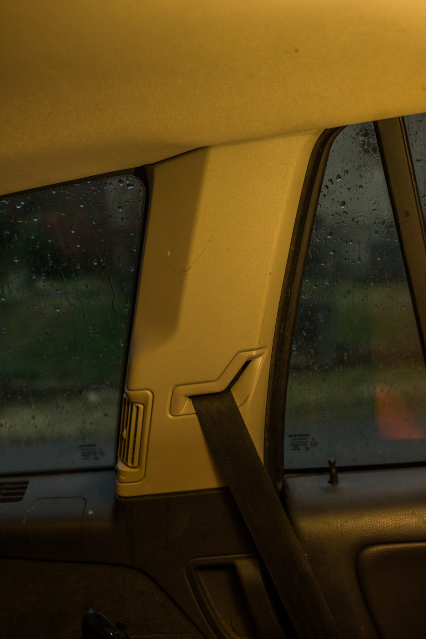

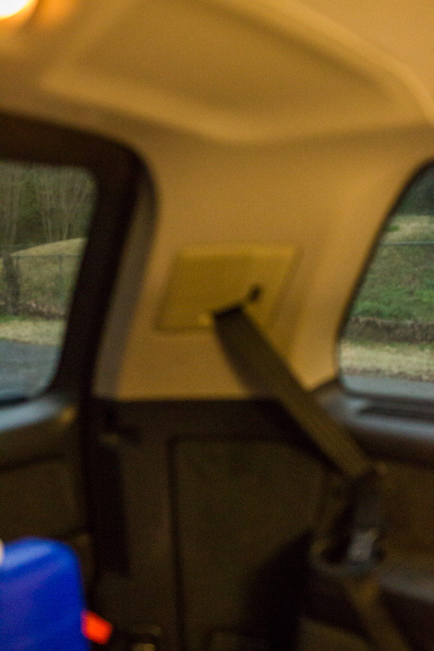

I have a 2007 XC90 that's been enduring some heavy rains while parked slightly uphill. Sunroof is closed, but plenty of rain is coming in and leaking through the 3rd row shoulder seat belt slit and collecting in the battery tray/cover. When I open the sunroof and pour water in, it freely flows through both seatbelt slits.
I'm finding little to no info online about this issue for the XC90 (In fact, I can't even confirm that the rear drains even exist!), plenty of owners seem to have problems with the front drains clogging. I've checked my front tubes and they are operating fine.
I realize there must be a clogged rear drain in there somewhere, but can't figure out how to access it. Can someone enlighten me on how to remove the covers for the C/D pillars (see pics - forgot to focus one, but you get the idea) and/or the center rear hatch section? Or even what these panels are called by volvo? Maybe I can replace the sunroof seal...or seal it shut permanently?
