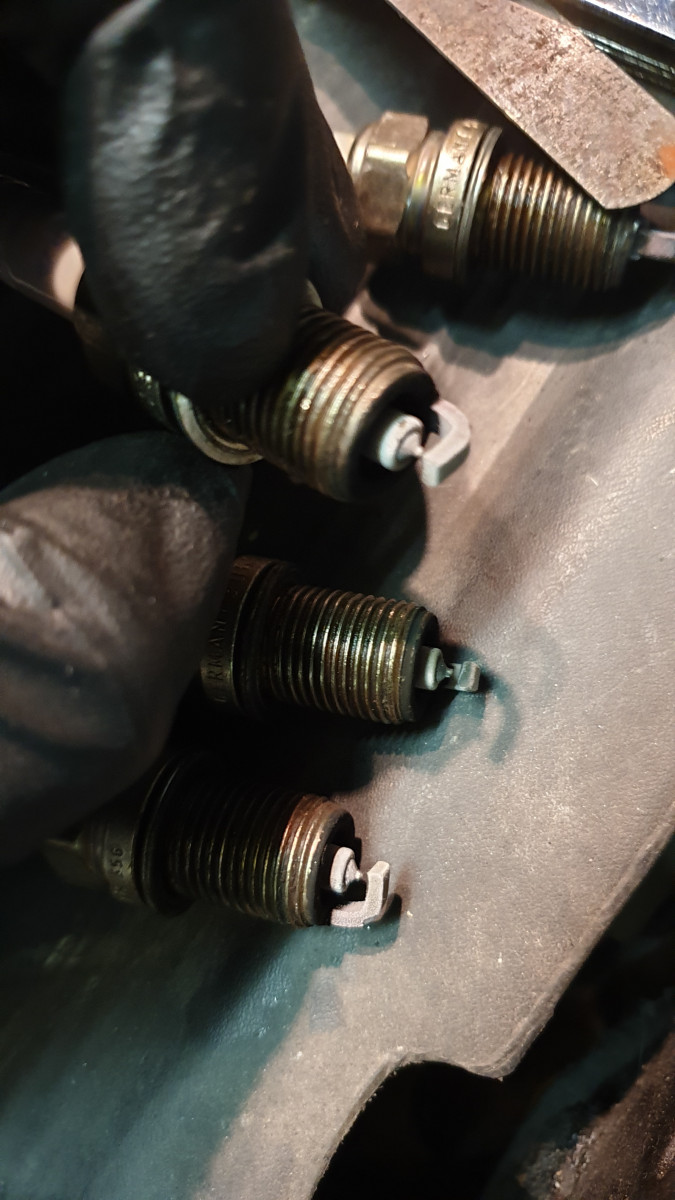

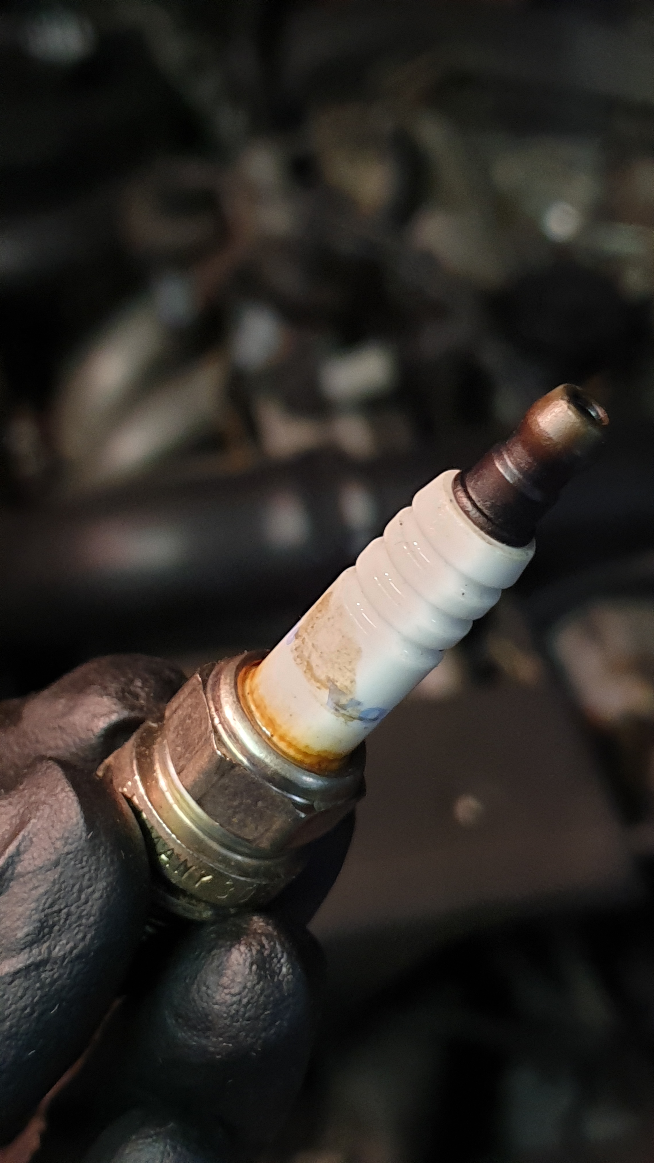

Now I switched the plugs.
The ones out the 94T5 were a little on the darkish side, maybe carbon buildup. The ones out of the teoublesome 96 were whitish. Photo attached. One of them was a tad brownish around the shaft, maybe oil that got down the upper part of the plug when refilling oil?
Let's see how it runs tomorrow, because the cutouts at idle only happen when it is warm and in D (not in N).

- misha
- Posts: 5437
- Joined: 07 Dec 2008, 16:09
- Location: Serbia
- Has thanked: 155 times
- Been thanked: 432 times
Thats not from oil....i guess it is from the heat.
Whiteish look is ok....good combustion sign.
'94 T5 could run a bit rich or driven on short distances and that's why they are darker.
