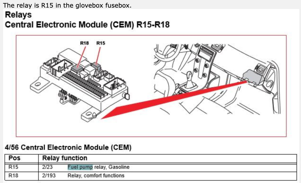

davhaney wrote: 02 Mar 2020, 21:49 Following up: I cleaned all chassis ground connections, then disassembled and tested the fuel pump relay. The contacts were tarnished/burned - I cleaned them and re-assembled. The car regained fuel pressure and started.
I suspect the failing fuel pump caused excessive current or maybe arcing across the pump relay. Hence swapping the relay before replacing the fuel pump didn't help. This is my working theory anyway.
I have since replaced the tainted relay - no need to tempt fate here. Hopefully these notes will be of use to someone in the future.
Dave, I am currently experiencing same issues. Can you direct me to this relay, where is it exactly. Thanks Russ
Richard99
Posts: 168
Joined: 22 May 2018
Year and Model: 2000 V70XC
Location: San Francisco
Has thanked: 26 times
Been thanked: 22 times
Post by Richard99 »
Razzda wrote: 09 Feb 2024, 01:06
The relay is on the CEM underneath the glovebox. It's pretty easy to pull out. There are videos on how to remove the CEM.
Screenshot 2024-03-04 at 6.01.45 PM.png (499.21 KiB) Viewed 4987 times
