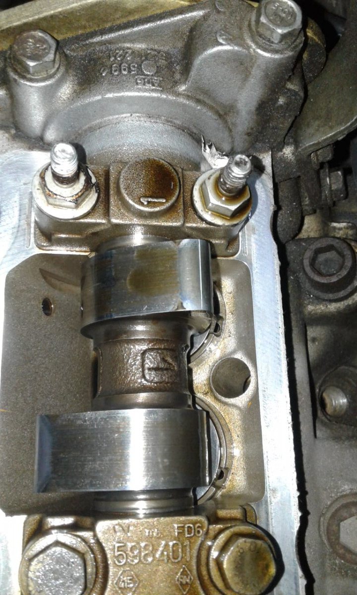

Interesting that #1 cylinder is near to the tranny and not towards the timing belt. Read about it, and confirmed it on the camshaft. See photo.
