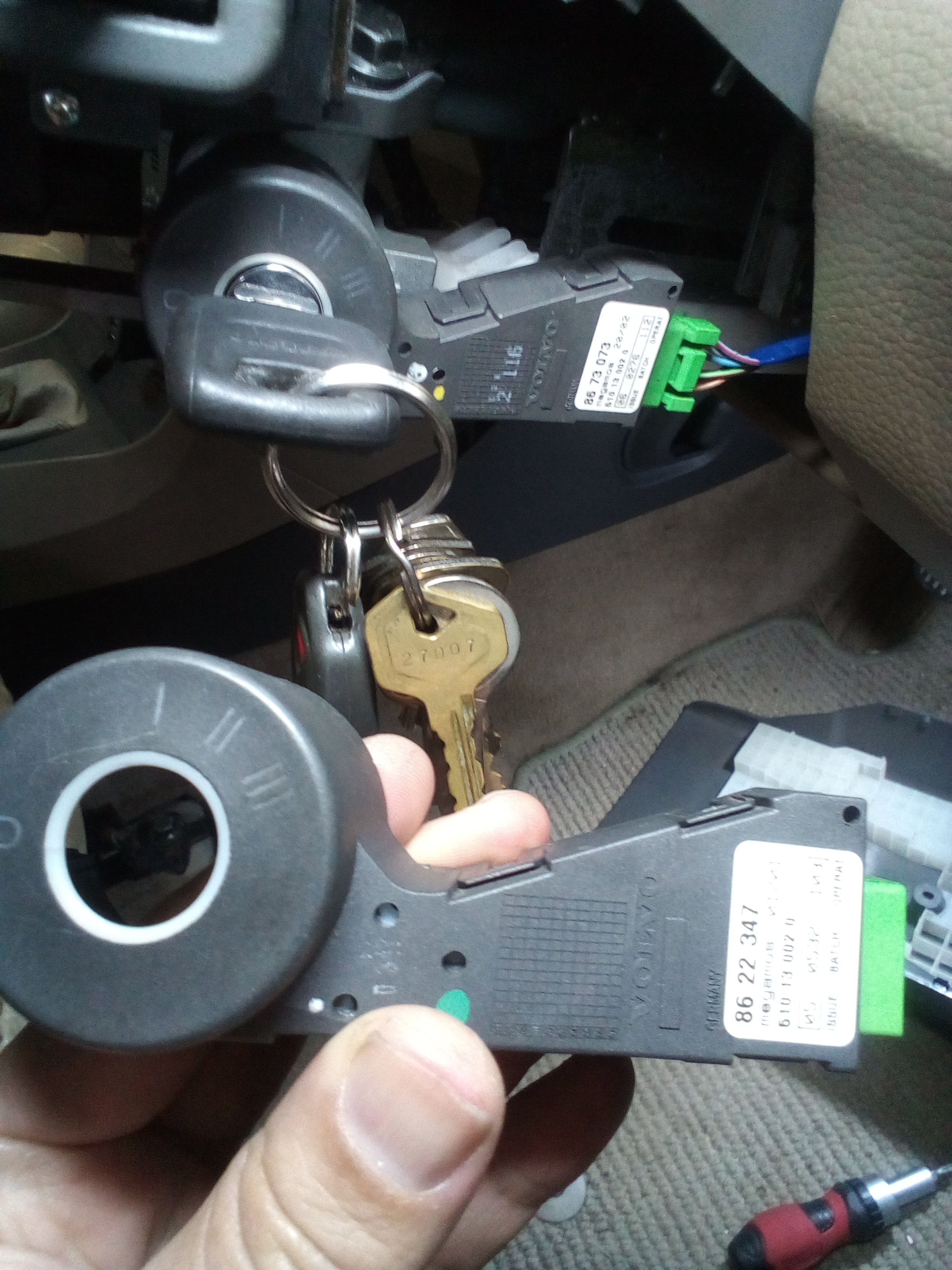

Ive been chasing a hard starting issue on my 2001 v70xc since i purchased it 4 years ago. happens during summer on 30c (think thats about 75-80F) days car starts normal after overnight but after getting to running temp then stope for 10mins it will sometimes crank but not start, always starts after 3 attemps. No codes. When it does start i can drive to a safe place like home and start it numerous times normally but leave it for 20mins and it can often hard start again but not always.
Have got the 'start prevented try again' message once so i switched out the receiver module (pic) hopefully this is the problem. I swapped out a spare ignition key module thinking it wouldnt work but its not as sensitive as my original module and whats strange i can unplug it and the car still starts.
