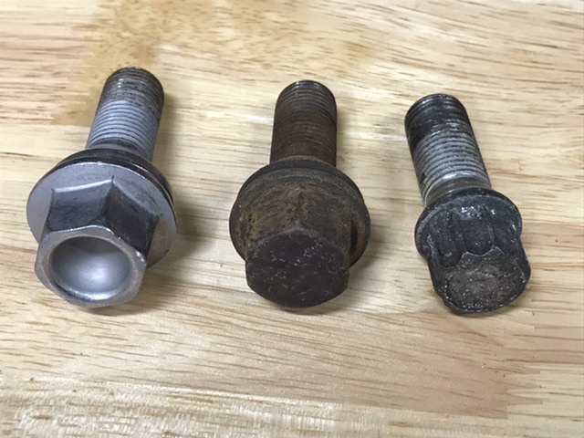

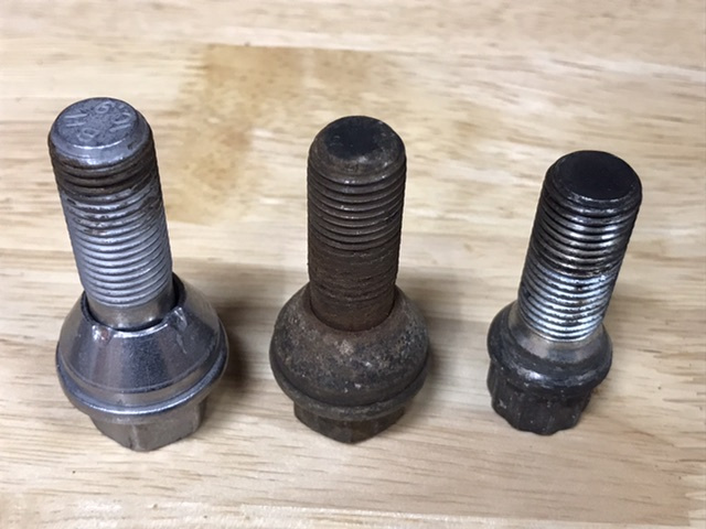

Get the Febi bolts. $60 = no brainer. They aren’t an exact replica of the Volvo bolts but they are incredibly lovely! German made also. I have a picture somewhere of them on one of our cars.
How did your pocket get sticky?
Edit: I meant to say, I would avoid any 1-piece lug bolts. I’ll post a photo later.

One of our P2’s, well before we bought it, Discount tire convinced the previous owner it would be a good idea to replace the lug bolts with their 10-point bolts. Kinda scary. The one-piece bolts chatter, squeak and pop as you tighten them. Impossible to get an accurate torque on them.
Anyhow, I went Febi since it costs about the same to get 20 used Volvo lug bolts.

- Pete - wrote: 07 Mar 2020, 10:29 How did your pocket get sticky?
Meant to be a music thing, but can be interpretted differently i guess.
In the side by side picture - is that febi bolt, old volvo bolt, 10-point bolt?
2004 S60 2.5T AWD
- Pete -
Posts: 970
Joined: 06 Dec 2013, 22:13
Year and Model: 01, 04, 04, 04 V70's
Location: Minnesota/Wisconsin
Has thanked: 81 times
Been thanked: 178 times
Post by - Pete - »
Yes.

- Pete - wrote: 07 Mar 2020, 10:29 Edit: I meant to say, I would avoid any 1-piece lug bolts. I’ll post a photo later.
Absolutely, if you have alloy rims. Steel rims should take the one piece bolts. I keep a set of one-piece, fixed cone ones in the trunk for use with the spare wheel.
