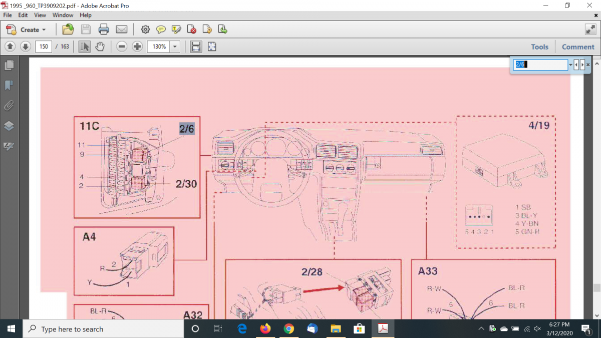

Radio fuses 11A/2, 11C/9, 11C/17 & 11C/15.
The second overload relay 2/30.
11A/X under hood. 11C/X end of dash driver's side.
2/6 & 2/30 are the overload relays.
