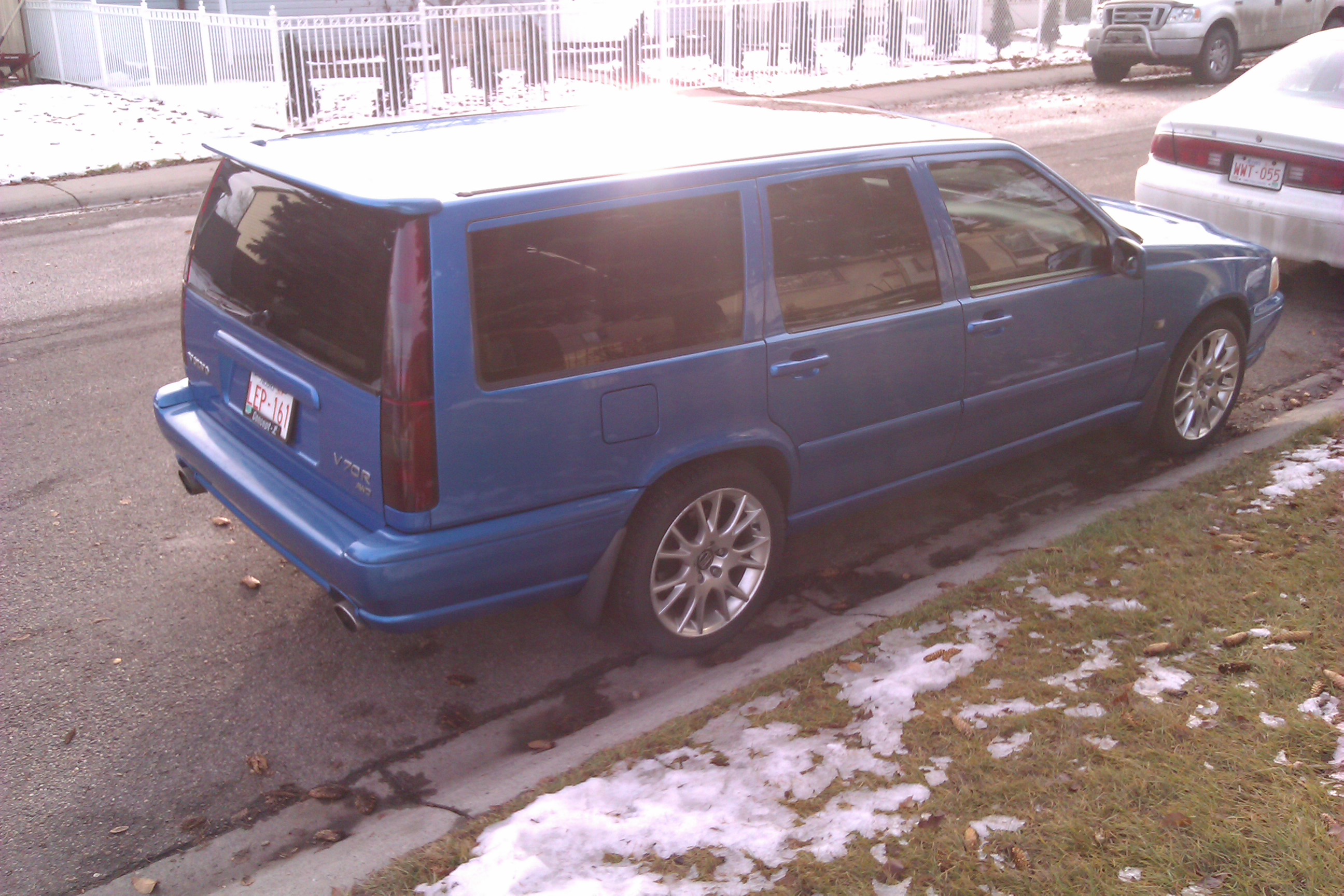

Post by scot850 »
I am running 17" rims on my 2000 V70R AWD. Tires can be either 215/45/17 as you mention, but I am using 225/45/17 on my car.
The issue you have to watch on the AWD models is the offset. I have a set of THOR wheels for winters and I can't recall what the summers are on but there are 2 that are very similar lattice style and can't recall now what they are.
The offset I have is 49mm. For my car I have no issues with the front, but at full extension on the rear (like when on axle stands) when the suspension is fully extended it the inside of the rim binds on the rear sub-frame. For normal driving it is no issue.
Standard offset for P80 models is 43mm.

Post by scot850 »
My car is surrounded in snow and under a car cover for the winter, but here is a picture of when I bought it about 7 years ago. I have a different set of wheels that are similar looking from a S60 as these turned out to have 2 with dents in the inner edge of the rims causing balance issues.
I also have the Thor wheels from a V70 P2 model which are the ones under the cover for now.
17" Volvo wheels from an S60
Hope this helps,
