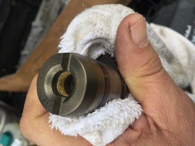

Engine had low compression. Rolled engine by hand to set "in time", used cam lock down tool (noticed notches in back side of cams NOT parallel to "head seam") Removed head. Sent to machine shop for valve job... When I get my head/cams/cam cover back... Cams lock tool is off cams, as well as "cam gears" without markings...😠😩...
My main question is, are the 2 cams identicle? The only different markings I found on the cams, was one is stamped (.3) the other is (.5). Also, what about the notches on the back side of the cams (where you install cam lock tool)? Why werent the notches parallel to "head seam"?

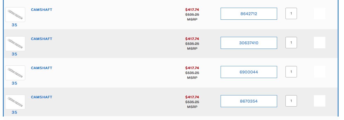

I have both cams out of a 1999 RN NA engine - if pictures would help I could send/post/send by pigeon.
Look closely for a paint swatch - red and blue. I think I know which is which but you should research to be sure.
Also, look real closely on the rear end for an I and E in punch marked dot matrix format
Added picture from volvo webstore
First one is exhaust cam part number
Next three are intake cam variants.

Added part numbers above. I think these are stenciled into the cam rear - but easy to miss
Can't tell you how wonderful those part numbers were!! Easily identifiable on "notch" side of cams where part numbers are located!
Thanks to all involved. This is solved!
