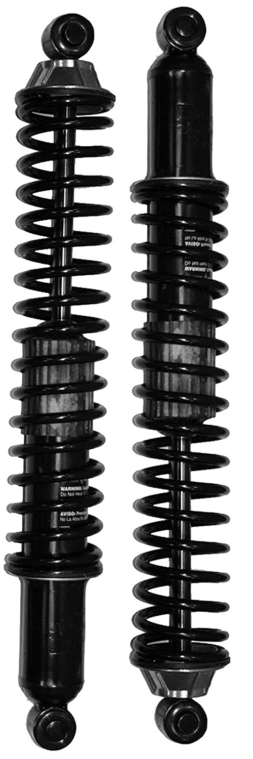

Back when I had a '75 245 Volvo, I got a shock catalog and checked all the dimensions for match to original Volvo rear shocks. I found a coil over shock of the same dimensions. These needed some extra washers to provide body clearance, but I used these for several years. Like you, I routinely carried heavy loads in the back.
- Posts: 6512
- Joined: 19 Jan 2014, 09:51
- Has thanked: 987 times
- Been thanked: 1078 times
Continuation of thoughts:
You may not want coil over shocks, but comparing dimensions may find a shock rated for heavier loads.

I think you mean helper spring shocks rather than coil overs as in adjustable ones on a McPherson Strut setup?volvolugnut wrote: 14 Mar 2020, 10:48 Back when I had a '75 245 Volvo, I got a shock catalog and checked all the dimensions for match to original Volvo rear shocks. I found a coil over shock of the same dimensions. These needed some extra washers to provide body clearance, but I used these for several years. Like you, I routinely carried heavy loads in the back.
I installed these on our 03 Odyssey over 7 years ago and they are great for maintaining height besides the extra load capacity. The turn in and neutral steer for corners and big off ramp sweepers increased dramatically. Always interesting to see (and don't see) the tailgater and their surprise following me too fast into a turn. Perhaps the OP can find something similar.
https://www.amazon.com/Monroe-58645-Adj ... da+Odyssey
