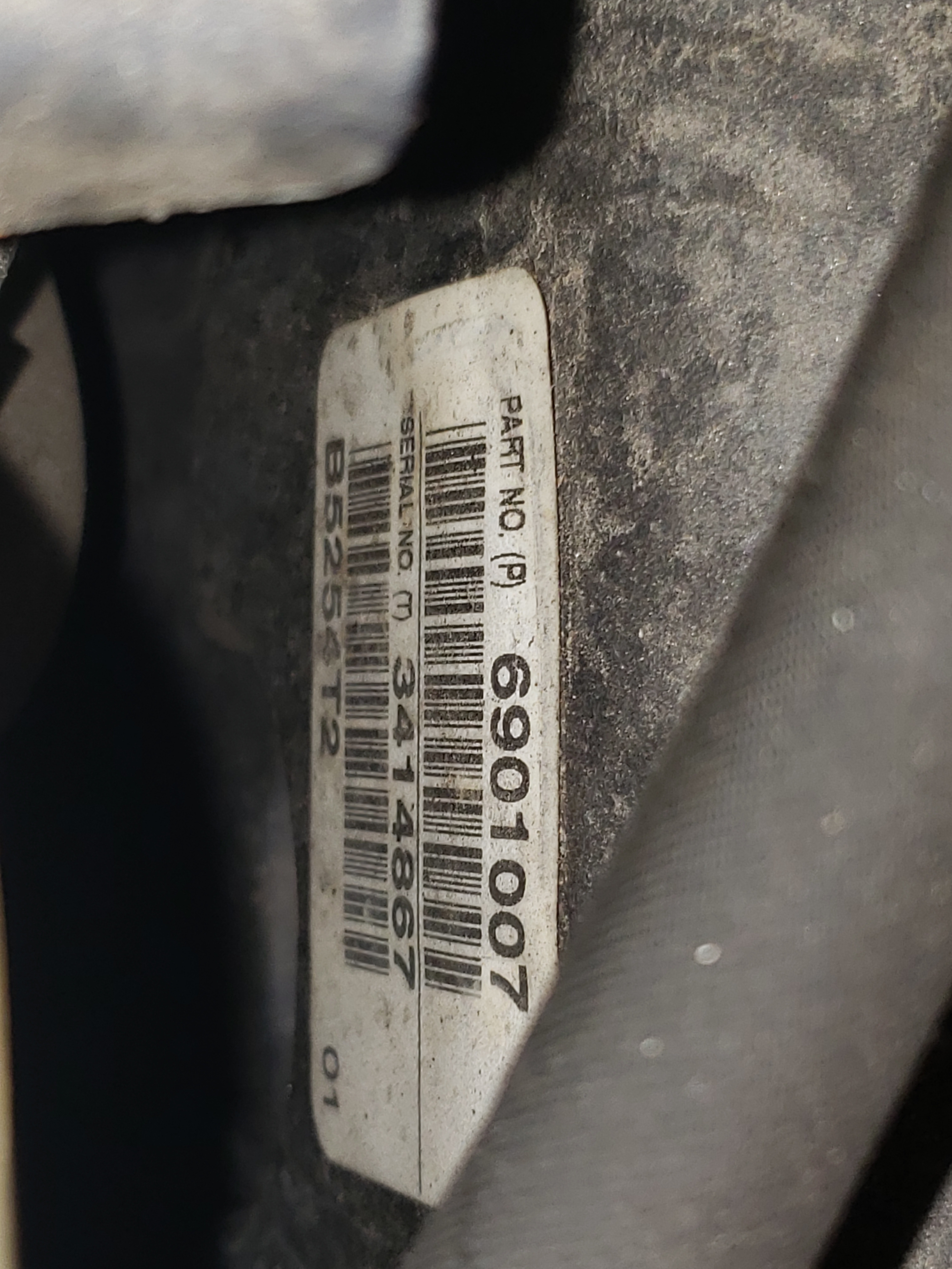

The kit on FCP (https://www.fcpeuro.com/products/volvo- ... it331a-oem) says it's only for "Up To Engine Serial Number -3188688", and when I click into the individual Tensioner part, it say's it doesn't fit my car, even though the Kit comes up in my car specific search!
Snapped a picture of my engine serial number on the timing belt cover: So I guess the tensioner I need is this one: https://www.fcpeuro.com/products/volvo- ... 30637955oe

Should I be replacing the drive belt tensioner too (included above)? Pete, you said I should just replace the drive belt tensioner pulley, but the tensioner itself is included in the FCP kit. Wondering if it's customary to replace both of these or just one (which one?)
