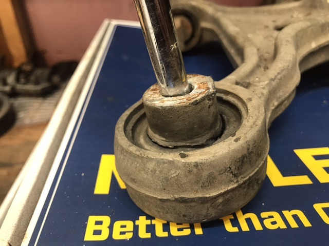

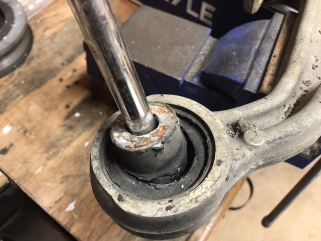

This is the second set from that unfortunate pile that I've changed out due to will-be-failing-soon type sounds at just over 10K miles of light use. This set was installed at 128,900 miles, clicking/binding sounds initially detected around 135,000 & quite noticeable by 140k when I changed them.

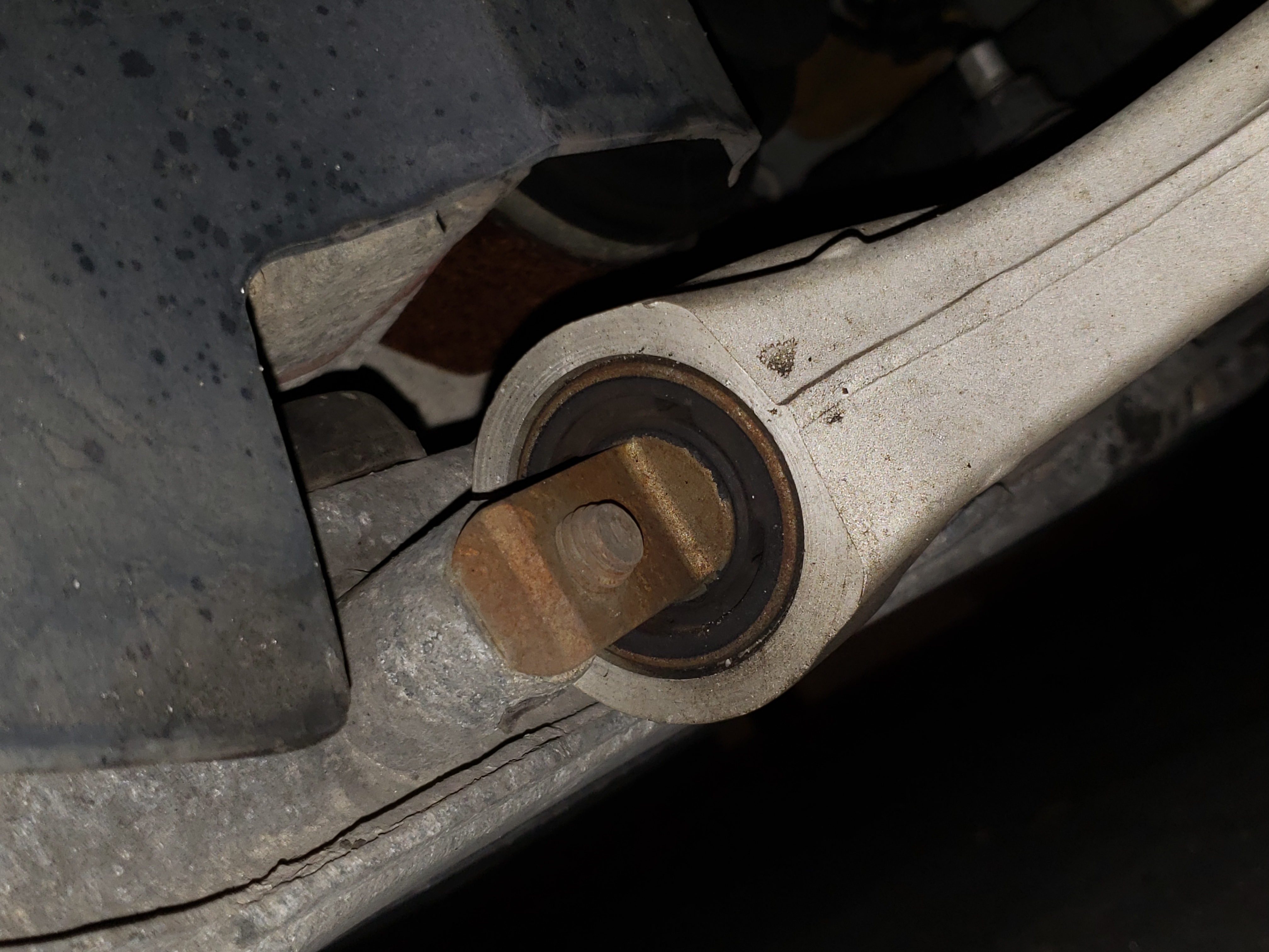

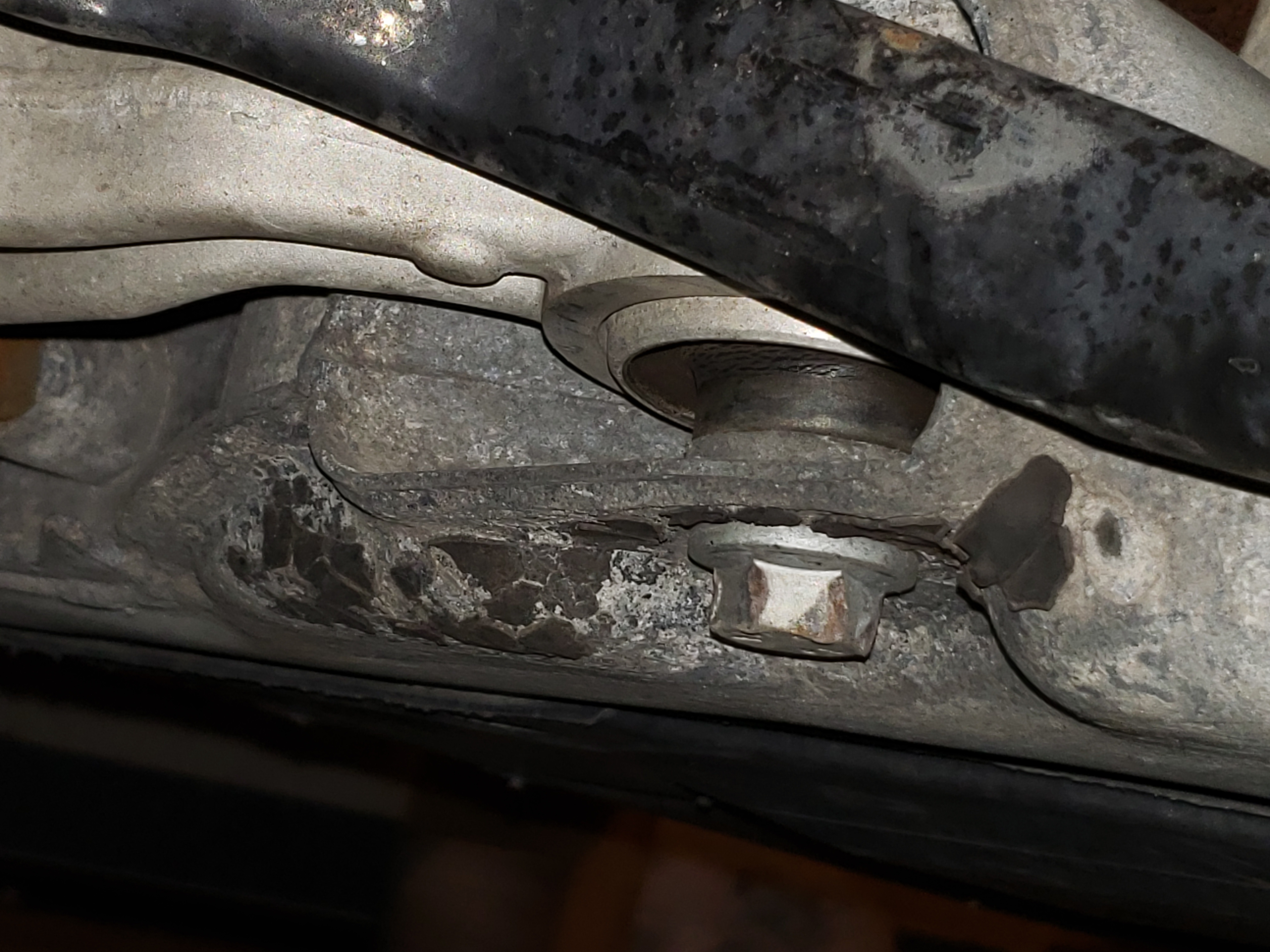

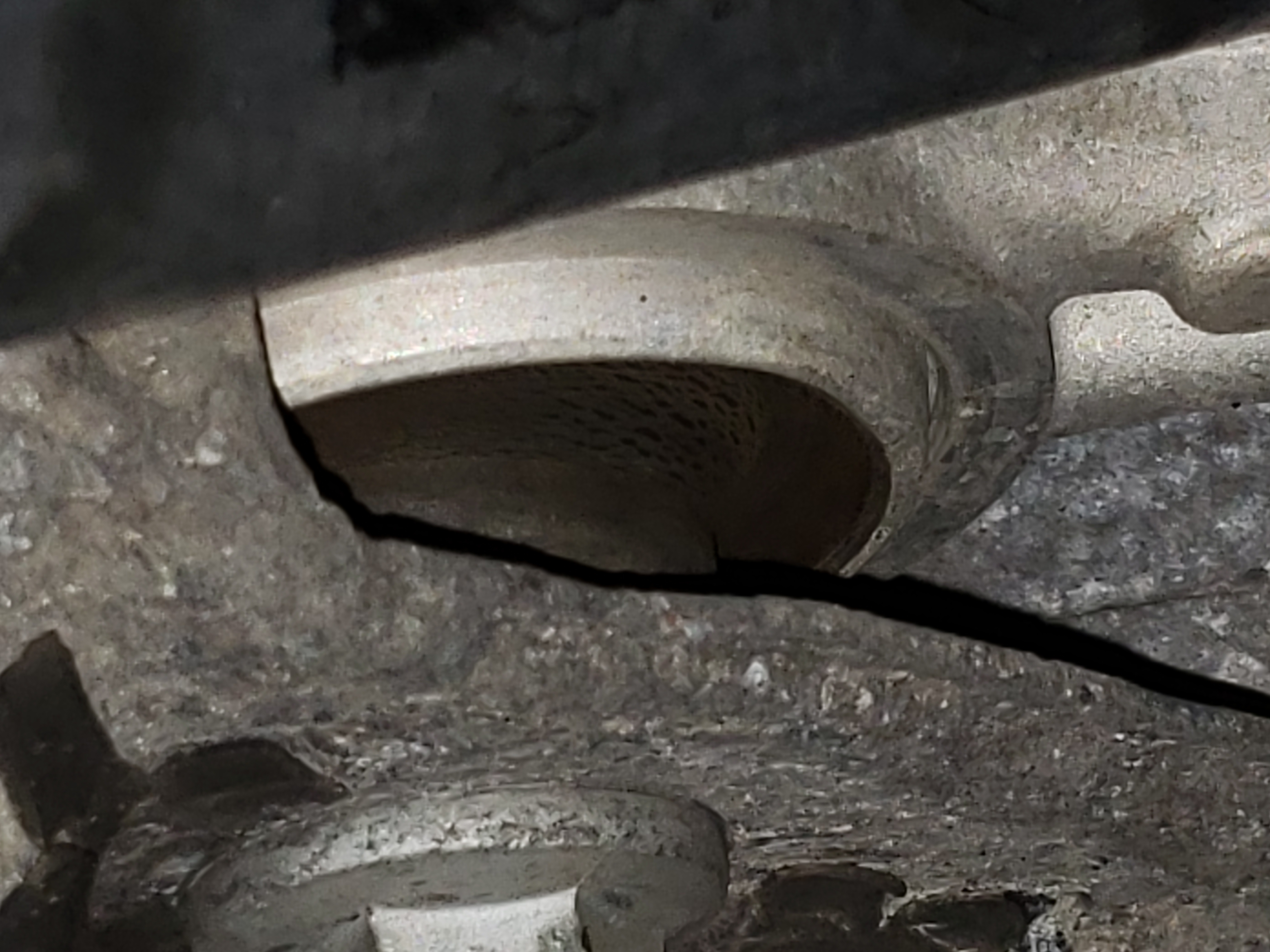

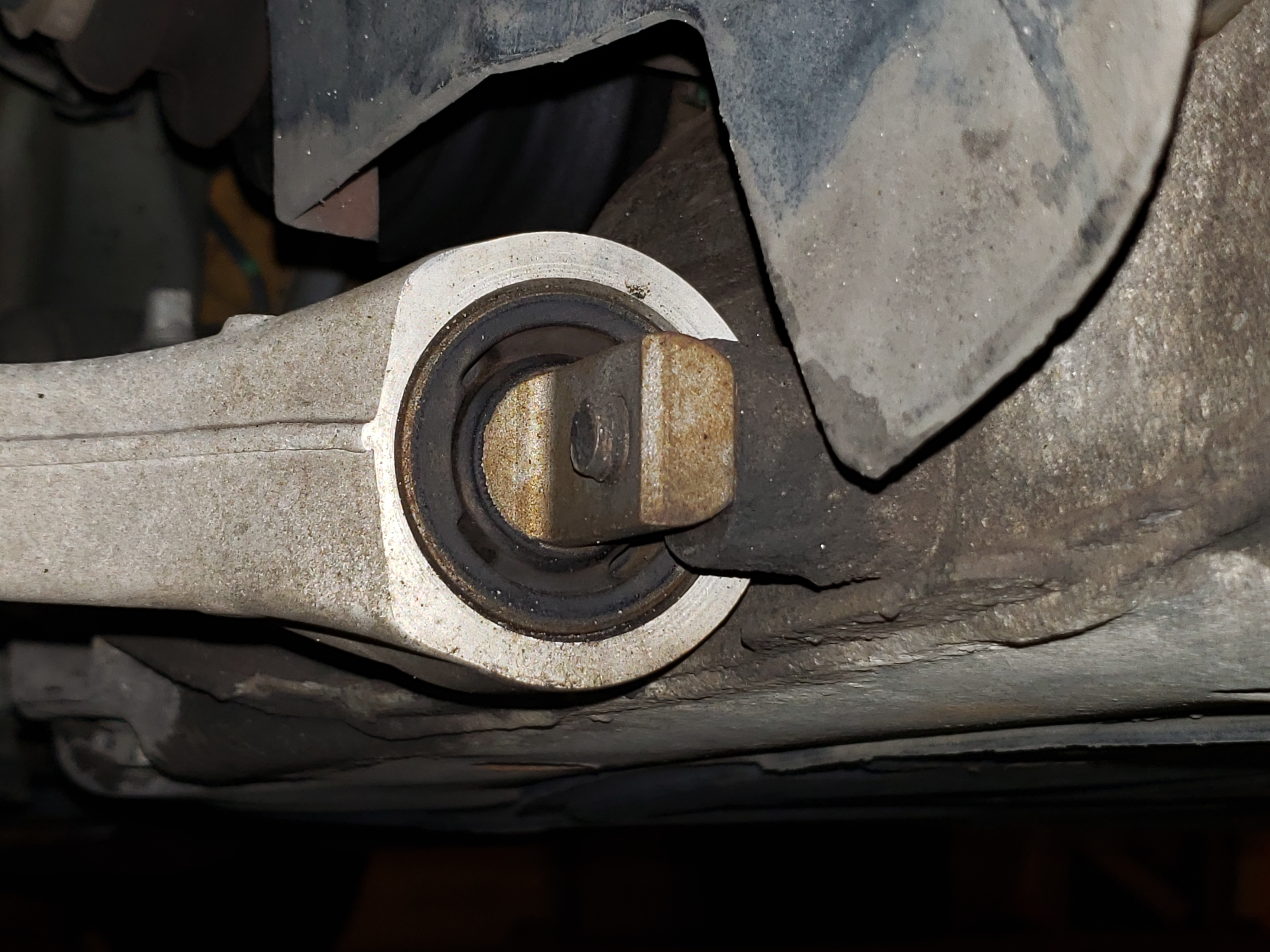

I had Lemforder control arms and ball joints changed on my 04 S60 actually exactly a year ago yesterday. In that time I put about 7-8k miles on it. Here are some pictures of the bushings (just getting under the car - they're still installed. Sorry for bad angles): The rubber is still in place for all 4 but are those stress cracks in the rubber for the back ones? My eyes are untrained to what is really bad.

Stickypocket, those are fine. The rear bushings will exhibit some small tears like that as the vulcanized rubber flexes with front suspension travel. Don’t fret yet, but get in the habit of checking them when you’re under the car.
