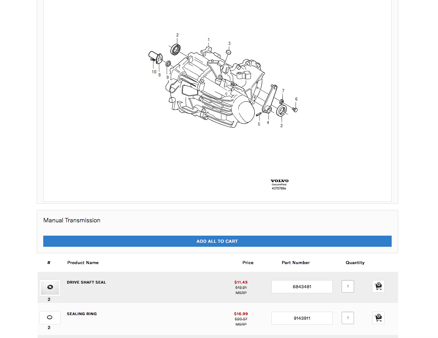

I want to confirm these are correct for my application because i have been sent the wrong seals twice already. I have a 2000 C70 2.3 T with the Manual M56 Transmission.
Volvo part # 6843481

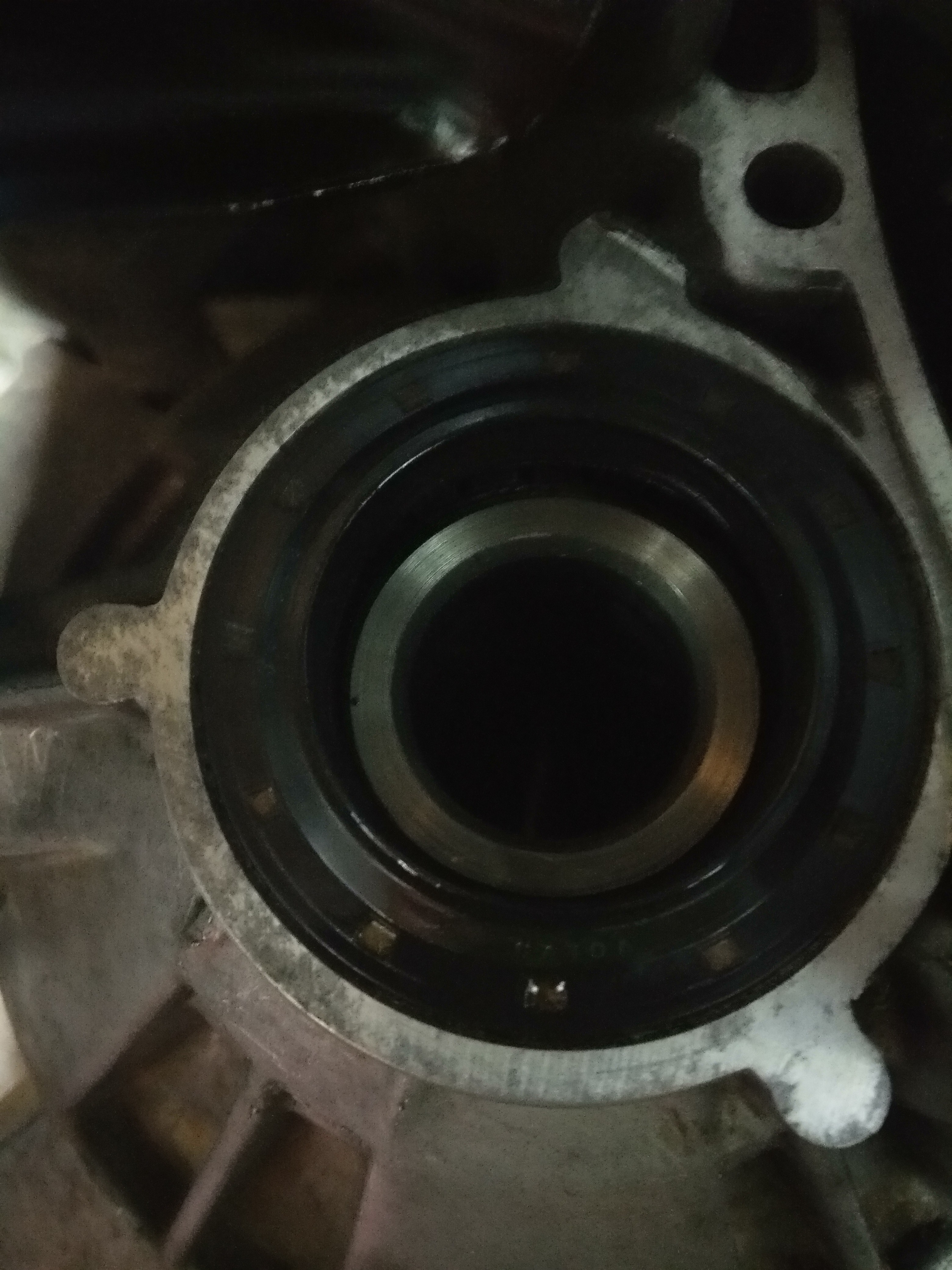

The seal I need is the output shaft seal,at least that is what i think it is called. The RH side axle shaft seal, the seal that is on the end of the transmission where the axle slides into. RH side.

I confirmed that this was the correct part number, i finally was able to get the camera to zoom in on the seal enough to see the part # on the old seal.

I like this place for finding part numbers - note there is a VIN break on the mainsheet seal between 1999 and 2000
https://www.volvopartswebstore.com/show ... evel=11162

I ordered 2 of the 6843481 so I hope I was correct according to the Vida diagram from emanuals online.

I did not order the 9143911 so I hope it was not necessary!

This is the one I need.

Well I installed the new axle shaft seal, and I still have a leak I can not find because it appears to be hitting the top of the driveshaft while spinning and slinging it everywhere to the point I can not tell where it's coming from,man this is frustrating, this is the only reason we can not drive the car,it starts slowly smoking by the time i get home just from driving a few miles because it being slung onto the exhaust just below the turbo.I am beyond frustrated,ready to take it to Volvo except it is my only vehicle and the closest Volvo dealer is over 130 miles away.
