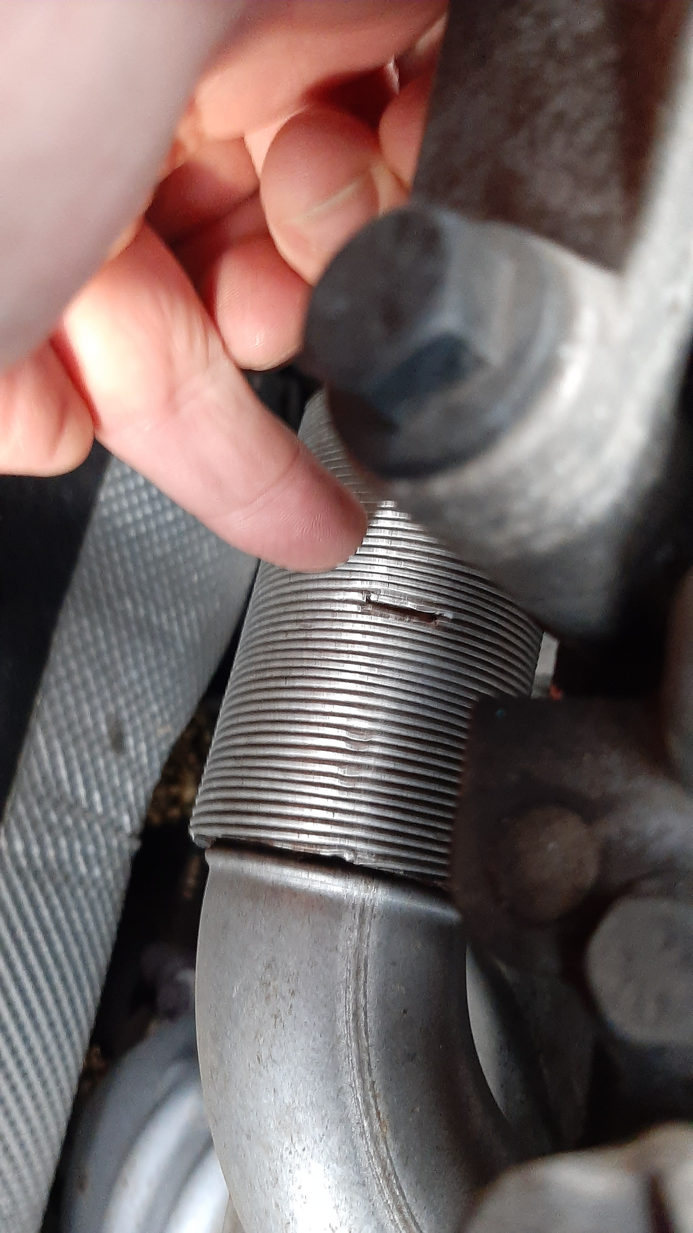

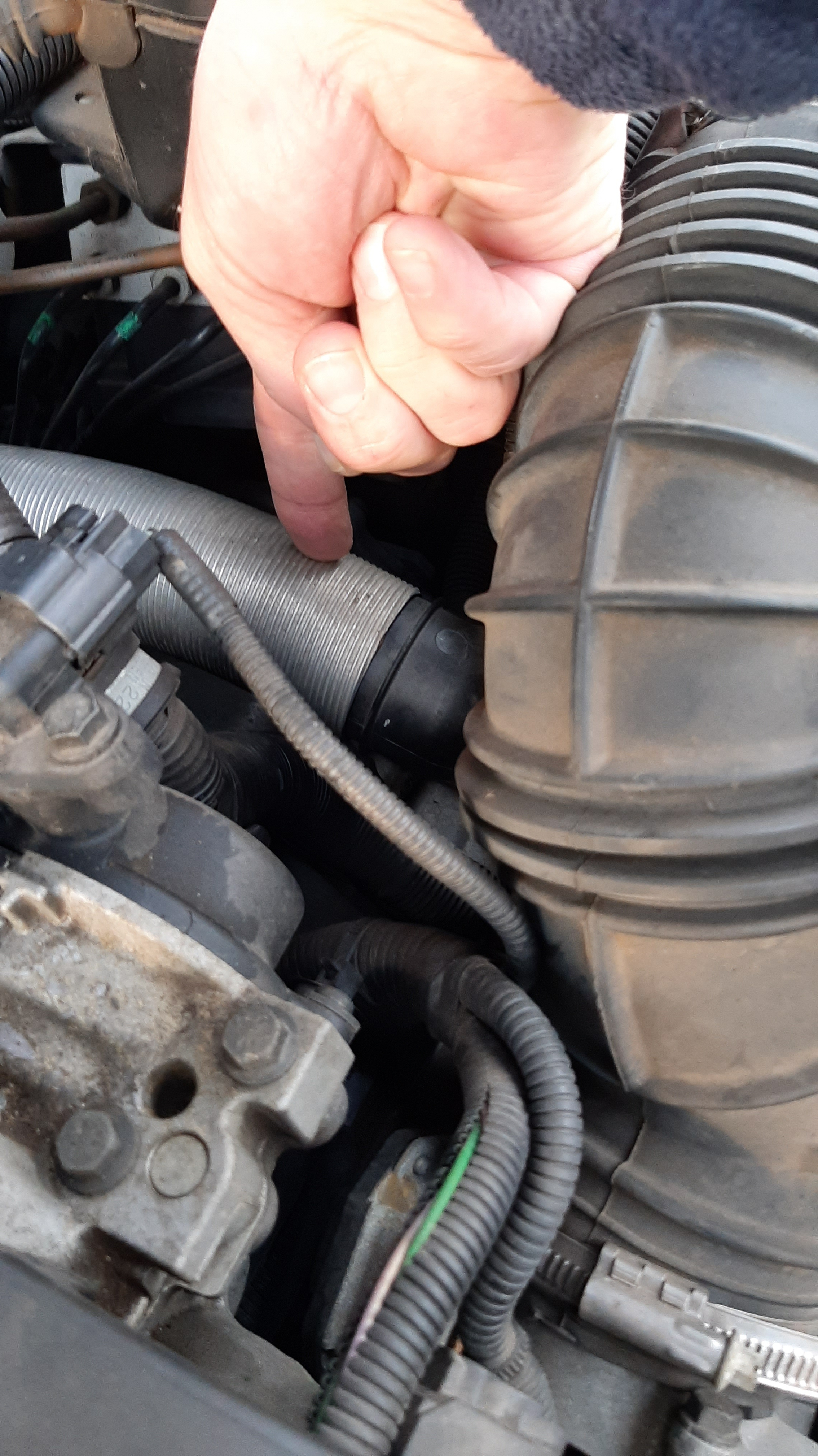

I got an ODBII reader and found a code description (sorry, I am not near anything to get the actual code) that reads large leak in Evaporative Emmissions. Looking through the engine compartment, everything looks good and secure. The only thing I found I am actually very curious about is there is a 2 to 3 in aluminum hose behind the engine block accessible from the open hood that is connecting the engine to what looks like the air flow system. Not sure what it is but it is just one there; no ring claps or anything there other than it being loose and freely moves about the receiving hose connections. Odd to me.

The parts are new but not OEM. That was a $$ decision I will live with. Performance only improved but slightly so I am not concerned. This is a 2005 Volvo s60 base model. I have been asked the R question before and I am not clear on that. However, I know it is NOT turbo. So, that is out. The pipe I refer to I believe is call a Pre Heat Pipe or something like that. I found it strange to have a hose attached to the neck of something else without some kind of restraint, clamp or otherwise. Pictures inline. I also read somewhere that the EVAP code could be due to a bad seal on the gas cap. I got one but have yet to give it a try. The other looks okay, but then again the rubber seal is a bit stiff. Thank you everyone for your replies!

thats just the hot air intake, its only needed in sub zero temps

That big fat silver tube tells us you don’t have a turbo, so simpler to work on.
Ignore the evap code for now, that won’t cause poor running.

As said above, those silver hoses only grab some hot air from above the exhaust, absolutely no problem if it has holes to it
