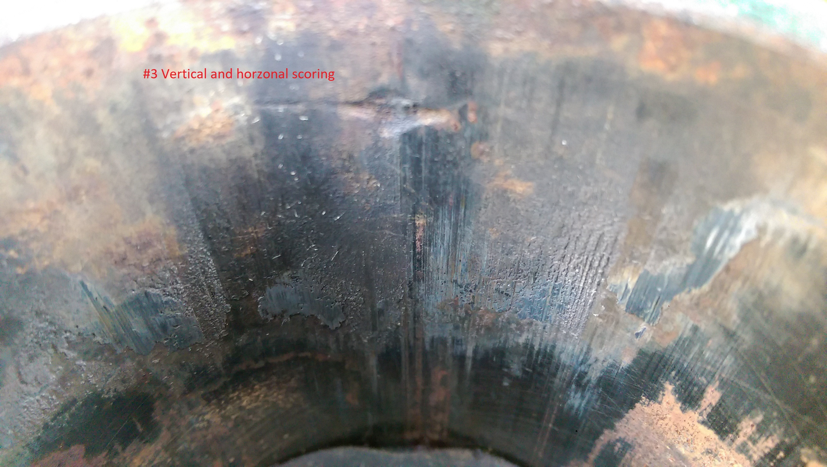

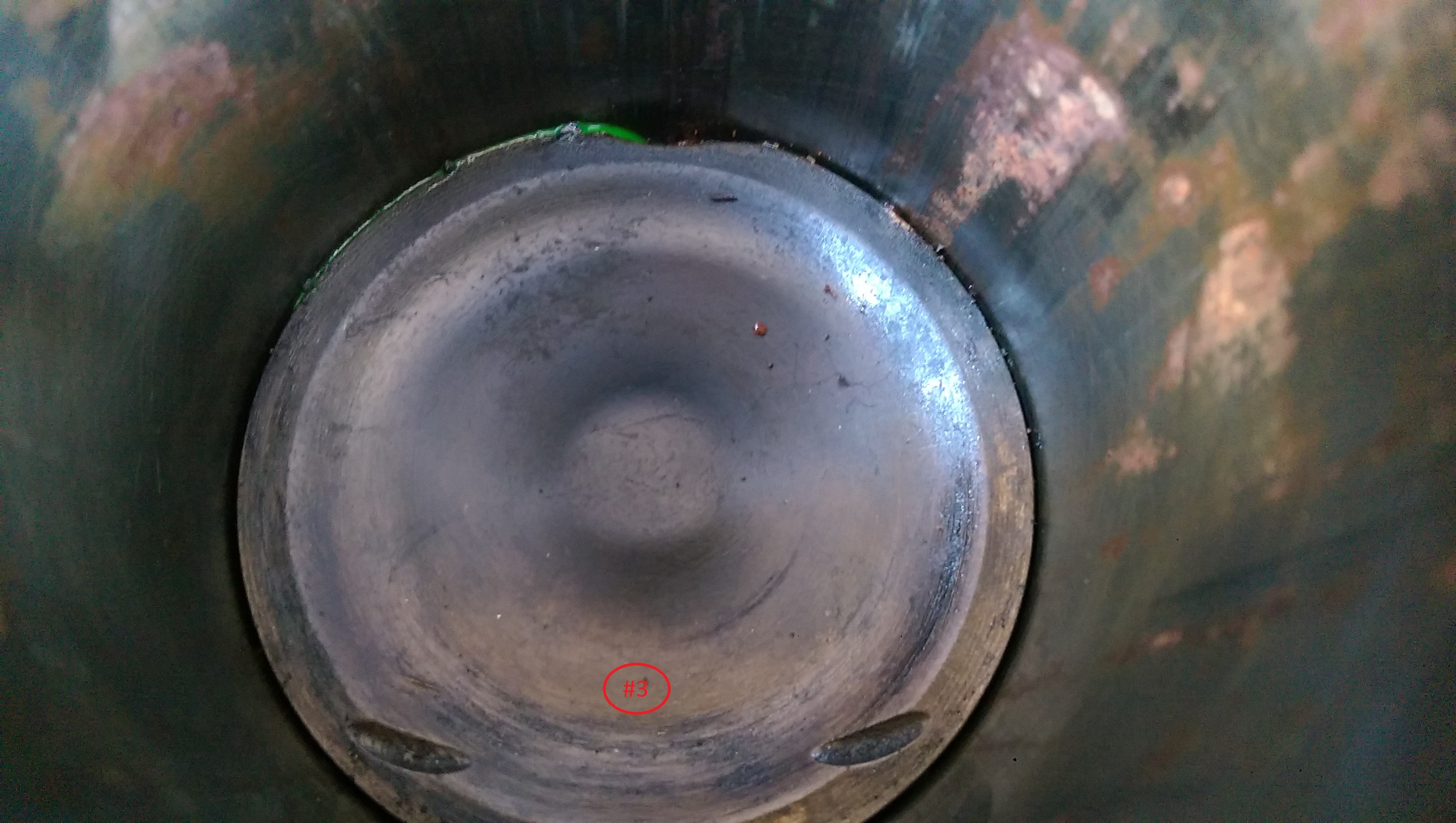

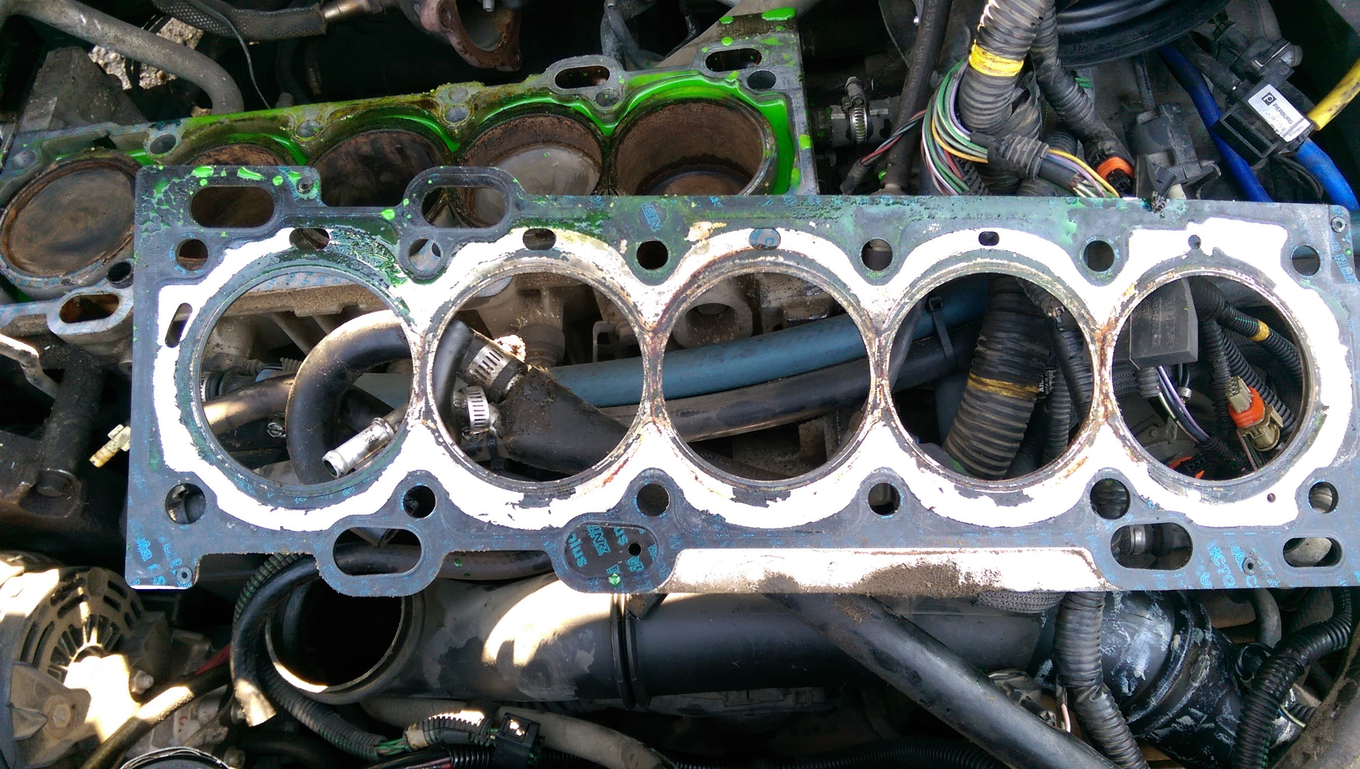

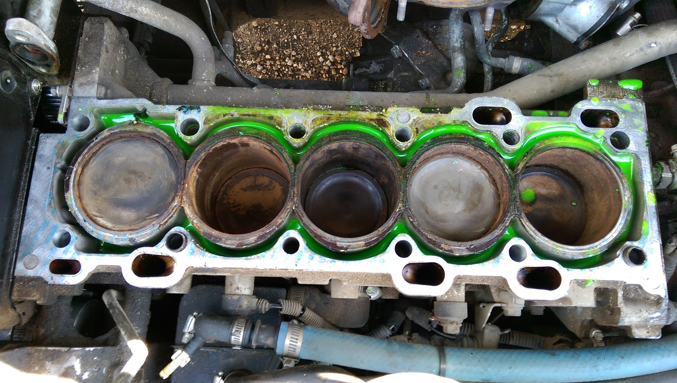

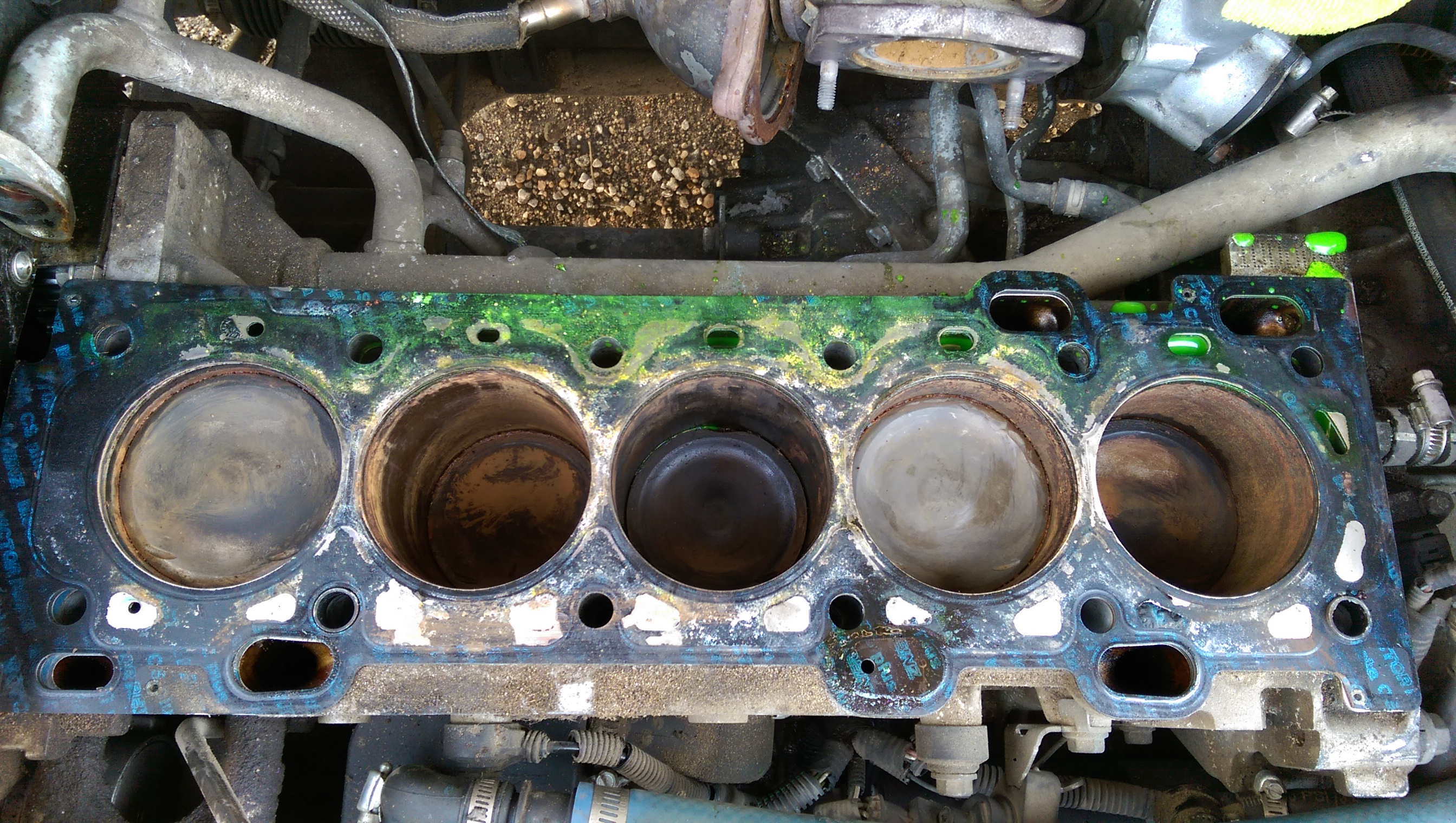

Here you go.
Got it off without pulling the right axle and the bevel gear.
Engine serial number is after 2979611 (3180225).

Thats a strangely shaped piston top.
Did it crack into the ring land, I wonder? No sleeve cracking, but thats about it for the good news.
Hmm, so many questions I have for whoever did the work.
I assume you’ll be sticking a different engine in that one’s place.

Wow, that engine is seriously forked. That's some serious damage to cylinder 3, thinking maybe it was an overheating issue?
I take it the engine previously jumped time, that would explain the new-ish looking head gasket and poorly torqued head bolts.
But just to add to the original topic (obviously you've gotten past that point), yes, I've gotten an exhaust manifold off one of these with the axle and angle gear in place. These S60s are tight back there, especially with AWD, but it's doable.
