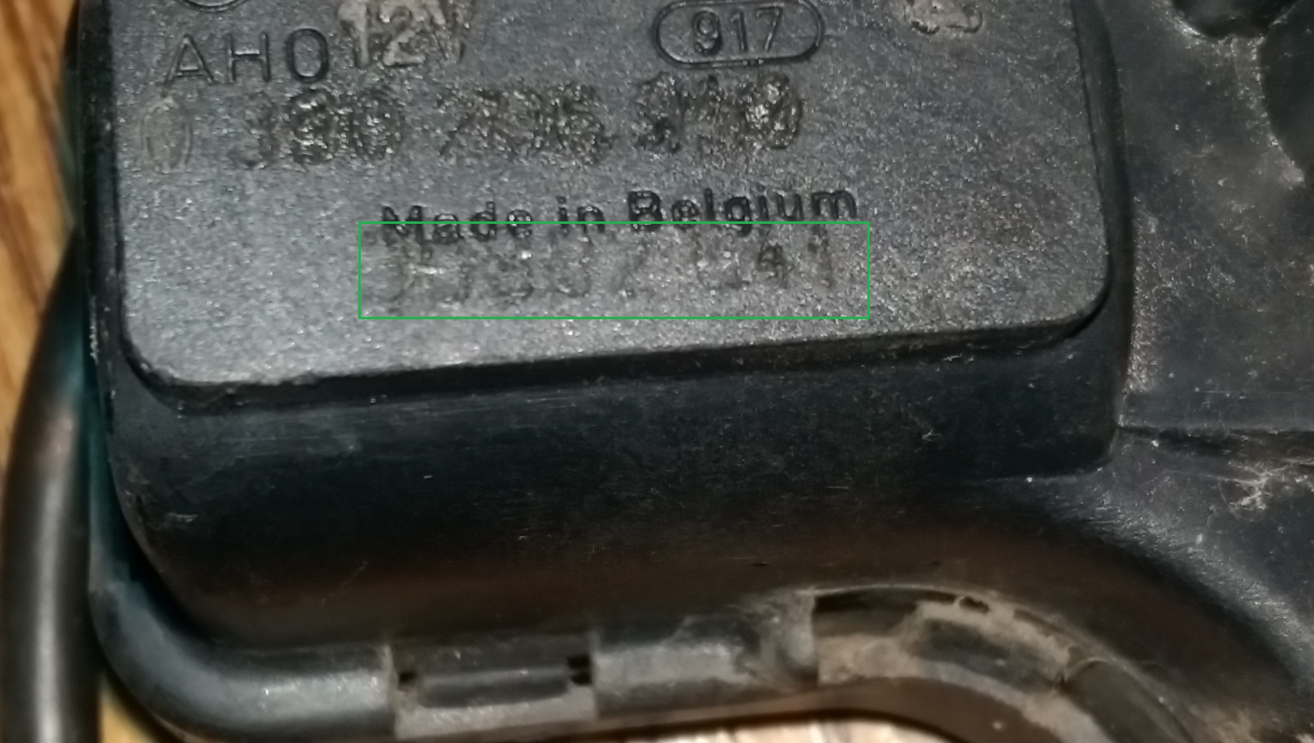

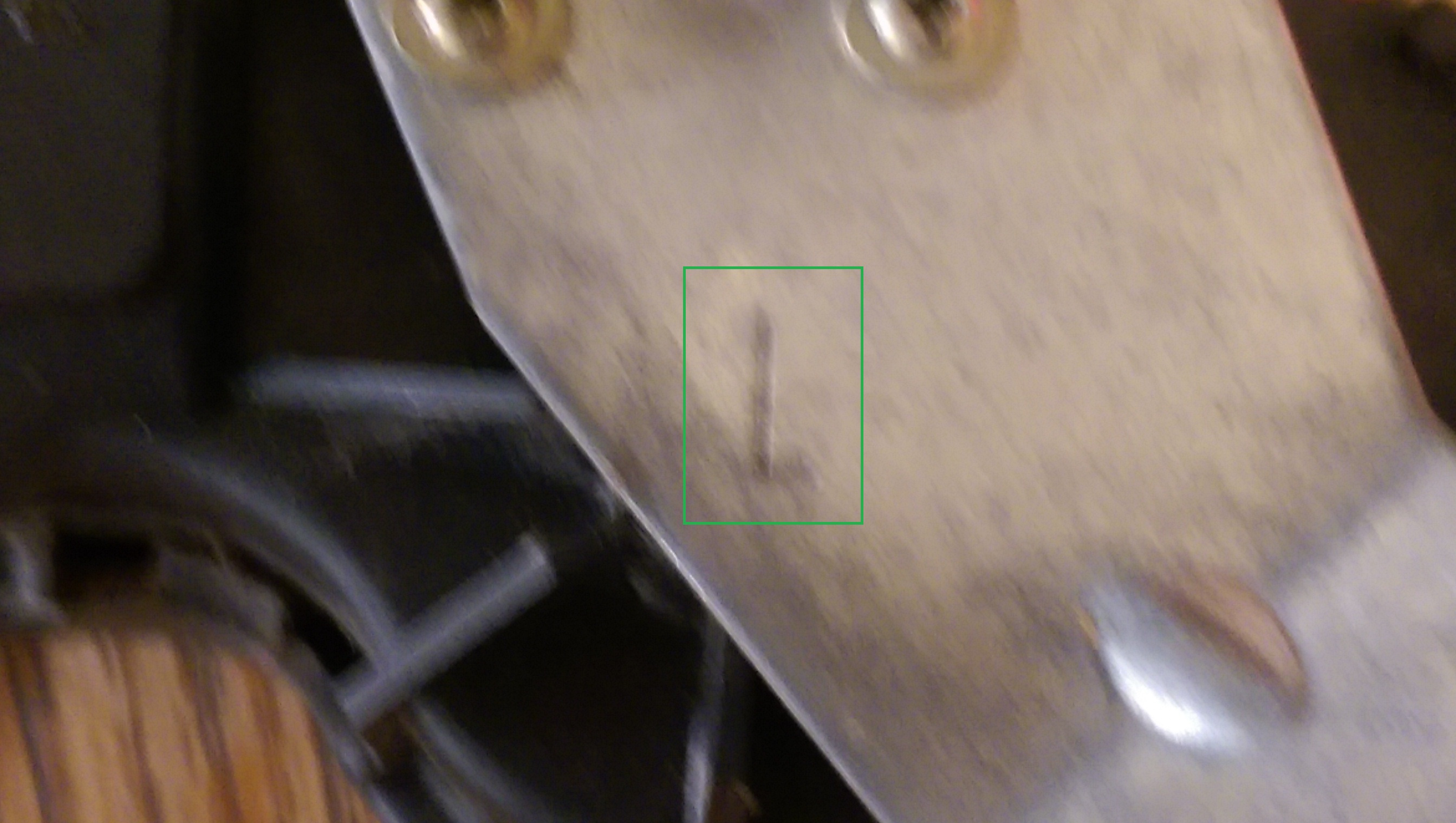

L for left bracket.850oldschool wrote: 04 Apr 2020, 19:48 If it were that simple I certainly wouldn't be bothering you guys! Maybe I'm looking right at the numbers but I can't find any.
Volvo part number 30882641 in the green box, is a left headlight wiper motor. The right counter part is 30882642.
The numbers are easier to read if you wet them and move them around in the light.

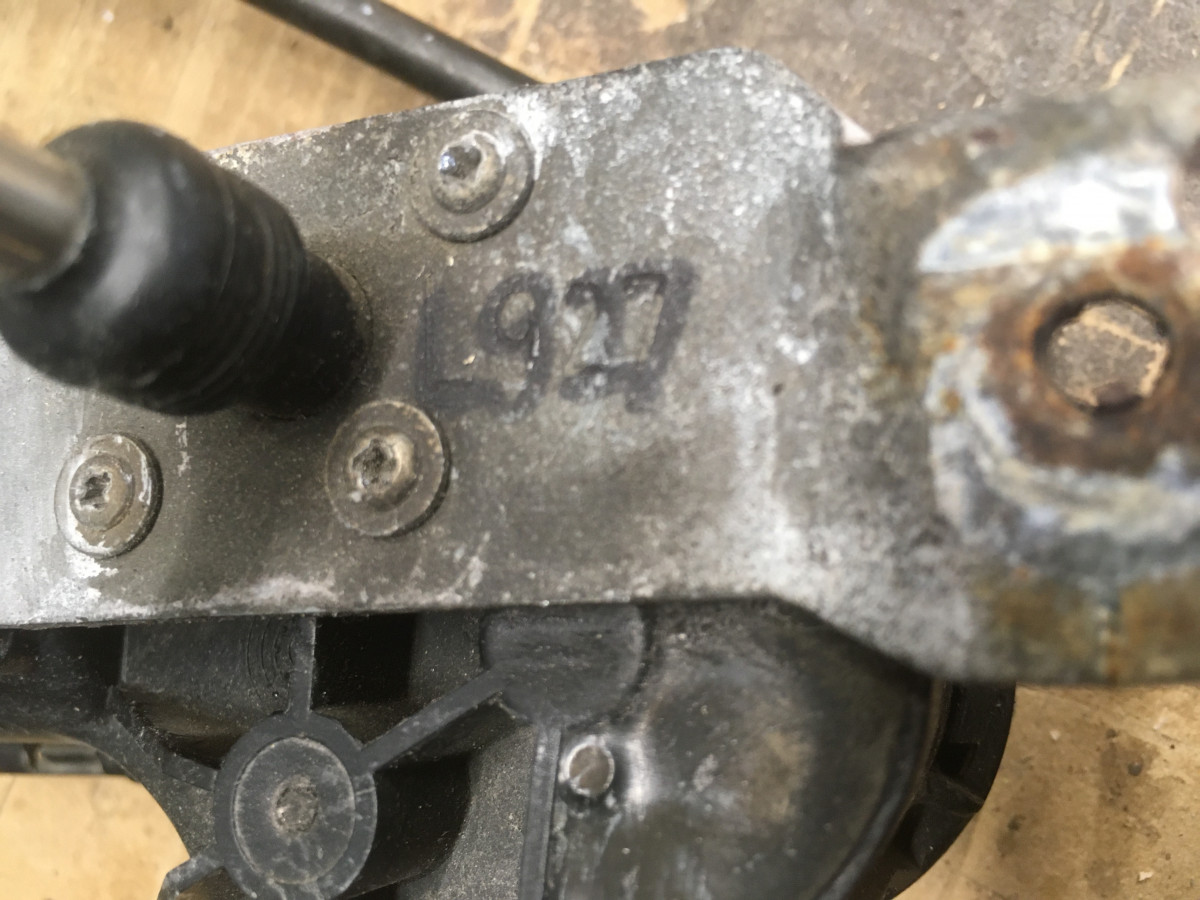

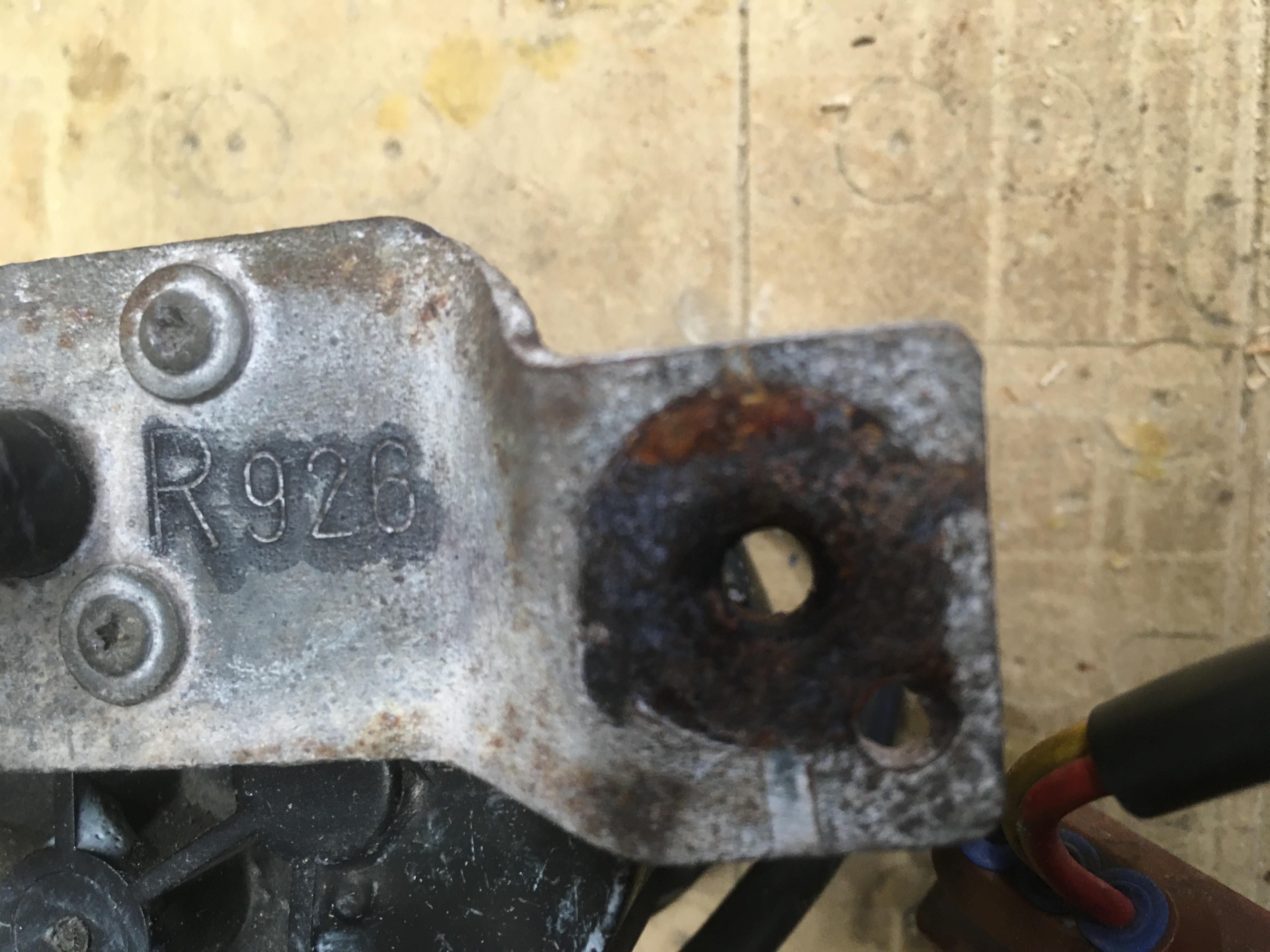

Some scrubbing turned up the identifying marks. While the marks are pretty clear on the right one, they are stamped a lot lighter on the left one.
