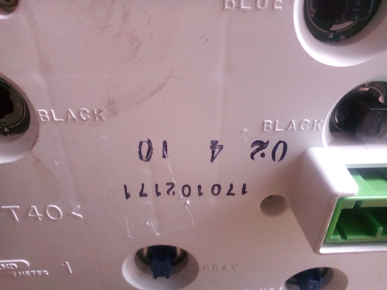

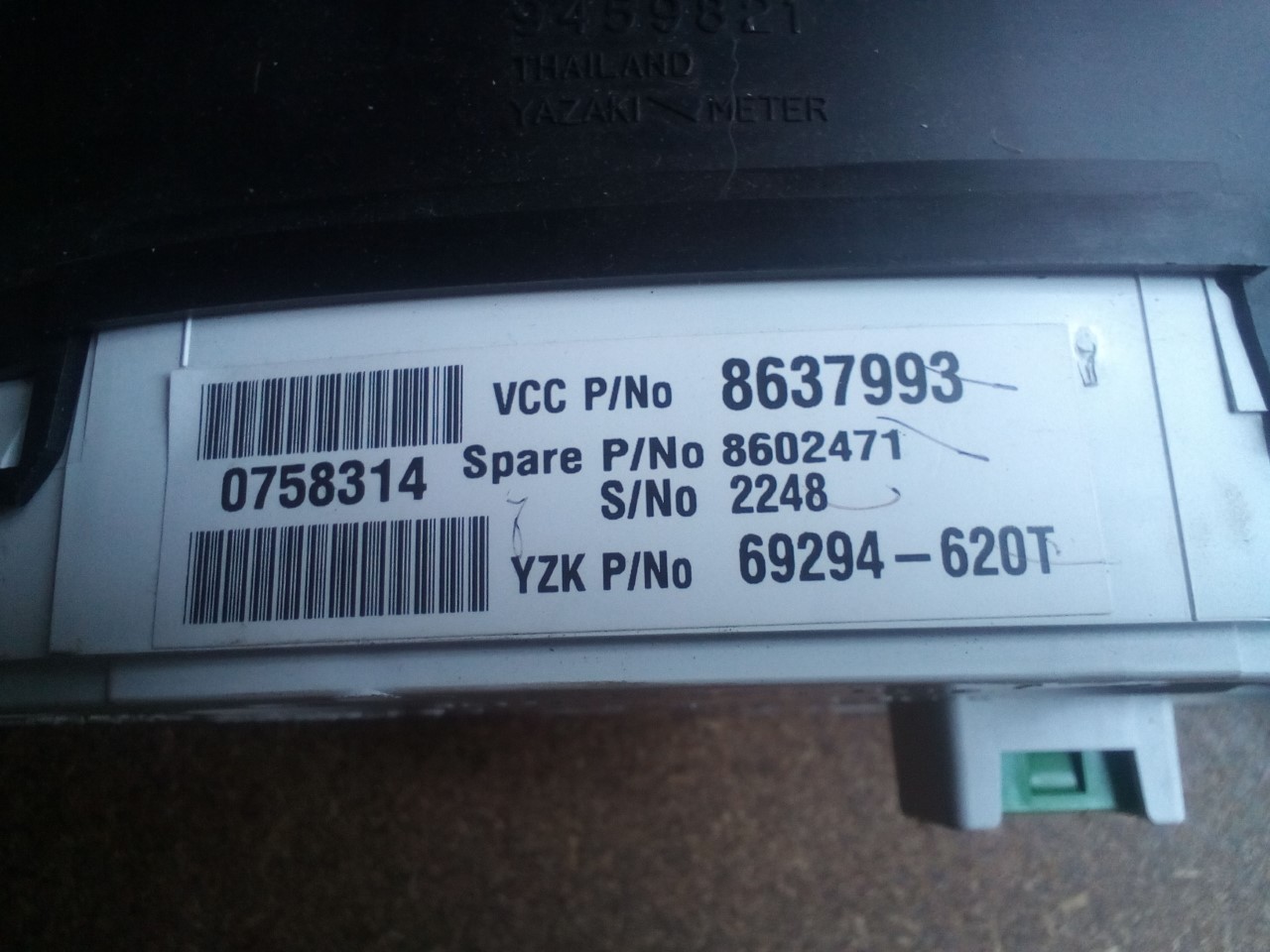

This is my spare DIM from a 2002 xc70. for reference, if someone could label what these numbers?..i havent tried plugging it into my 2001xc70 to see if it works.
Try websites to see if part numbers are compatable according to this website https://ecu.eu/ this 2002xc70 DIM is not compatable with a 2003 s60 only a 2002 s60
Note Does Peru use Km's like Australia?..does US have Miles/km dials??. changing the dial facia is very easy.
i think this is the date should be 2002, its upside down because im in Australia
