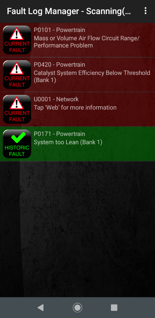

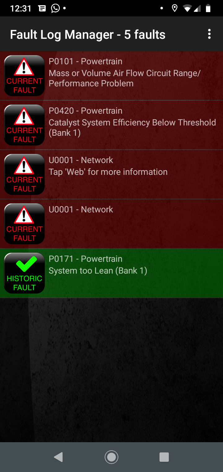

So my Volvo is back at it. (Please see attachment) little back story, I just got over a knarly problem in the car that had to do with the network, and it ended up being the electric power steering pump (thanks again Paul) but now I have this, and as I'm sure you'll notice I am still throwing a network code. Also the P0420 code I've had for months (mainly because I know other P3 guys had problems chasing that problem) so any suggestions on how to proceed? Should I get the air fuel oxygen sensor or perhaps this is another network problem? Any suggestions? Any experience with similar/identical problems.

The MAF code and mixture lean codes get fixed first. catalyst efficiency occurs due to a bad cat OR when the exhaust gases going into converter are not what they should be given the oxygen level measured by front oxygen sensor. Let me explain: the oxygen sensor measures oxygen and there is an assumption that the hydrocarbon, carbon monoxide, and other gas counts are proportional to that oxygen level. A bad sensor can report a signal not accurate for the oxygen level due to a fault with sensor, a leak in exhaust may pull in oxygen that would indicate the mixture is in the correct place along the rich lean curve, or individual cylinders are lean or rich and the way the single oxygen sensor is used to monitor average oxygen and then the ECM adjusts fuel delivery to get that average oxygen level in the desired level has some cylinders overly rich or lean causing the true multi gas balance to be off and causes catalyst to not function correctly.

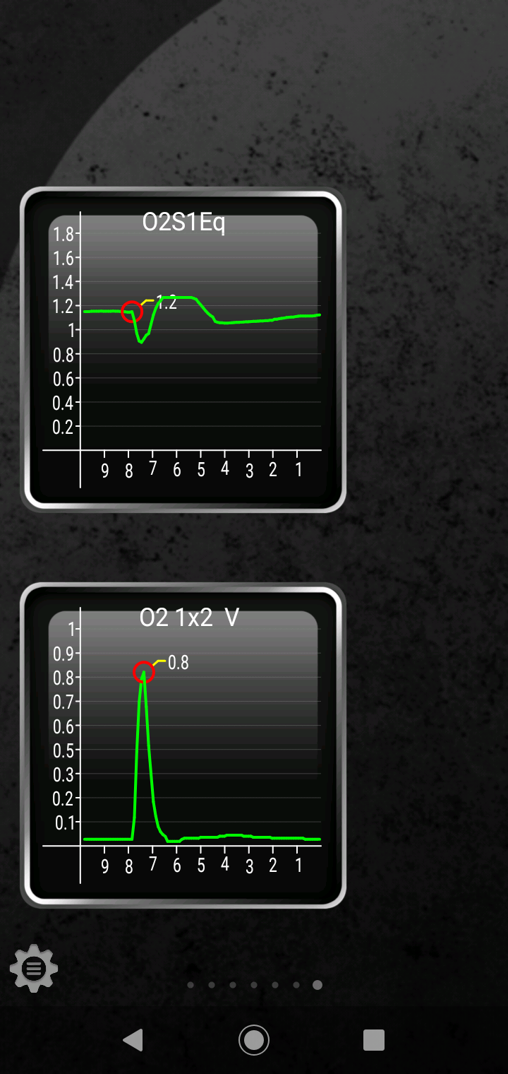

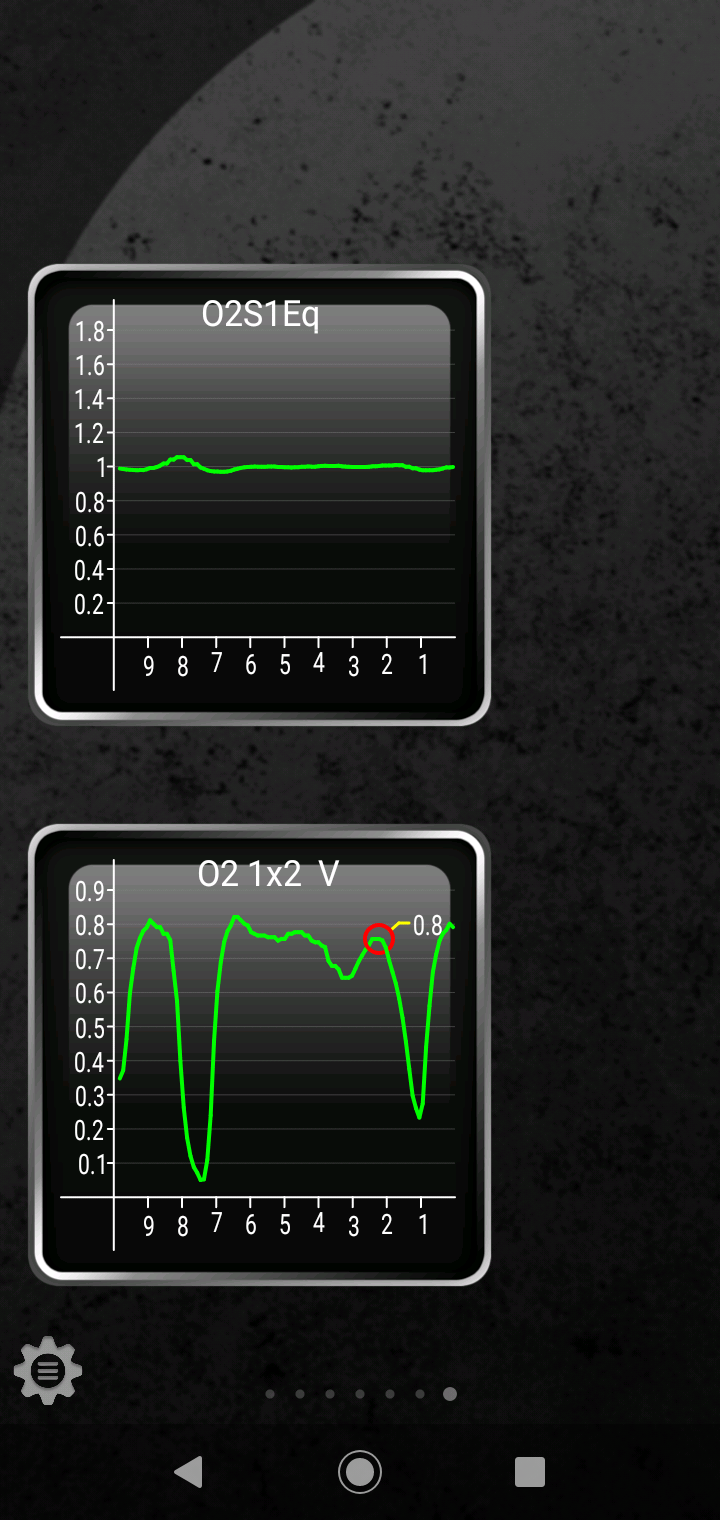

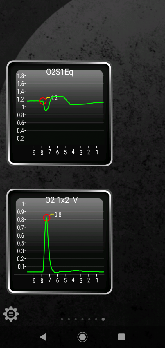

Great information man, thank you so much. But interesting enough before the leak test the voltage in sensor 2 was bouncing all over the place. The test went as you said it would things stabilized quick and even the second sensor went where it was suppose to, then started bouncing like crazy. Anyways I'll start looking for leaks.
What do you make of sensor 2? Should I resent my codes for the time being?

The downstream, #2, sensor is the one checking catalyst. If it more or less mimics the front one then the catalyst is not working. If the front goes below 1, to something like .97 and the rear goes up to .8V and then when the front goes over 1 to something like 1.04 and the rear goes to .1V and it is predictable and consistent then the catalyst is not working. The car should be driven 5 miles to assure catalyst has warmed to working temp before any decisions are made. The rear sensor will be more accurate if you drive so the engine is working but on level ground with steady throttle. Good catalyst function will make the rear signal settle and be pretty stable at .61 to .66V in my experience. When you accelerate the rear will go to high V (.8-.9V) and when you coast it will drop to .1 or 0V.

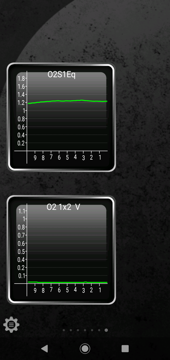

jimmy57 wrote: 18 Apr 2020, 10:38 The downstream, #2, sensor is the one checking catalyst. If it more or less mimics the front one then the catalyst is not working. If the front goes below 1, to something like .97 and the rear goes up to .8V and then when the front goes over 1 to something like 1.04 and the rear goes to .1V and it is predictable and consistent then the catalyst is not working. The car should be driven 5 miles to assure catalyst has warmed to working temp before any decisions are made. The rear sensor will be more accurate if you drive so the engine is working but on level ground with steady throttle. Good catalyst function will make the rear signal settle and be pretty stable at .61 to .66V in my experience. When you accelerate the rear will go to high V (.8-.9V) and when you coast it will drop to .1 or 0V.
The sensors the second sensor is at 0v all the time, and the air fuel it at 1.2. I suspect since it just switched to this is a network issue? The cat is not a binary on off kinda thing right? It wouldn't be working then all the sudden not?
