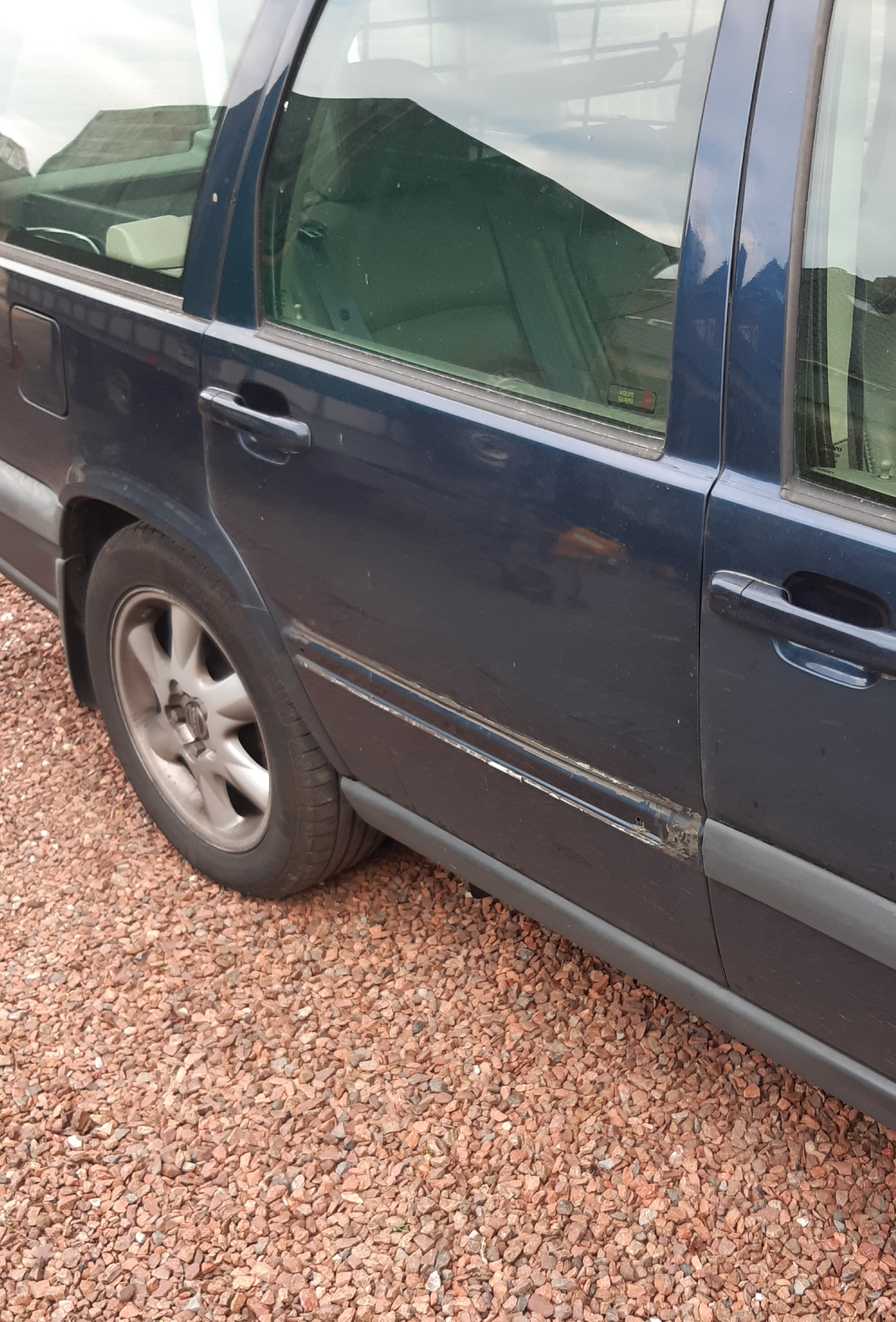

Hi!
Since I upgraded my pc to windows 10, I unfortunately lost acces to VIDA.
Would anyone happen to know (or be so kind to look up) the part number for this piece of door trim? It got busted up when one of my passengers slammed the door with the seat belt in between, a little later I seem to have lost it on the highway... So now looking for a replacement part, which is hard to find just using the word 'door trim V70'.
Thanks in advance!
Joost

Joost, this should be your part:
https://www.skandix.de/de/fahrzeug-teil ... r/1026354/

Interesting, as I have just got my Vida running again, and according to it, the rear right door is a different part number for an XC. It lists the part number as: 9178509. The part number Clemens has listed is for a regular FWD model.
If all else fails, call a dealer and get them to confirm which is correct for your year and model. I am also wary that US part number may be different although I did specify for a European spec car.

Thank you Neil! I will recommence my internet-hunt using the part number you've provided.
I have a V70XC built in Belgium so I guess your part number that matches European-spec should work out.
Thanks again!
Joost
Thanks again!
Joost

I would still recommend calling a dealer with your Vin number and confirm the part number is good for your car just to be 100% sure. Because of Volvo's love of changing stuff for different markets, you have to be careful as I used a Vin from an North American car to check but put in the European area search.
