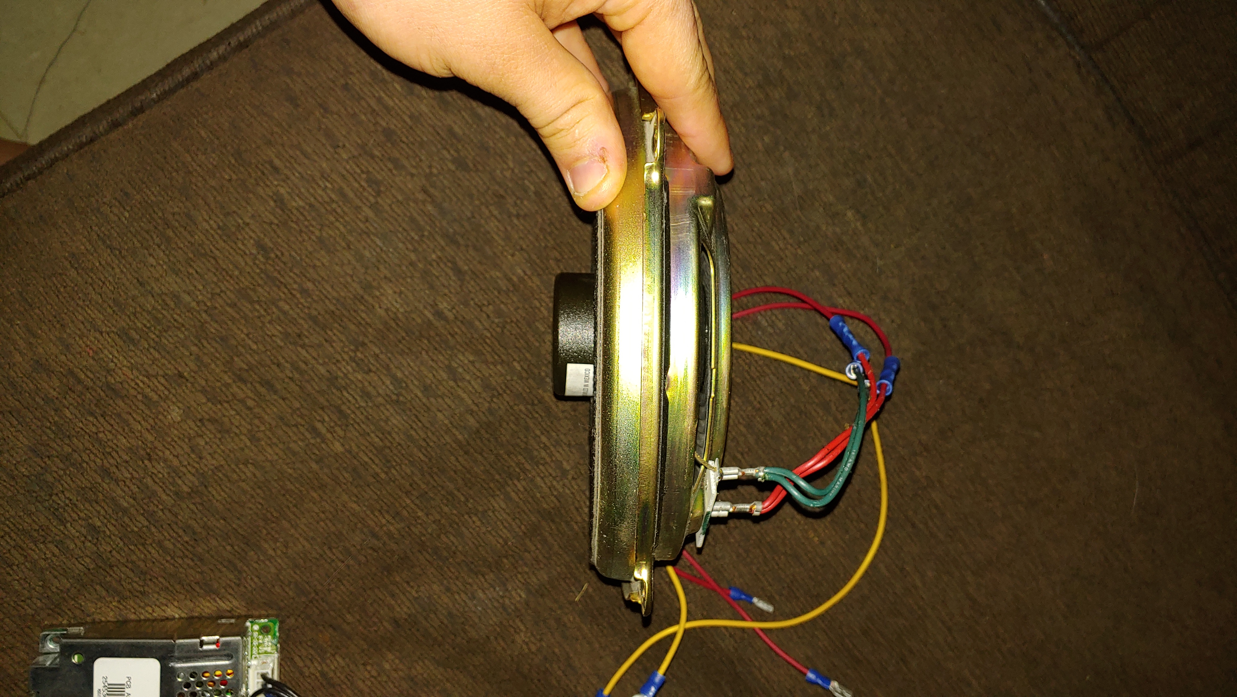

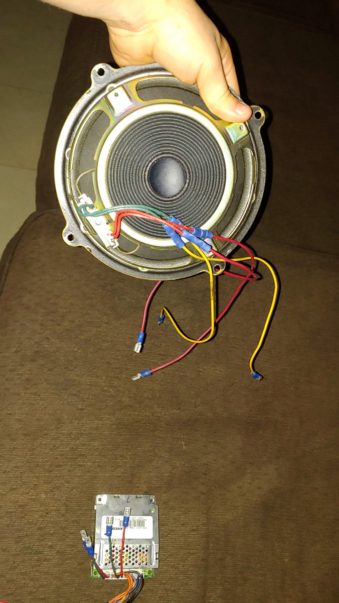

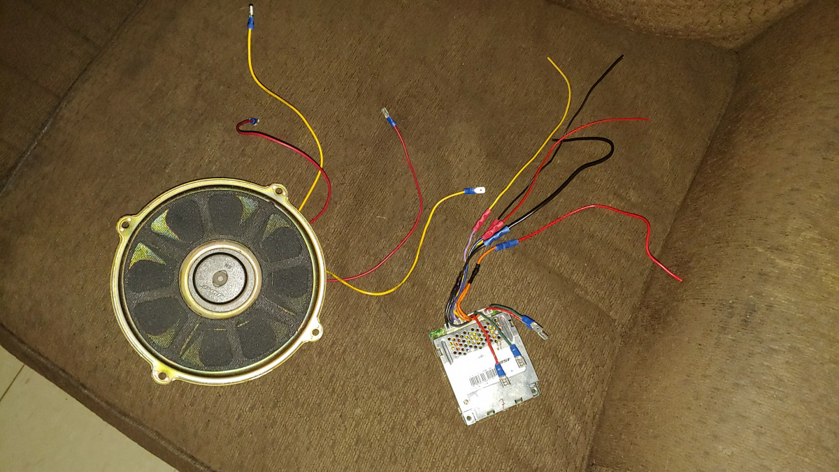

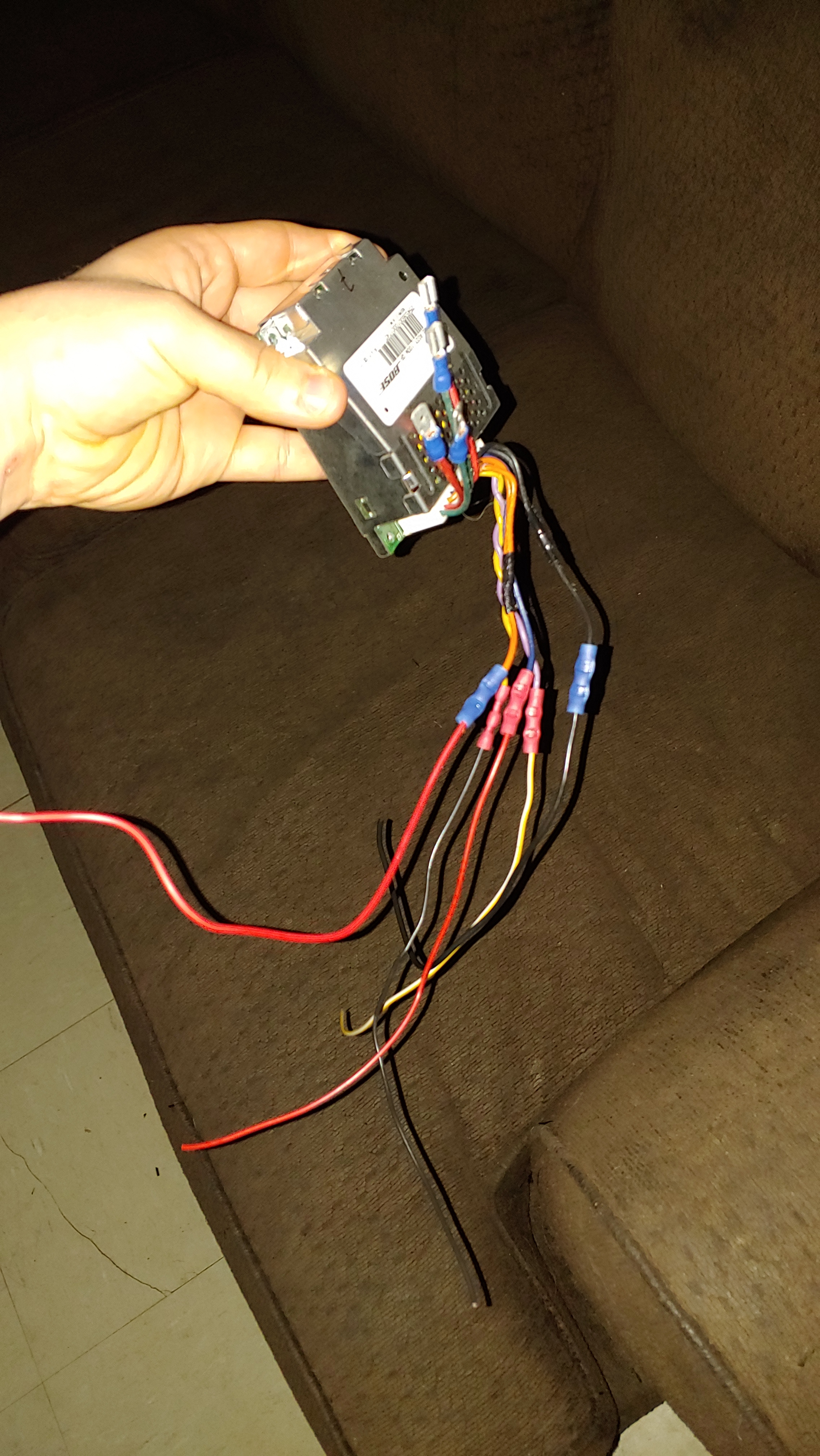

Very good write-up. Well here's the pics of sub and amp. Only sub is going up there. If you look at the pic, you can see the piece sticking up that is touching the middle of my index finger. The bottom of the piece is where the bottom of sub begins. I have to measure how deep that is. Amp is gonna go down low, behind the HU somewhere. Can you please measure the exact depth so I know what the max clearance is?Goupil wrote: 18 Apr 2020, 16:07 It is very shallow, there's less than an inch under the dash pad.
I tried taking pictures but it's already nightime so they look crap + I only have a tape mesure.
To give you an idea, the size of the hole is around 7" by 7" on the "long side" and by 5.5" on the "short side"
I'll take better measurements and pictures tomorrow if needed
