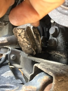

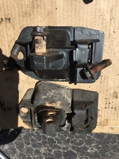

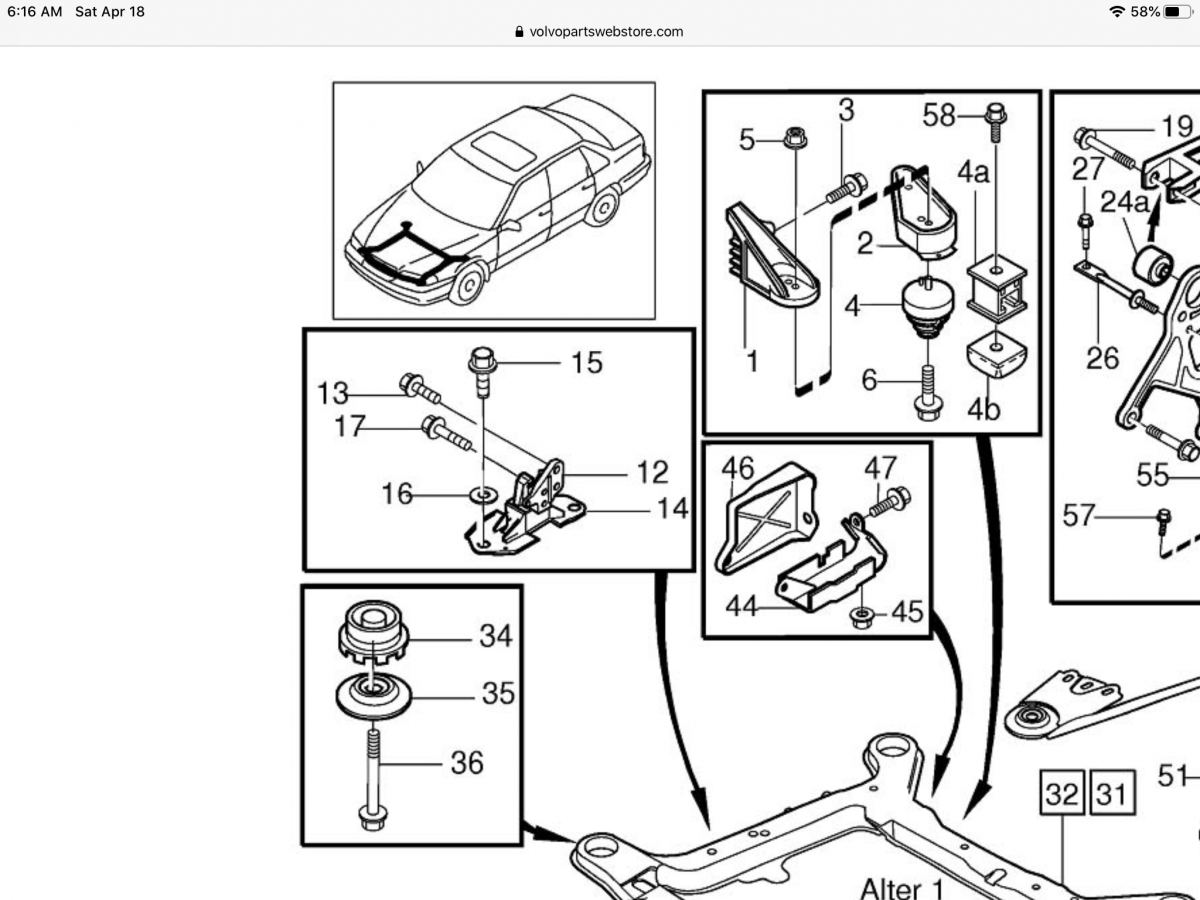

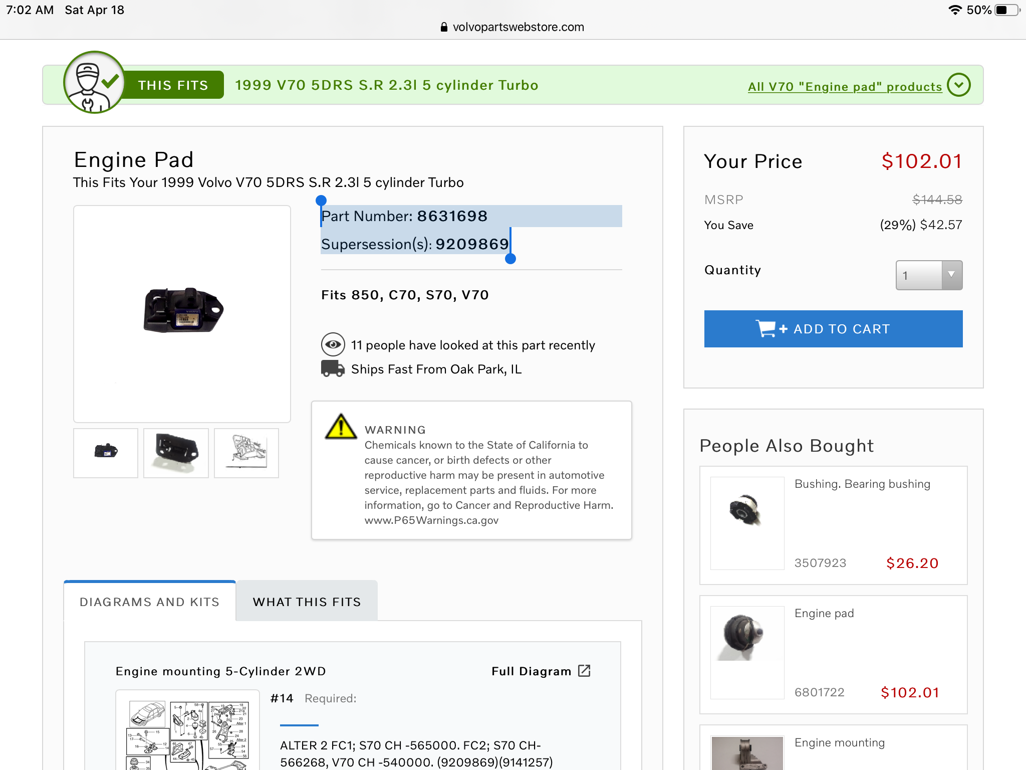

Volvo calls this an “ engine pad”
Lots of part numbers on this one.
$120 I Volvo, $30 in FEBI or Rein
https://www.fcpeuro.com/products/volvo- ... -8631698-1

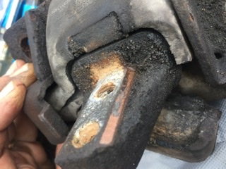

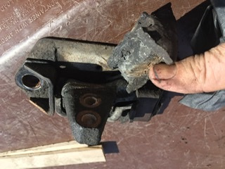

This mount has two M10 bolts into the subframe and two m8 bolts into the engine lock, through a Copper alloy metal part bonded to rubber

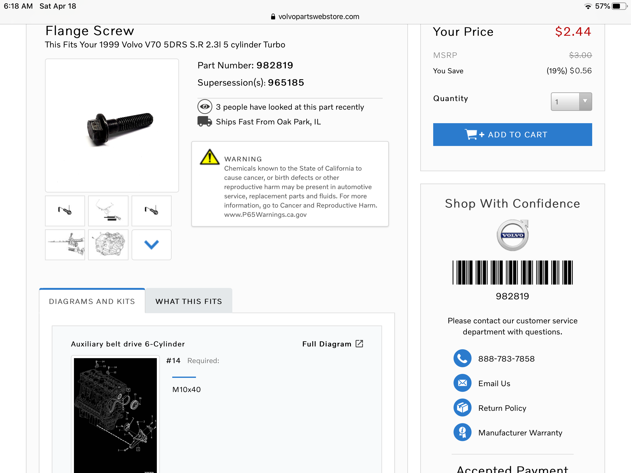

I found really bad galvanic corrosion on my m8 bolts and heavy rust on the m10s, I will replace this hardware later.

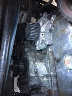

The m8s are easy to remove after moving the left wheel and wheel liner ( fold and hold out of way after removing two m6 plastic nuts)
The M10s, 17 mm hex head are much harder. I was just able to get my open end on it and get it started. That’s a highly undesirable tool for a stuck fastener as it has only two points of contact.
With the harmonic balancer and TB off you can come straight down with an impact, which I would recommend over rounding that bolt off,
You do need a jack under the oil pan with wood or hockey puck to position the engine for reassembly.

I find this one aspect of service parts stupid! Two of my engine mounts have been changed. Both are simply called "engine pad" so I don't know which two... you would think they could come up with a descriptive name for each one identifying location. Also what is a torque rod? It seems some on here are referring to some sort a transmission mount, while others seem to be talking about the mount connected to the bar connecting the struts. June

The engine rest on three pads, one front and two on the subframe
The twist of the engine is handled by two torque rods...one up top right next to the master cylinder and one underneath on the transmission to subframe
The names are totally unsearchable so people who use part numbers on MVS get a free ride in my Man Beetle
