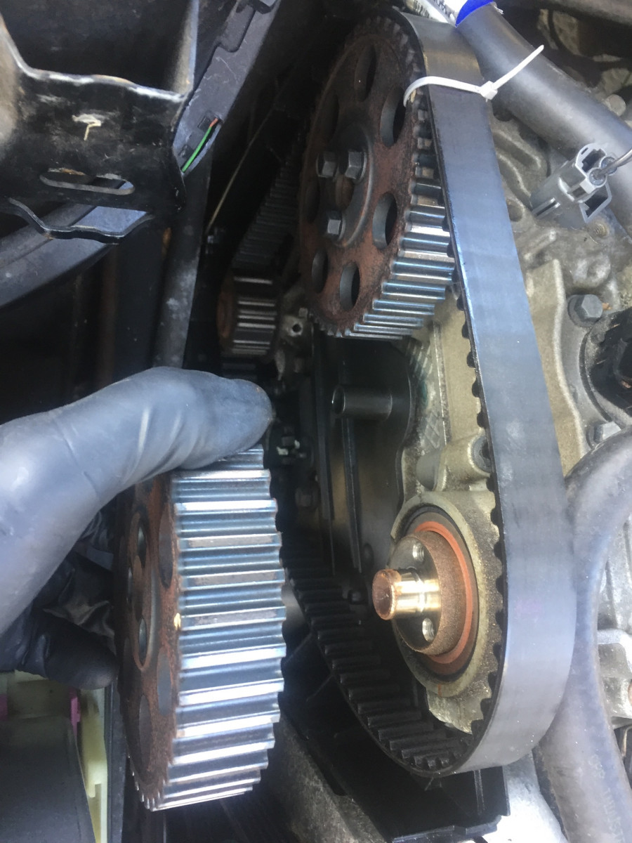

On Evita, Abby’s S70, had an intake cam seep, no VVT on this car

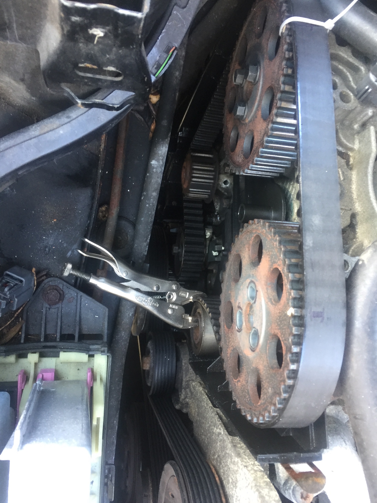

I loosened the tensioner but kept the timing belt on
I marked the position of the belt to the cams, then locked the belt position on the crank and exhaust cam
I used a zip tie on the exhaust cam, and a very light clamp on the tensioner pulley to lock the belt to the cam

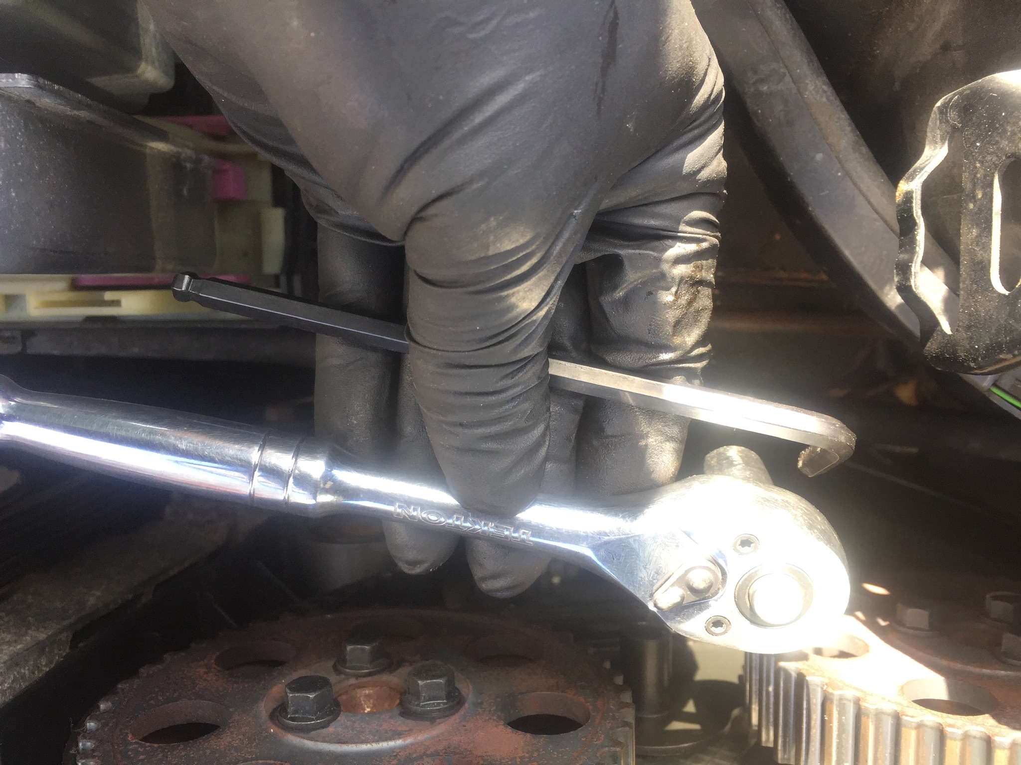

I marked the position of the intakepulley, pulled the bolts, and slipped the pulley off
Cam seal picked, replaced
And back together in 45 minutes.
