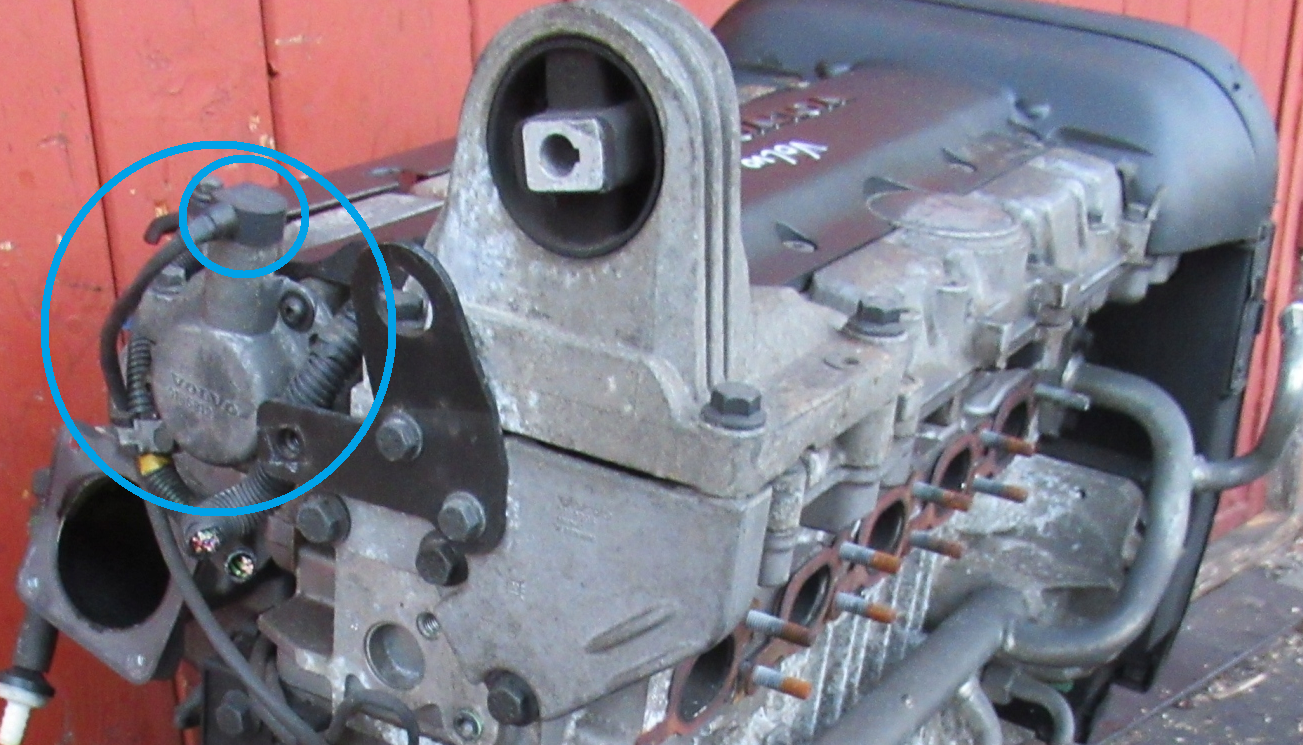

@abscate : the part I got at the junkyard is indeed 9146108.
I stumble on this picture of the engine I have in my S70 NA (B5244S2). I don't see any place where that particular part (9146108) is located.

It is buried under that rear (engine ) motor mount , the thing that looks like the Cyclops staring at you.
You have to tear a number of things off the engine to reach the cam sensor.
You can see the best "exploded" parts diagrams at volvopartswebstore.com and then put in your year, model, engine to get the right parts
I believe on a 2000 SE you have a variable Valve intake hub, so the cam sensor will be on the intake camshaft - towards the front of the car.

abscate wrote: 22 Apr 2020, 10:49 I believe on a 2000 SE you have a variable Valve intake hub, so the cam sensor will be on the intake camshaft - towards the front of the car.
Could that mean that the Camshaft Position Sensor is indeed a cabled-one and there is no need to change the housing, only the cable?

Yes, I totally messed up this thread
You have intake VVT, so the cam sensor is on the intake side. It looks like the one without the housing, visible in your picture as you circled it.
