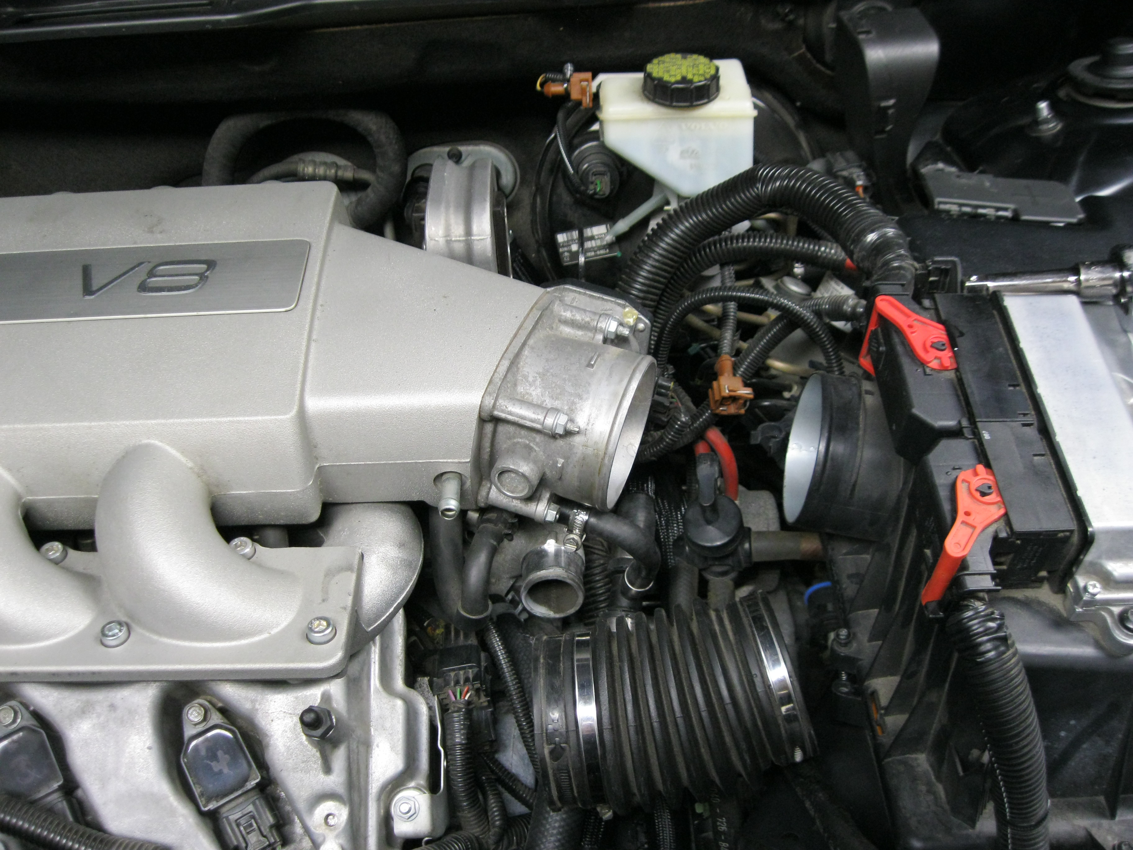

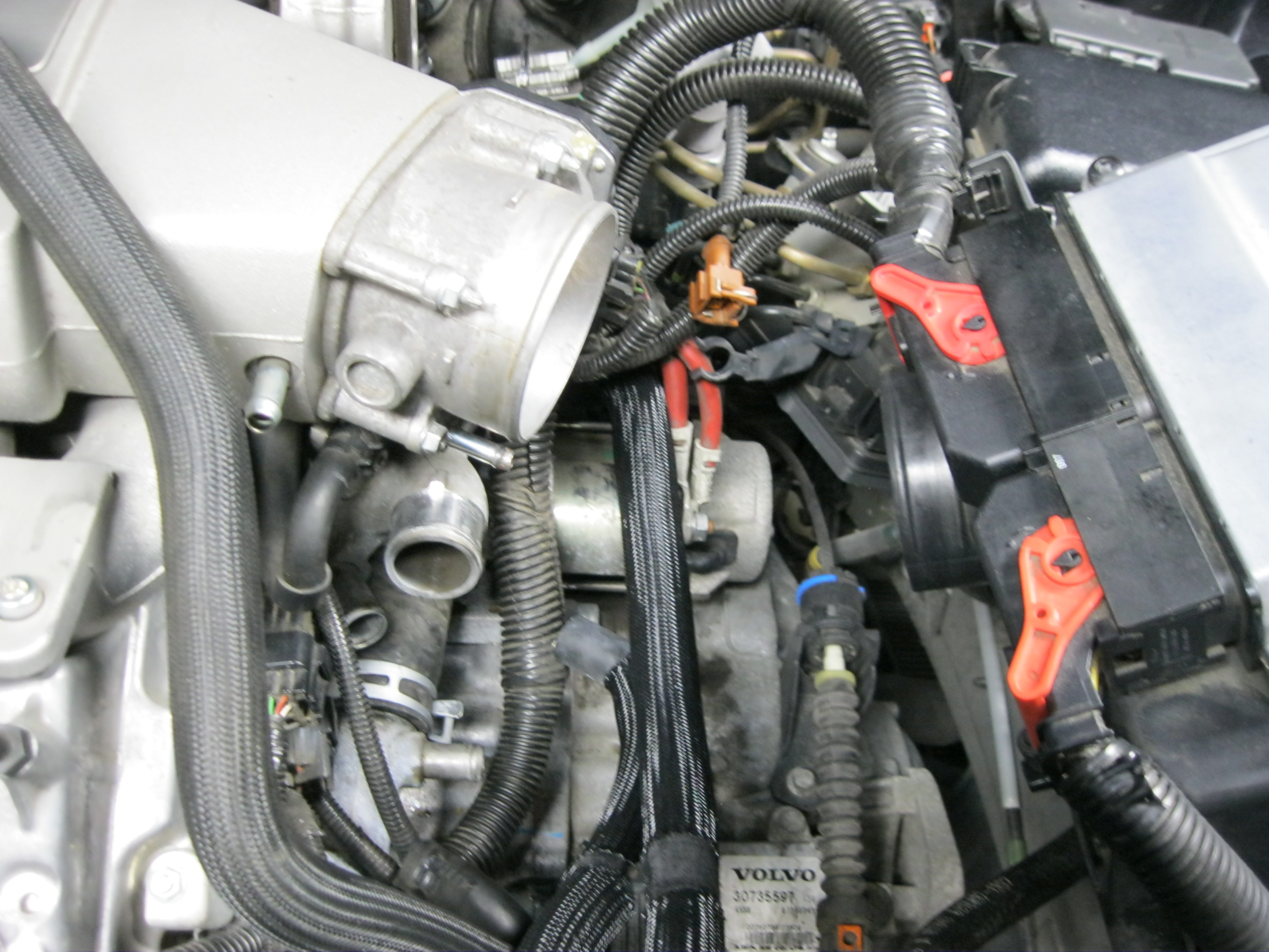

You'll need to move some things around to see the starter wires but these photos might help-
