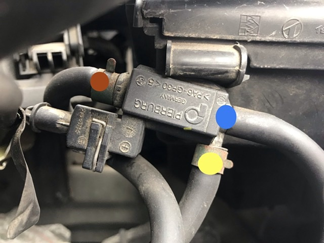

The small hose coming off the bottom of the turbo inlet plugs into the TCV (turbo control valve, aka boost control valve). In the pic below it corresponds to the brown circle on the TCV. Yellow is wastegate, blue is the lower/smaller nipple on the turbo intake pipe.
