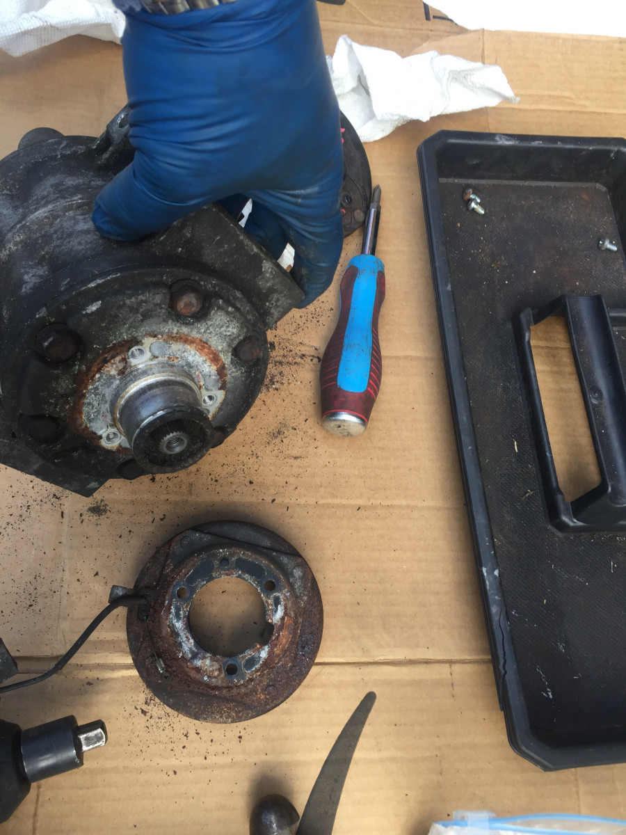

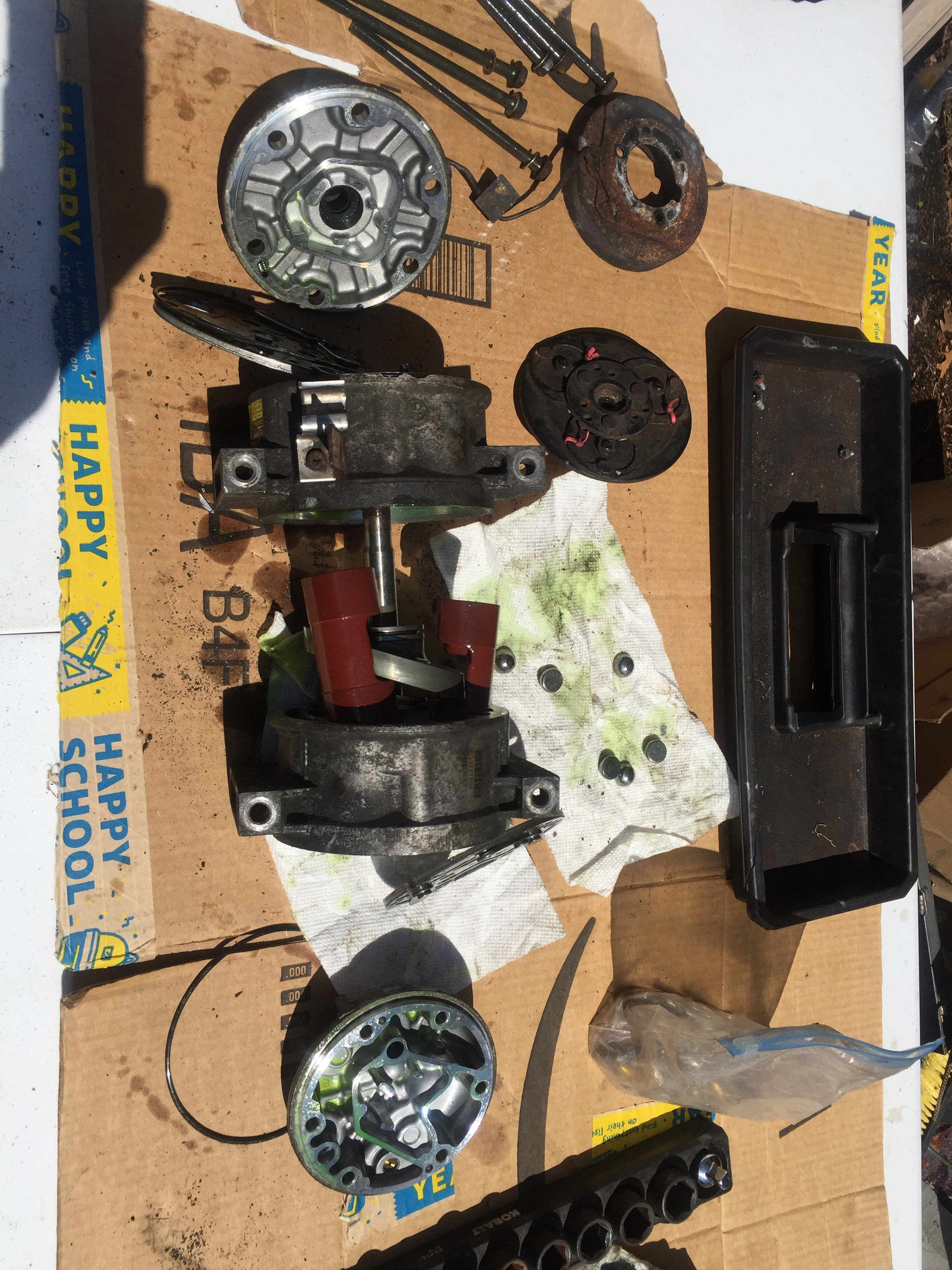

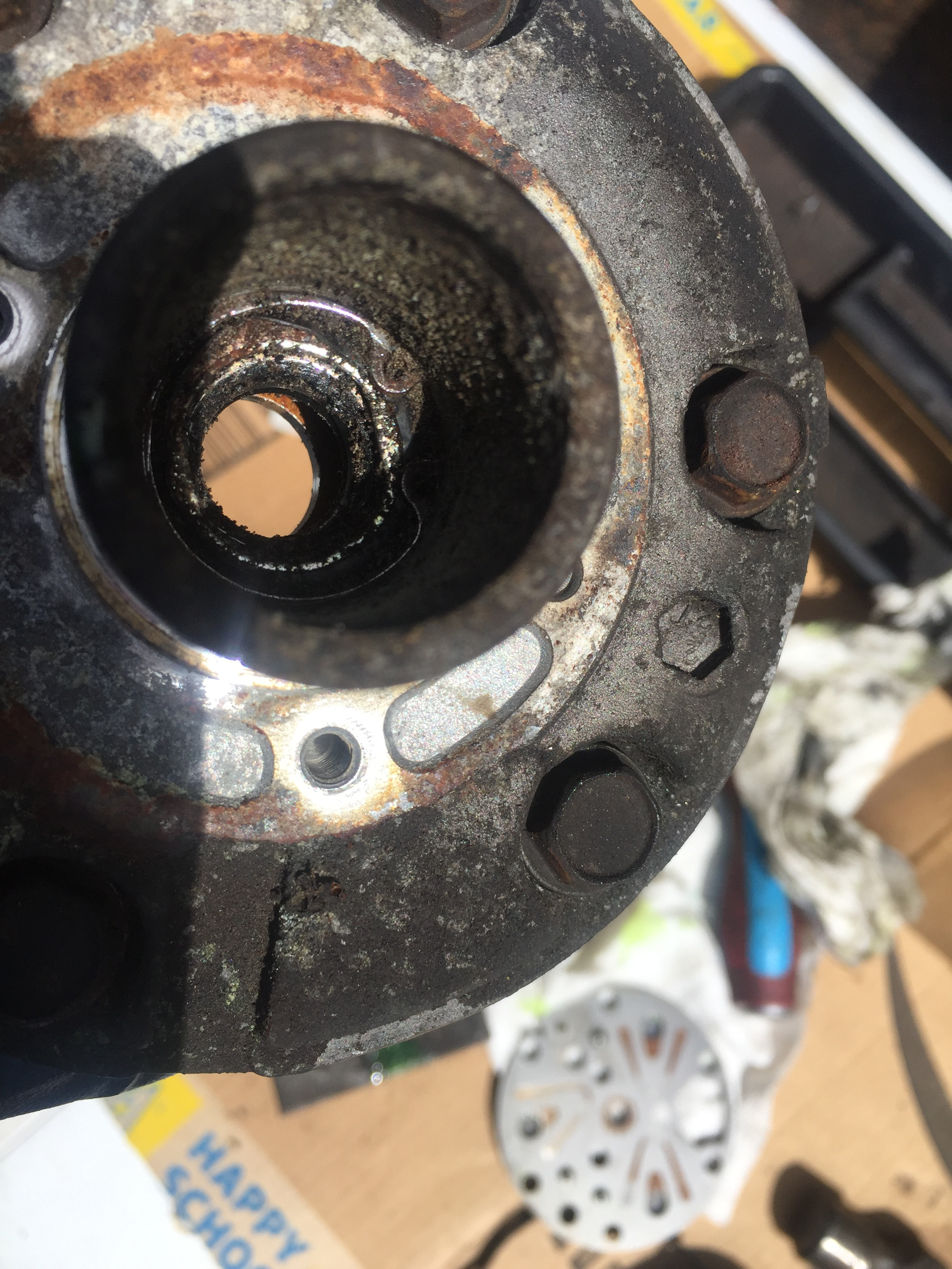

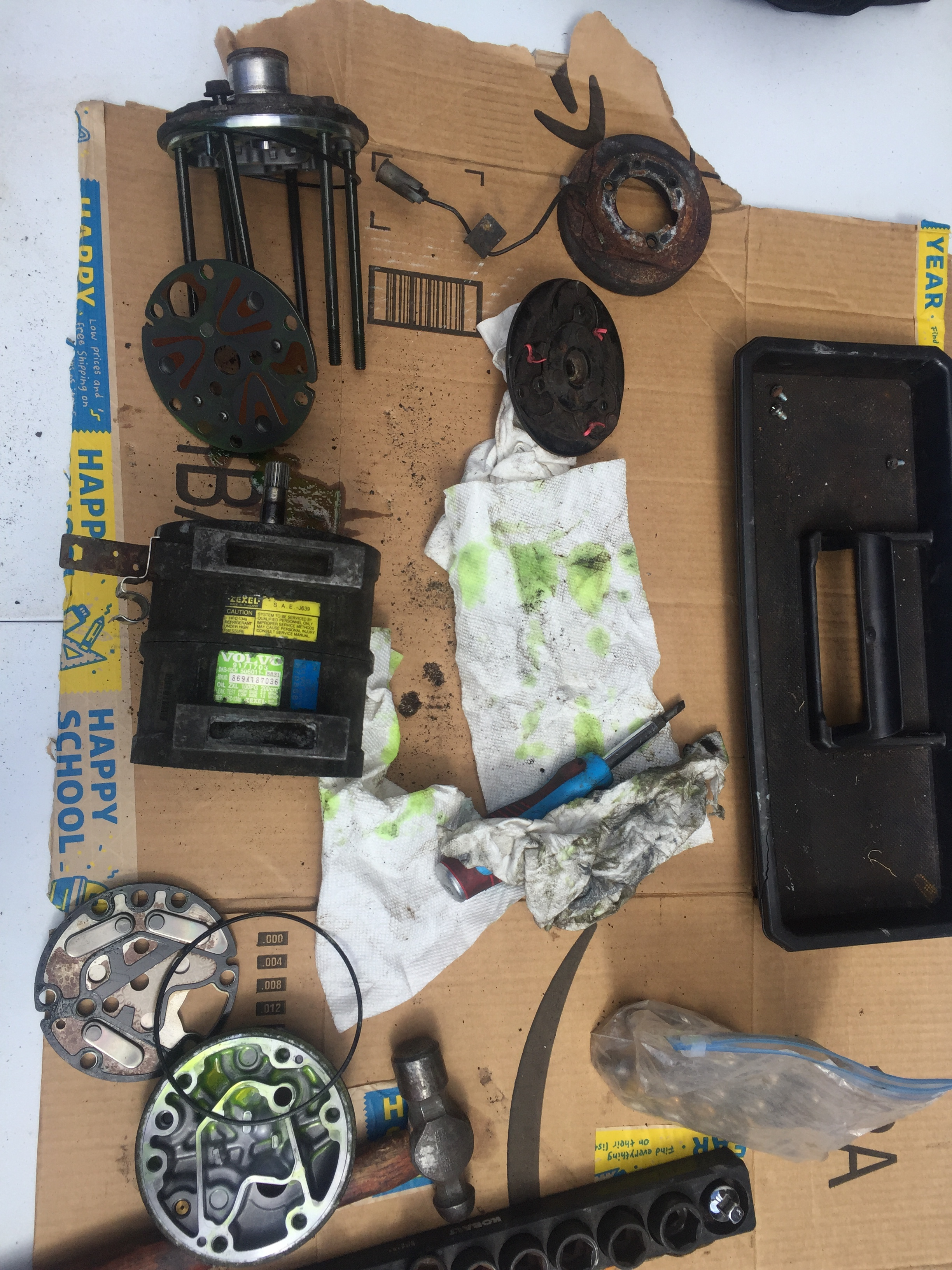

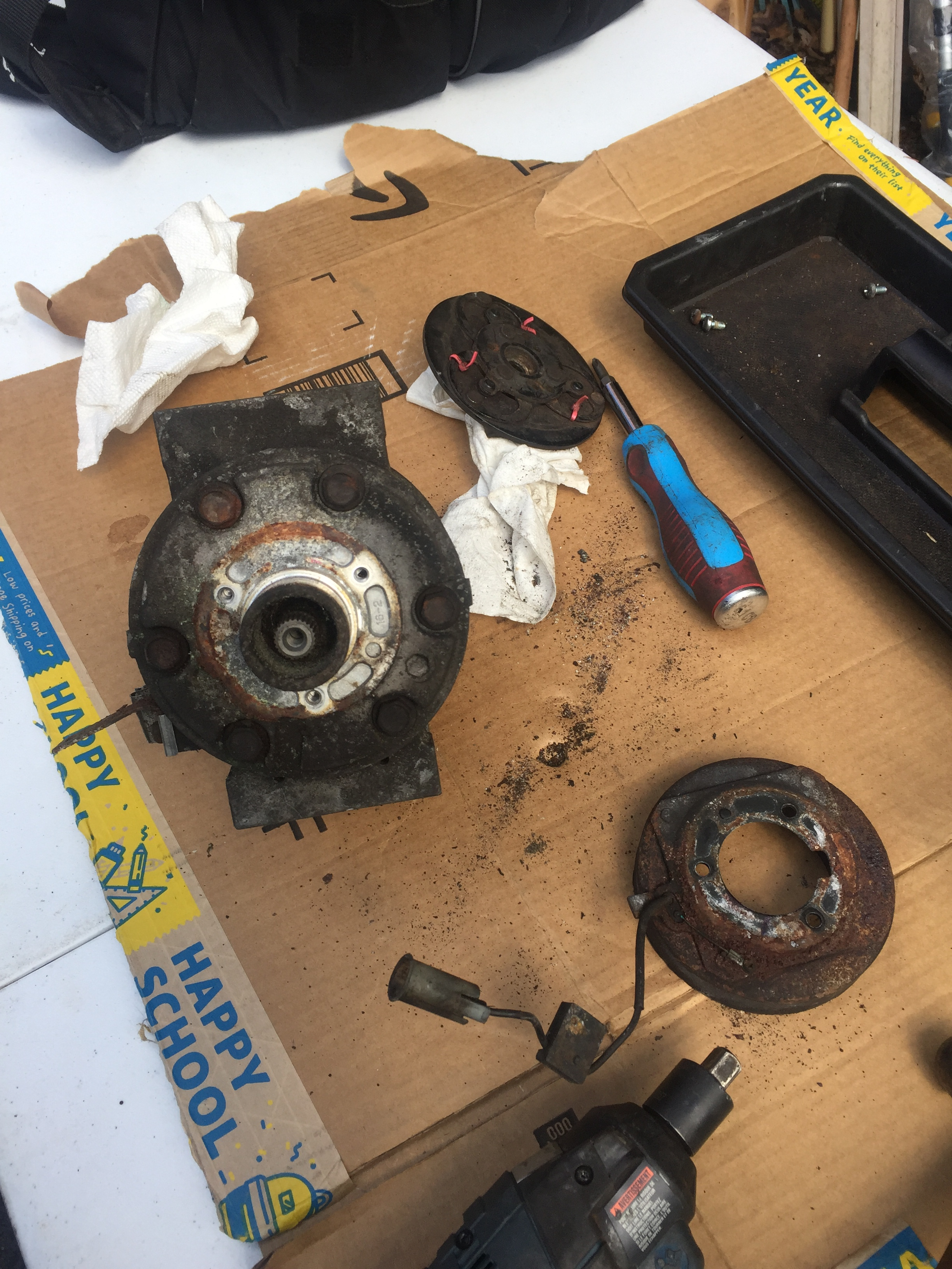

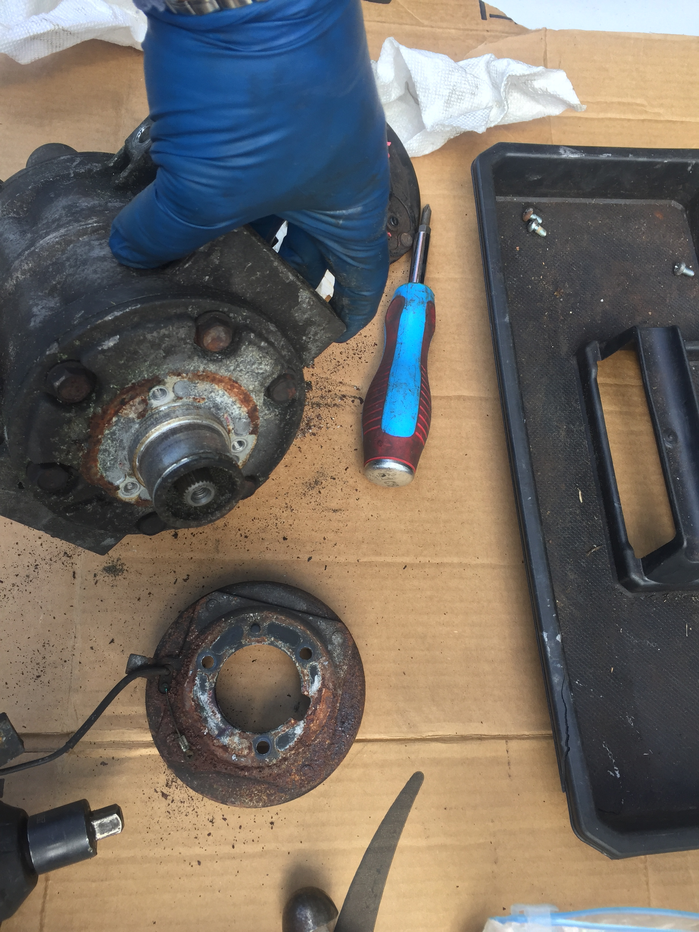

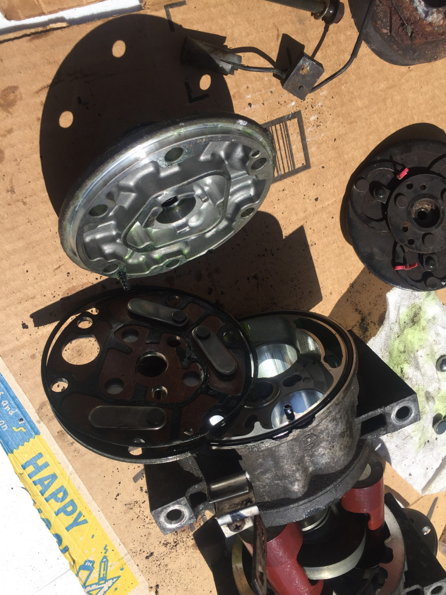

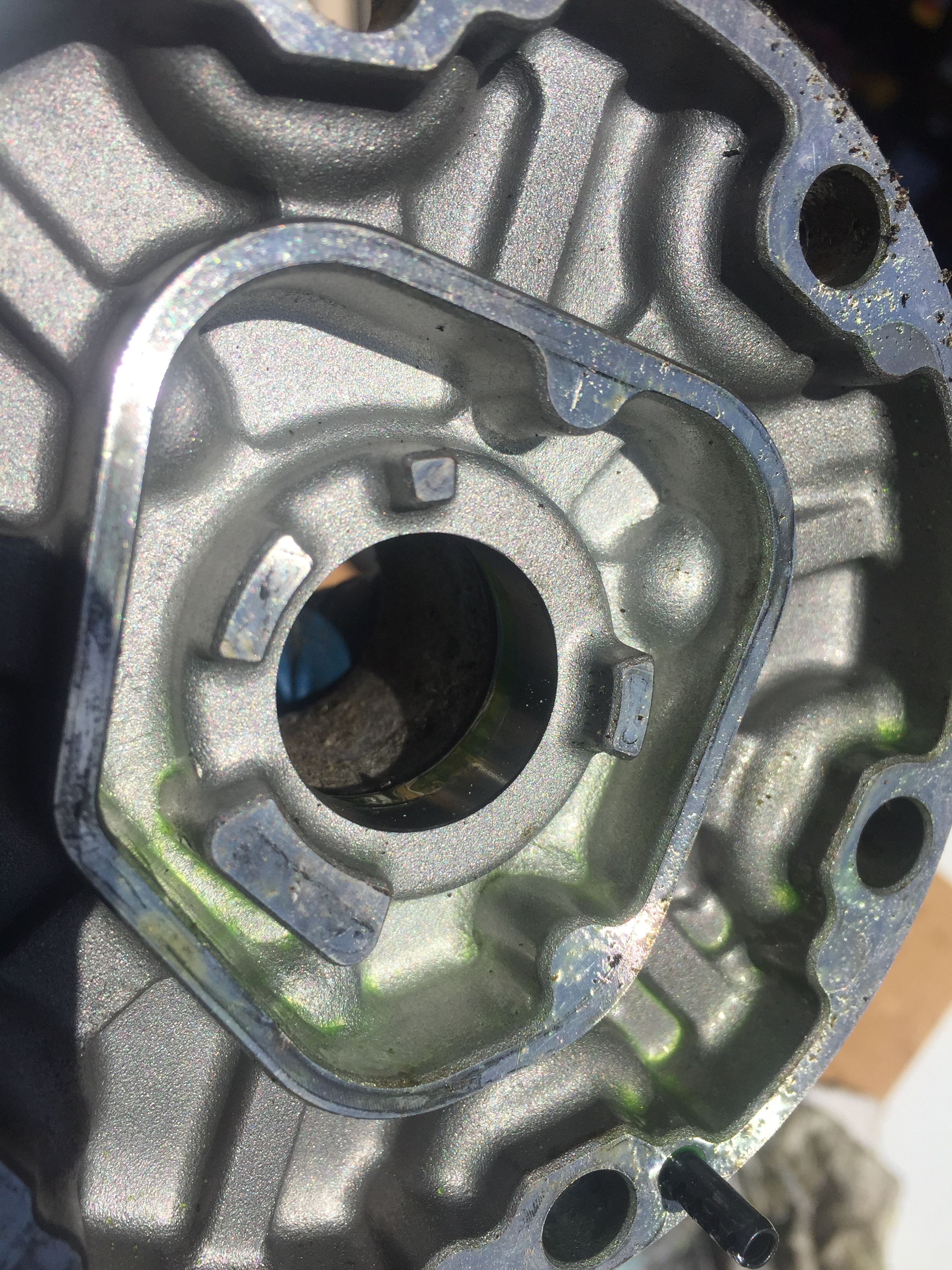

After removal of the clutch and magnet, 6 m8 (12 mm head) bolts hold the four pieces together

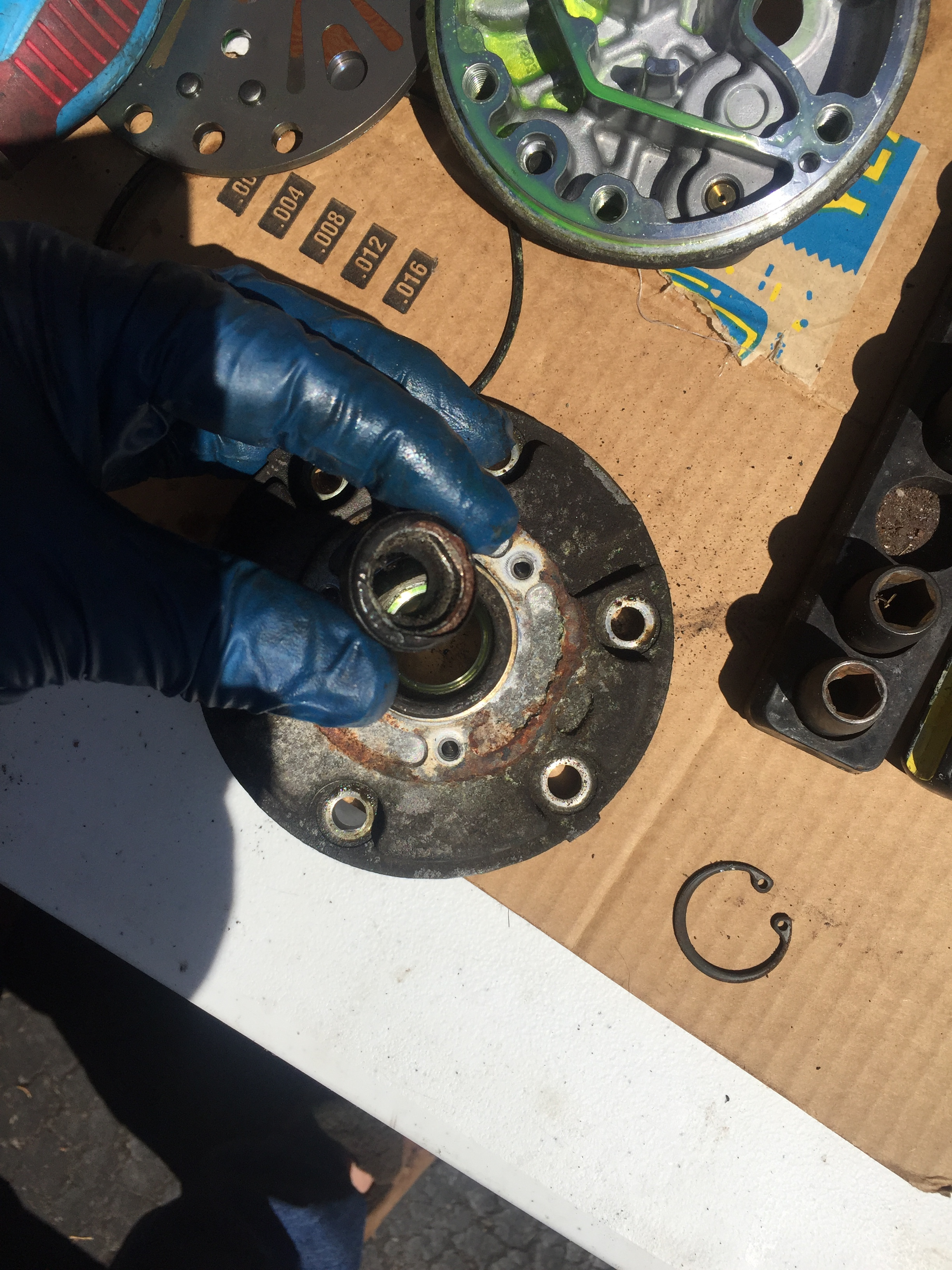

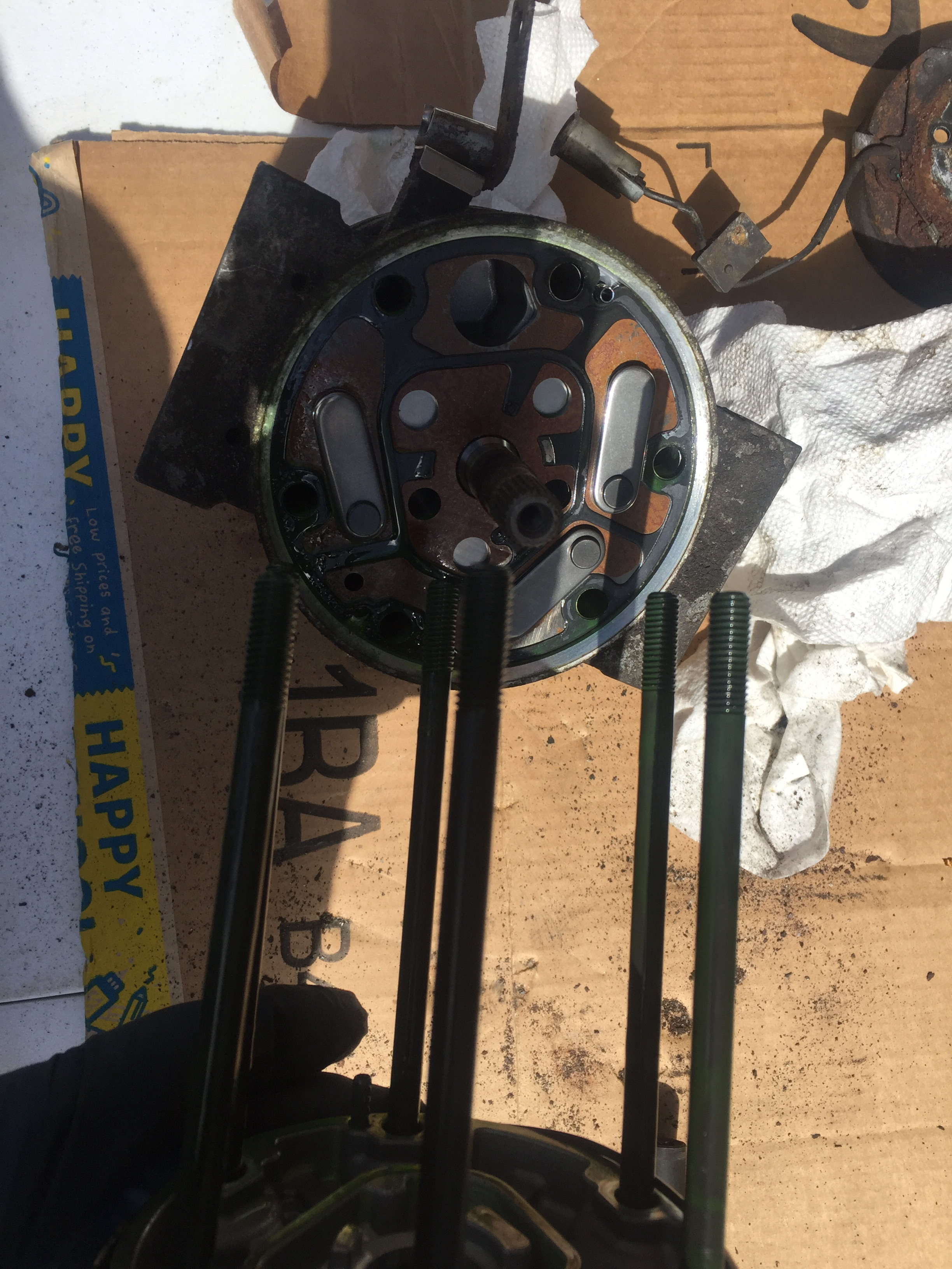

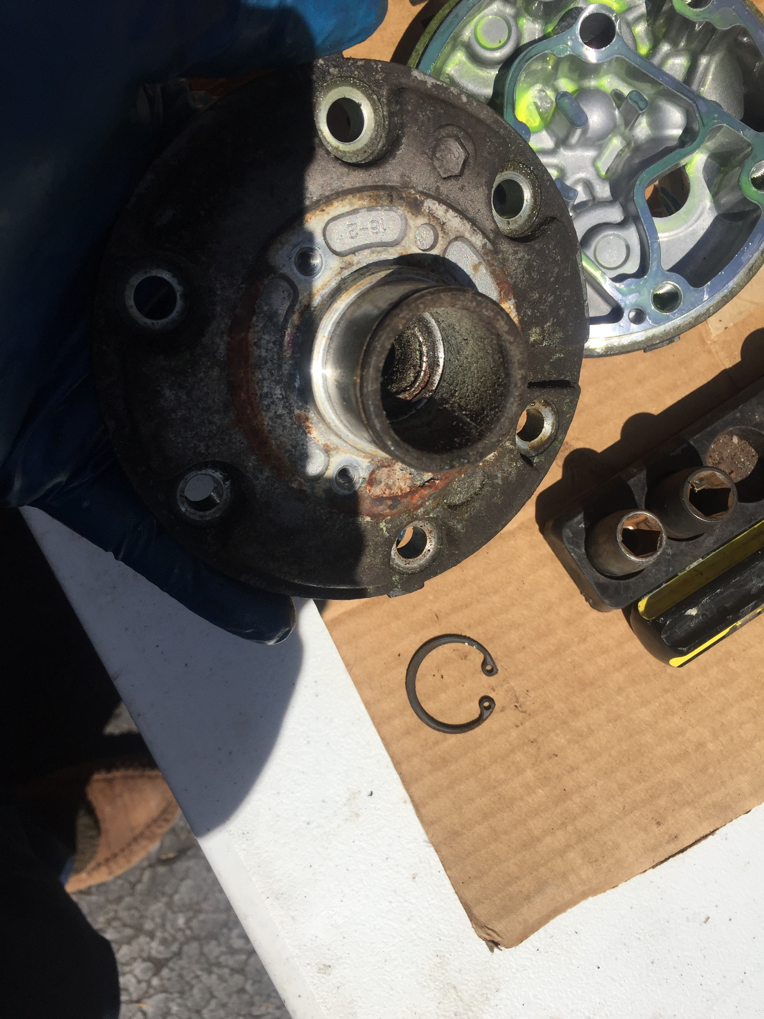

Front cap

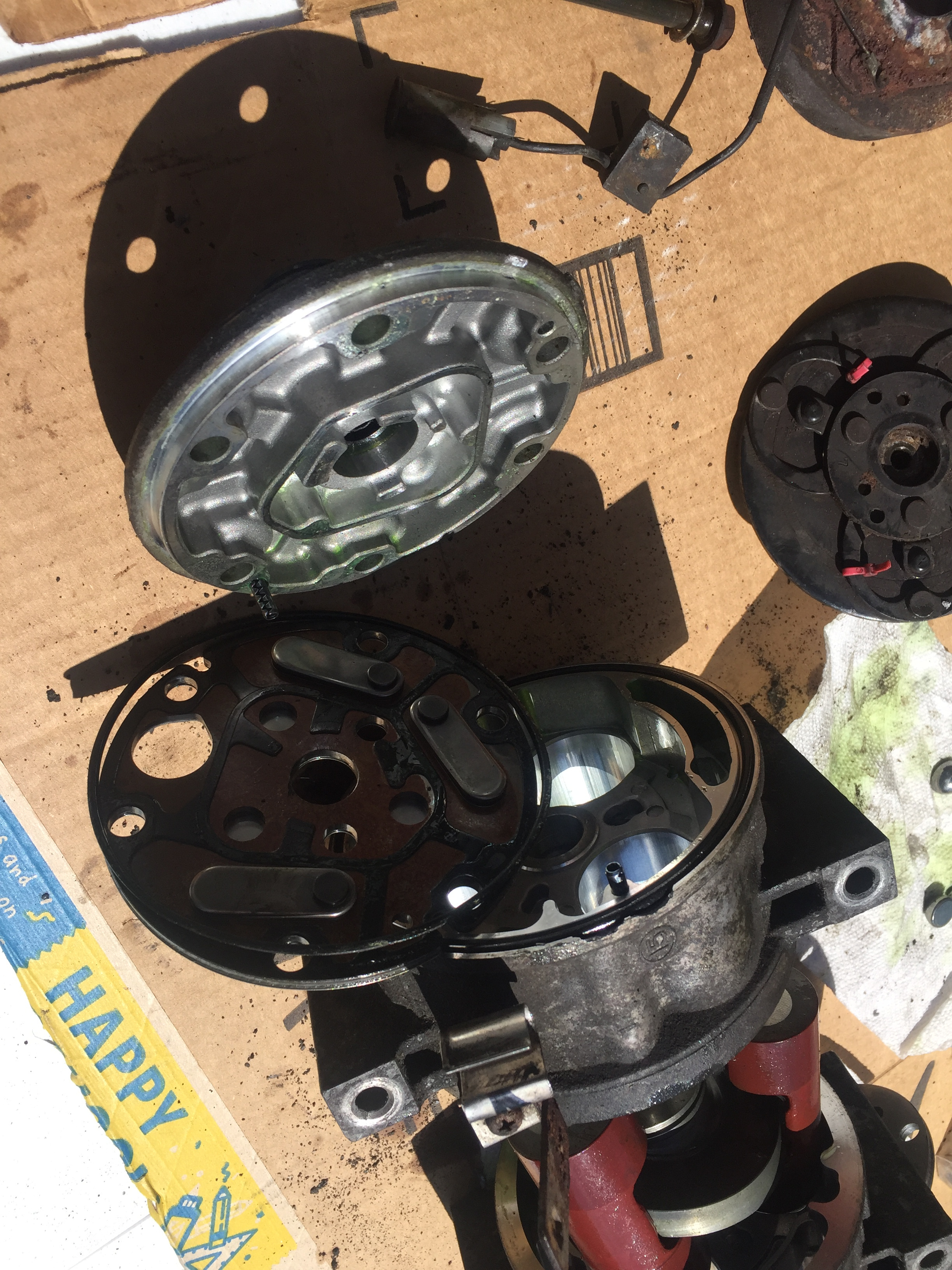

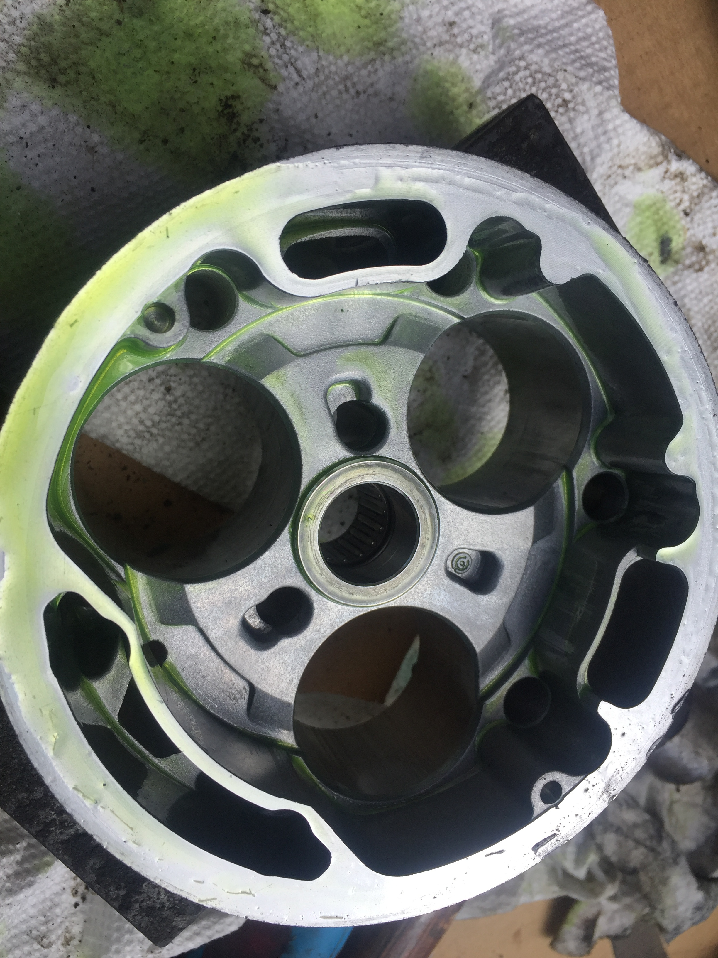

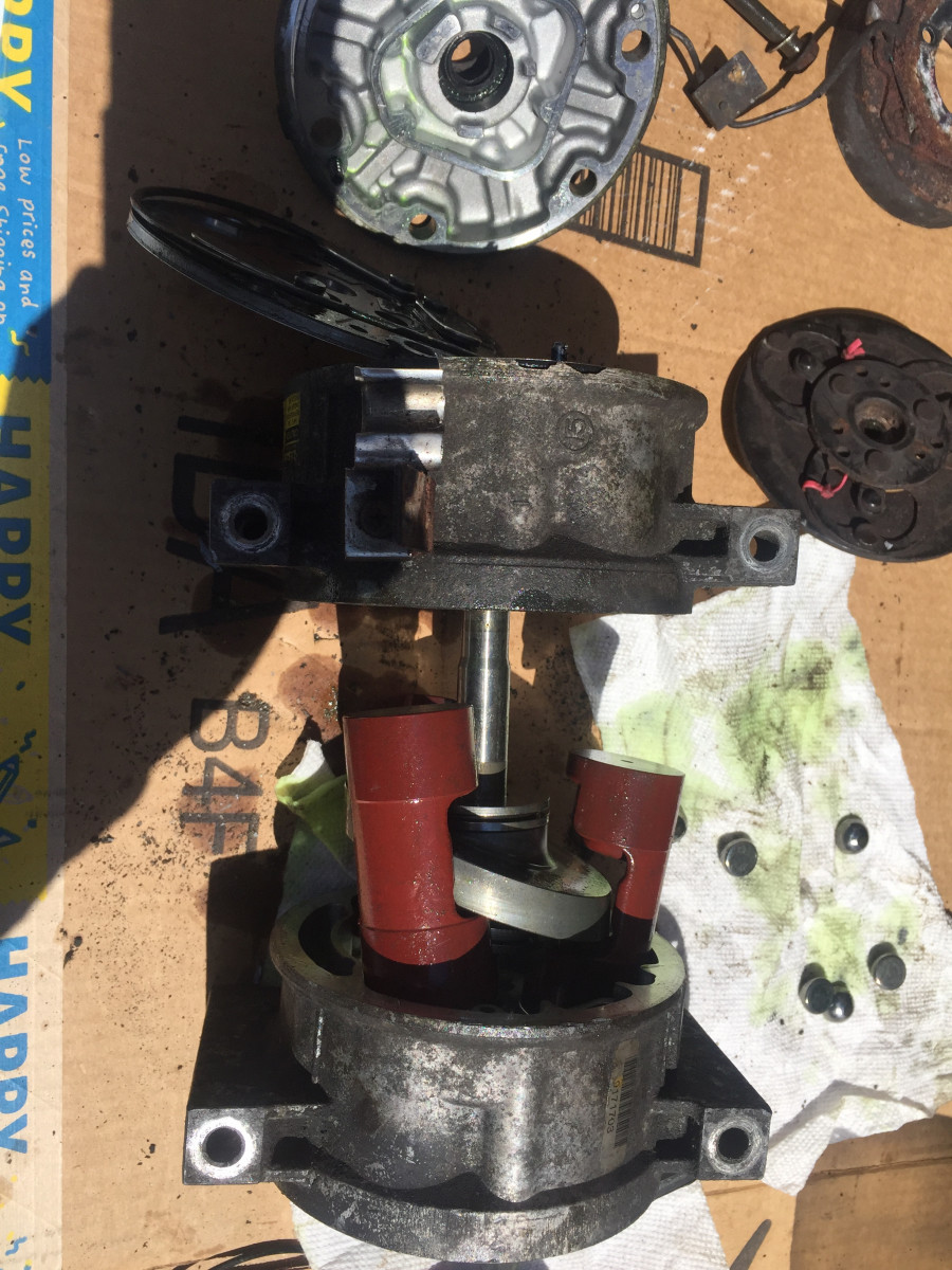

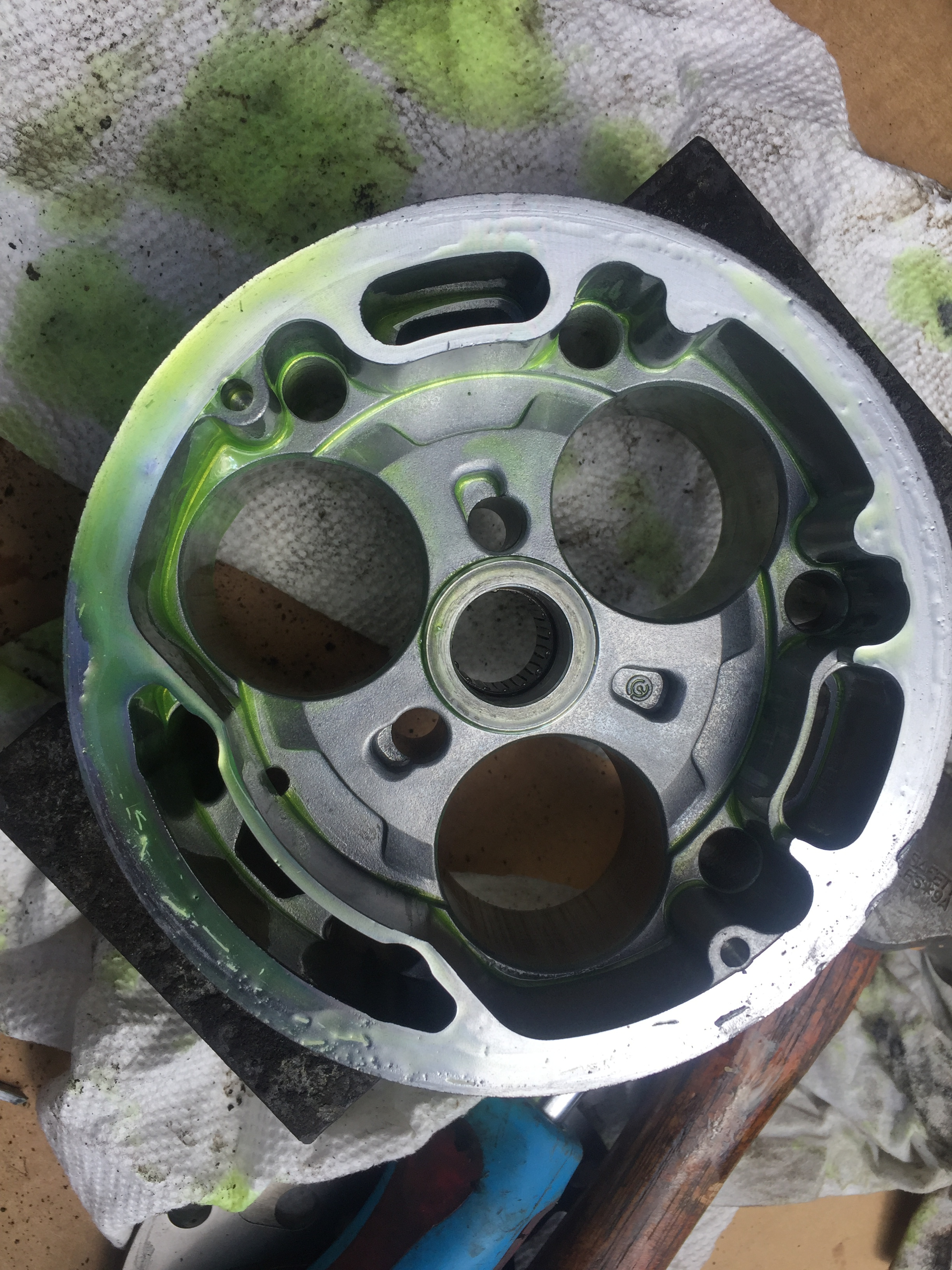

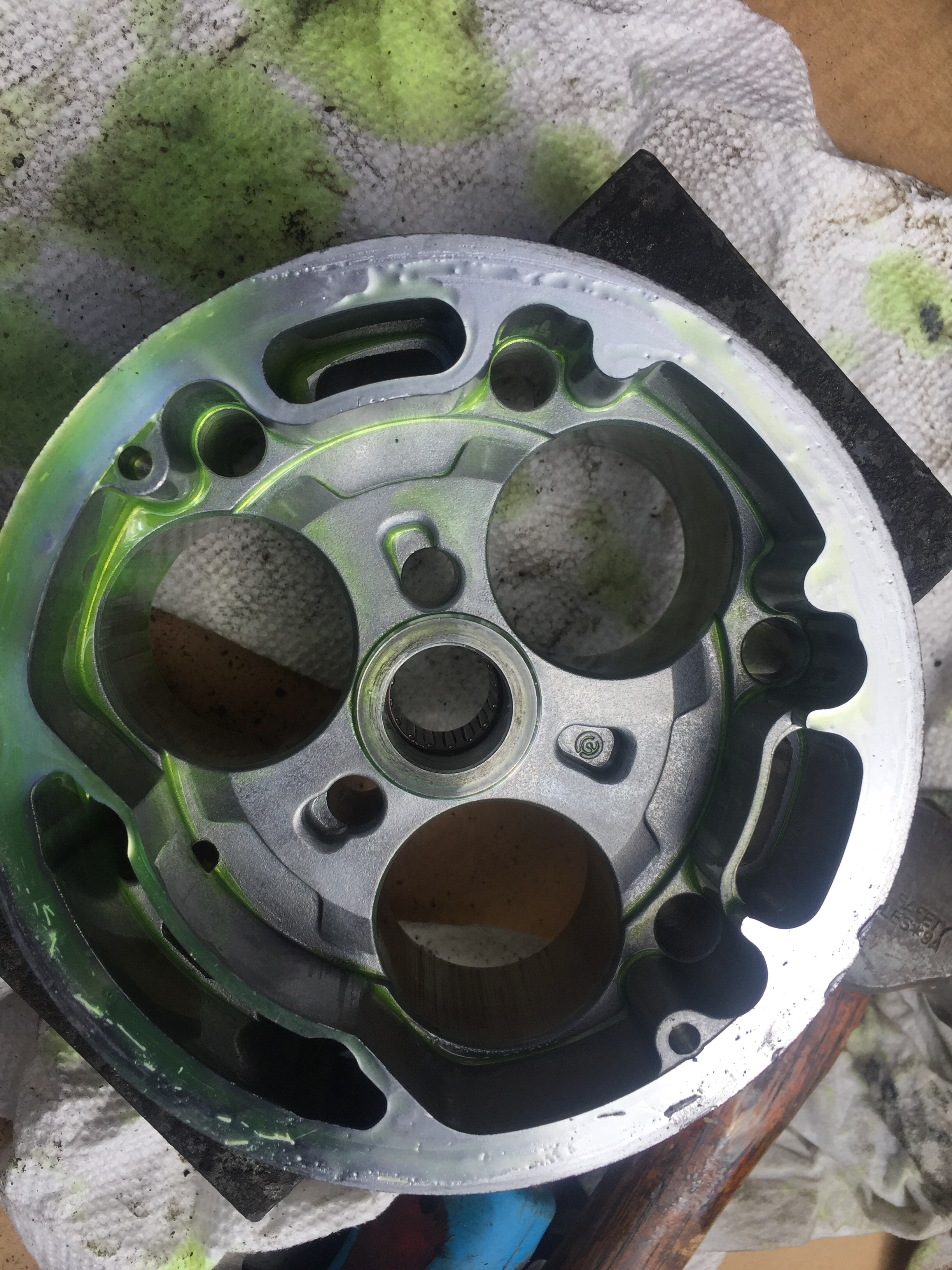

Body half one
Body half two

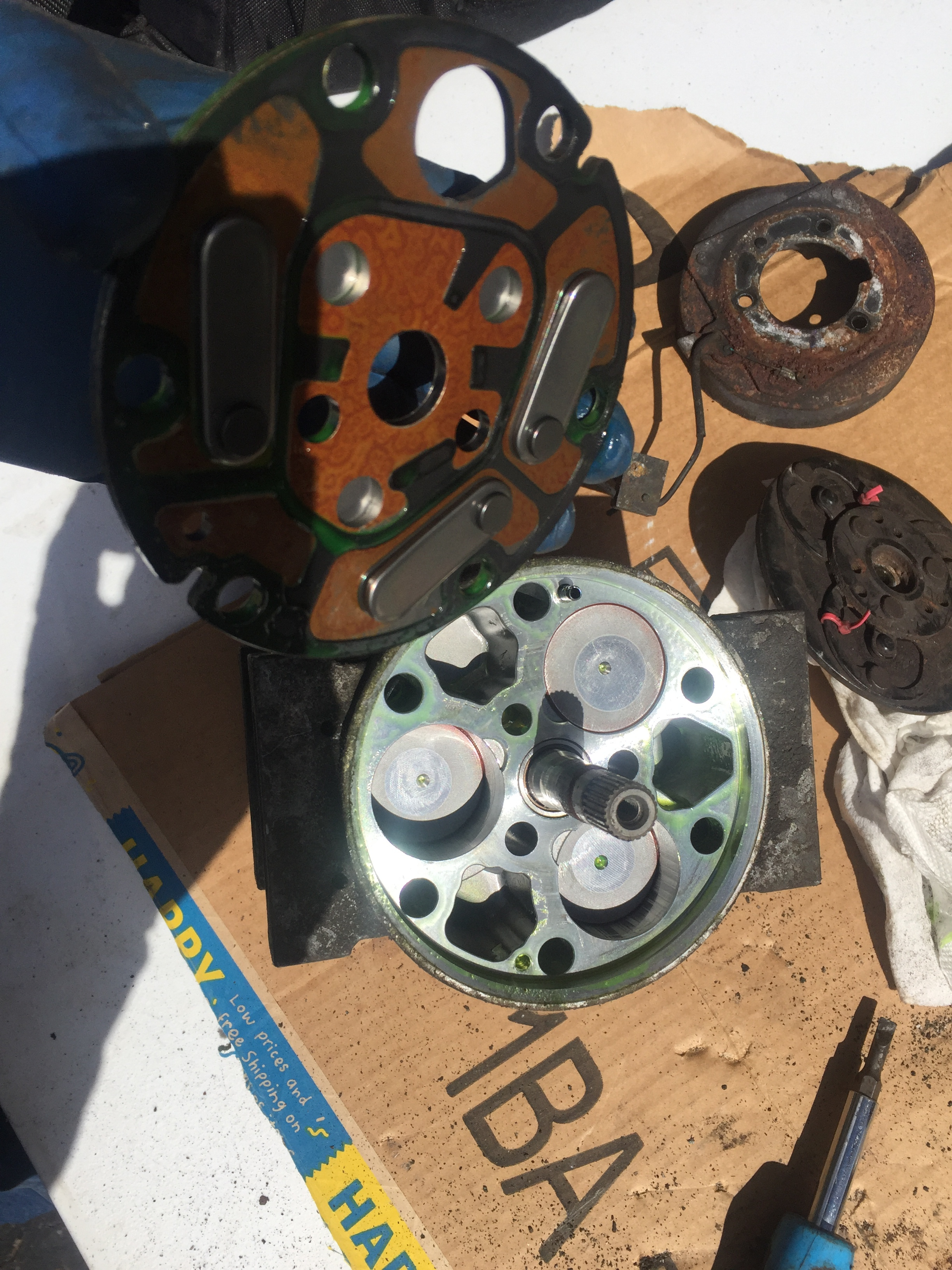

Rear cap

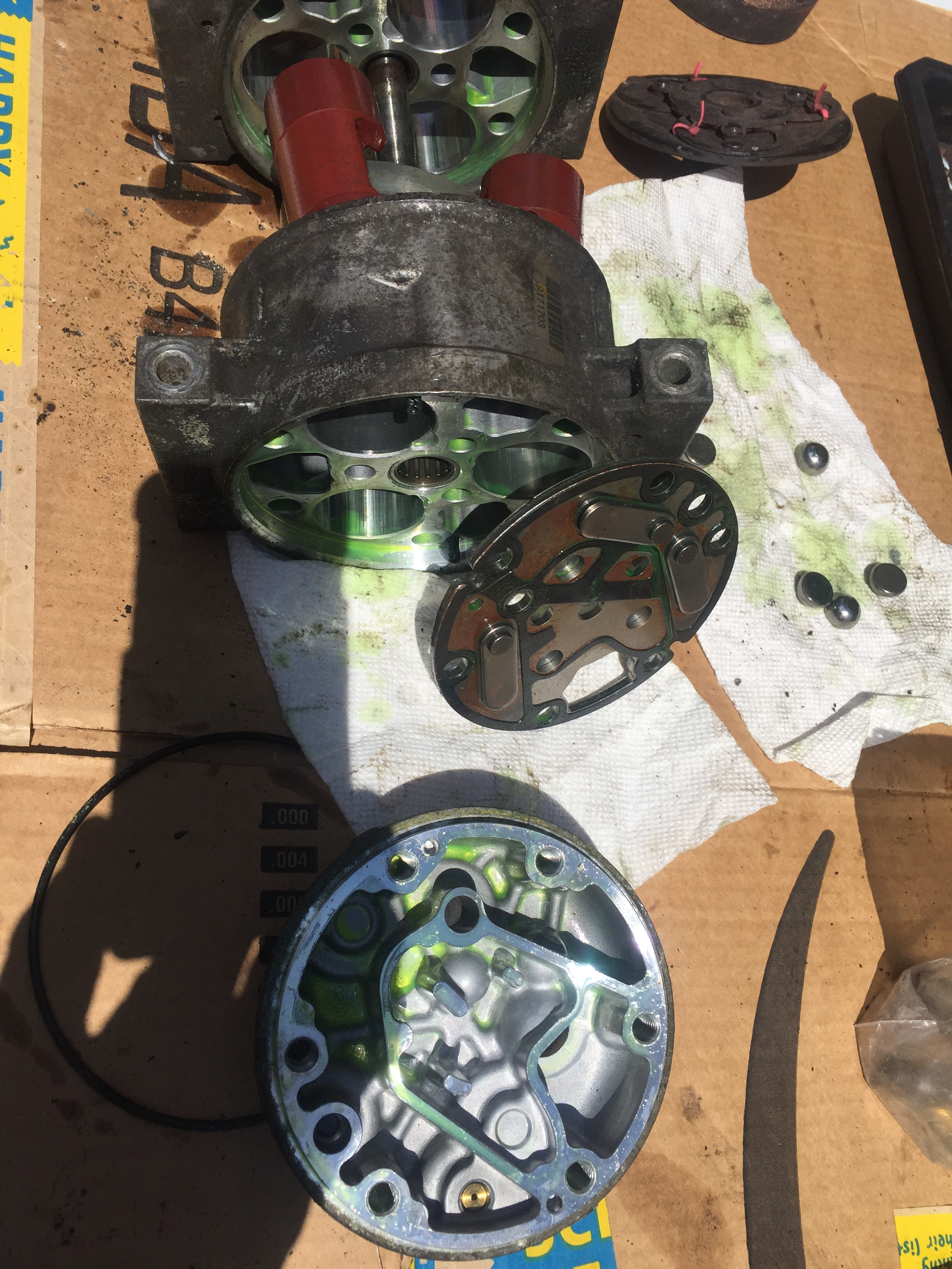

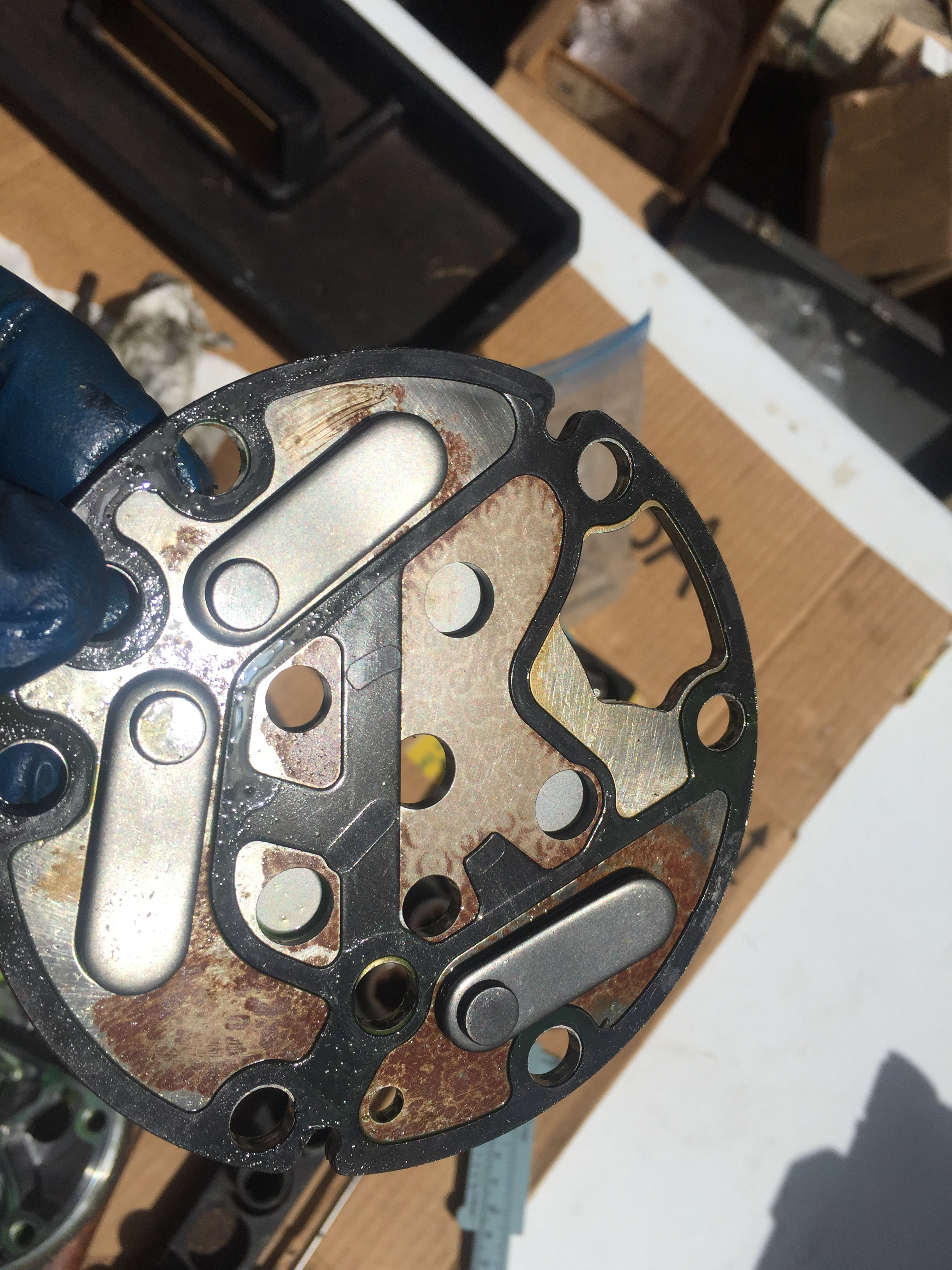

Two reed valve assemblies live in each cap end

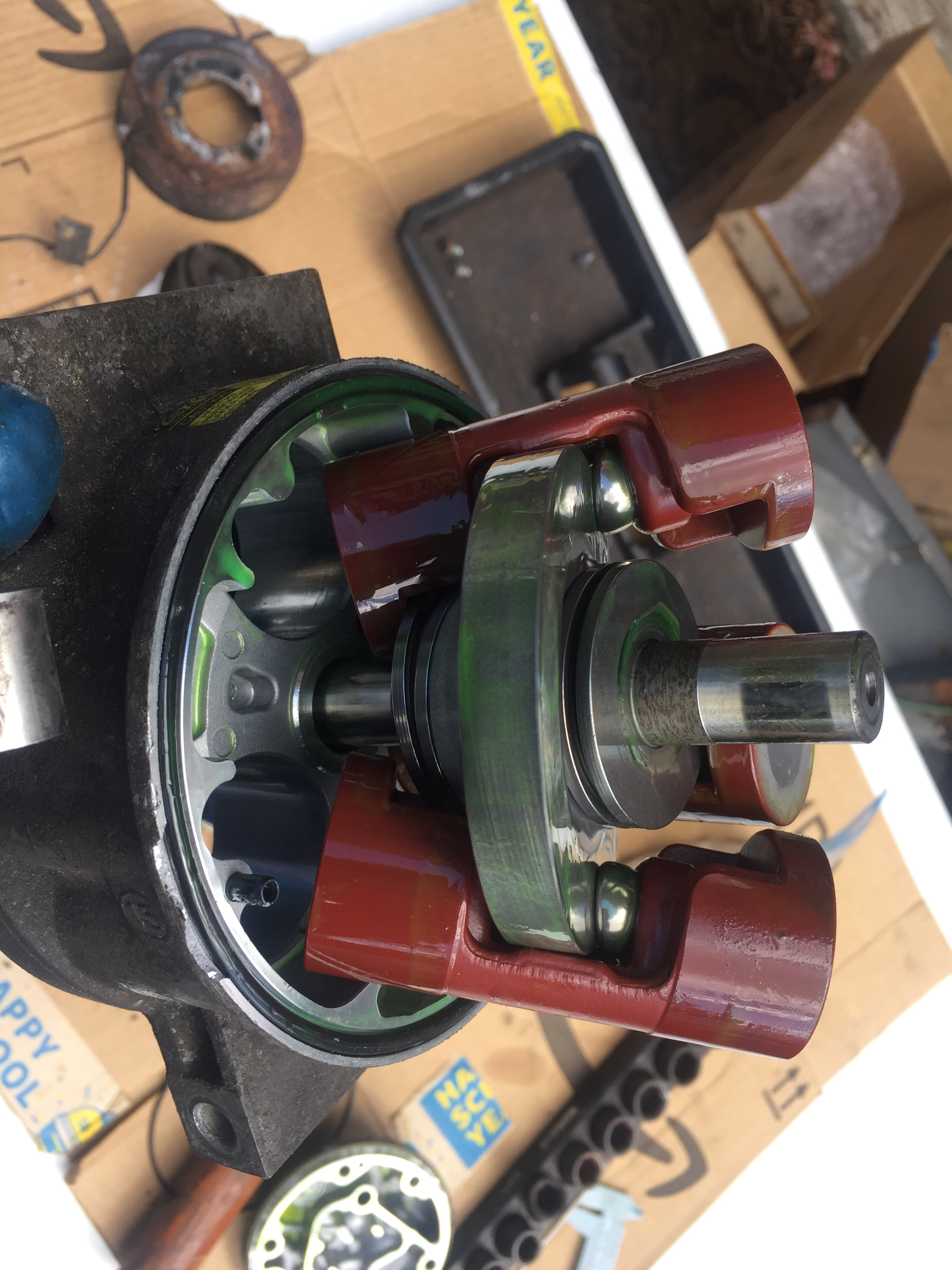

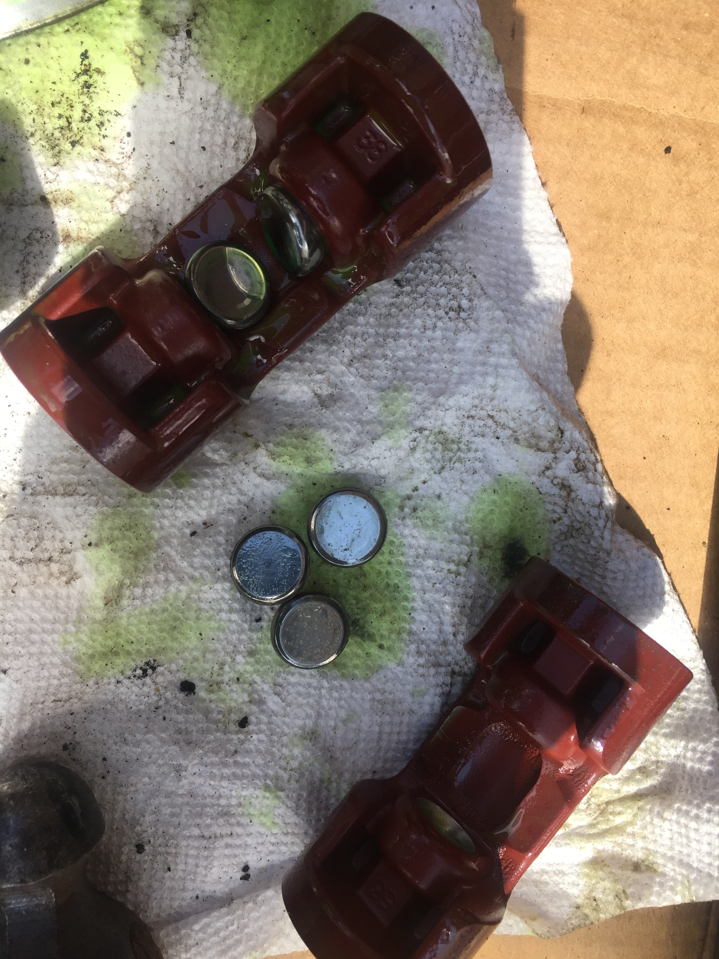

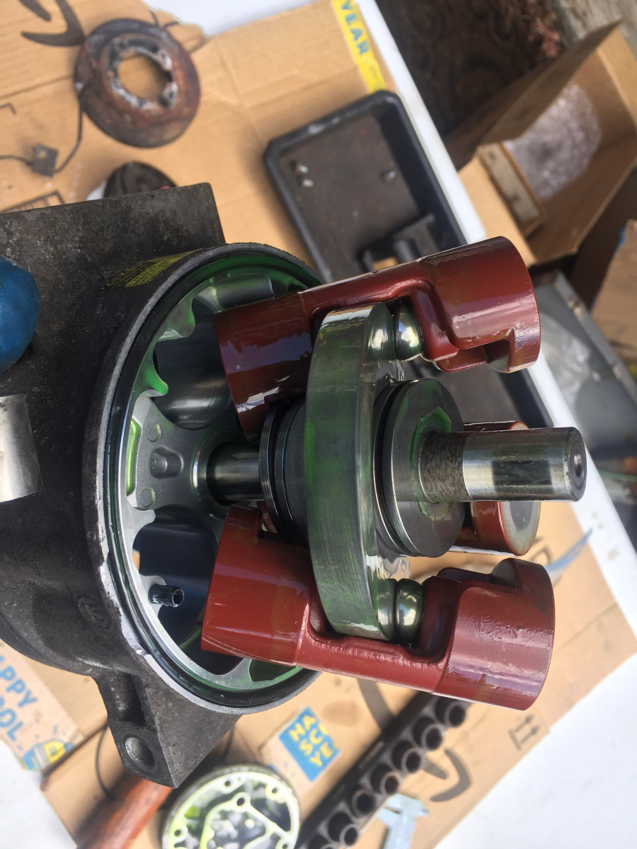

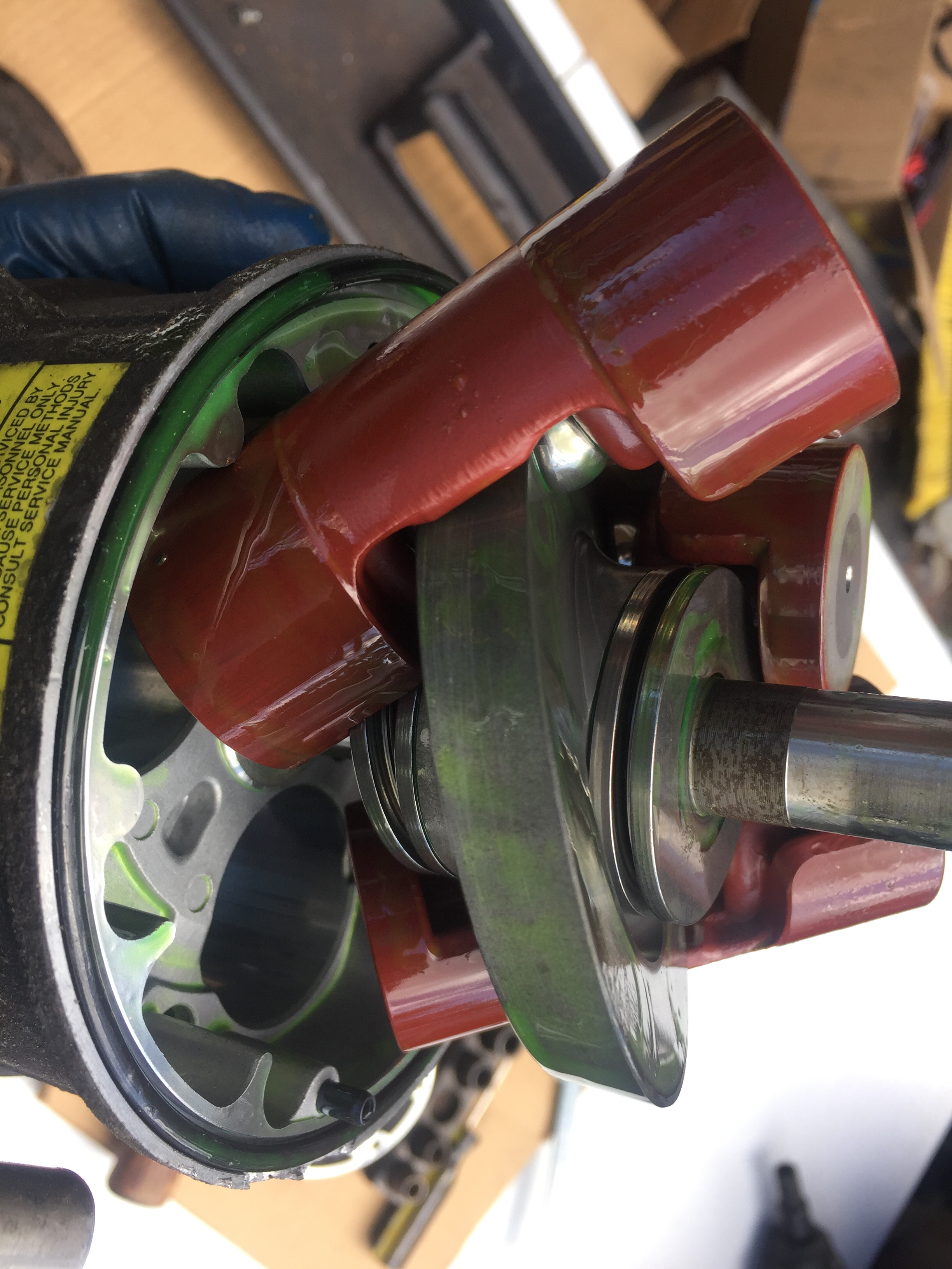

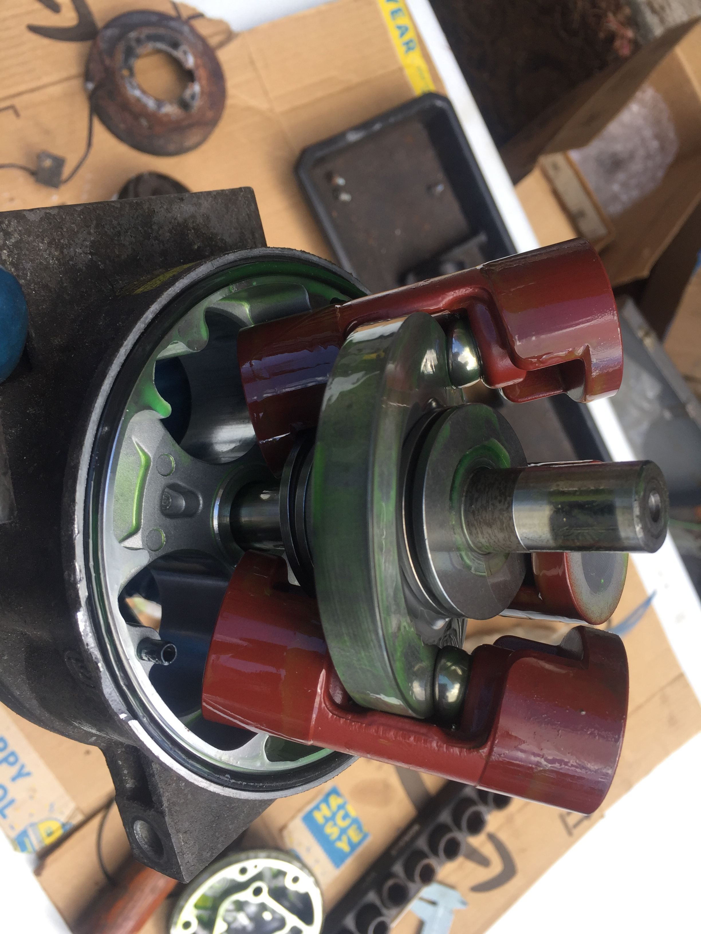

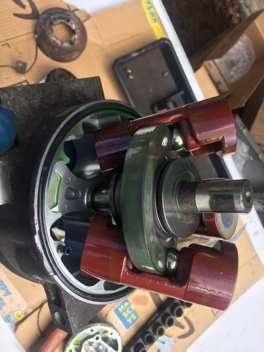

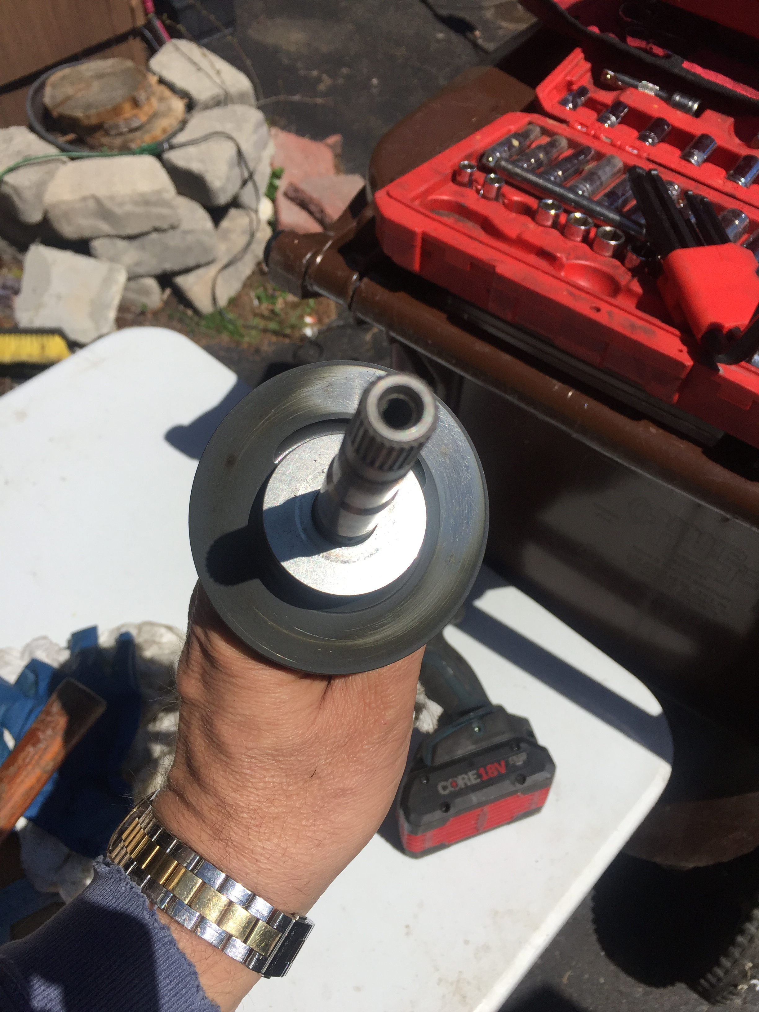

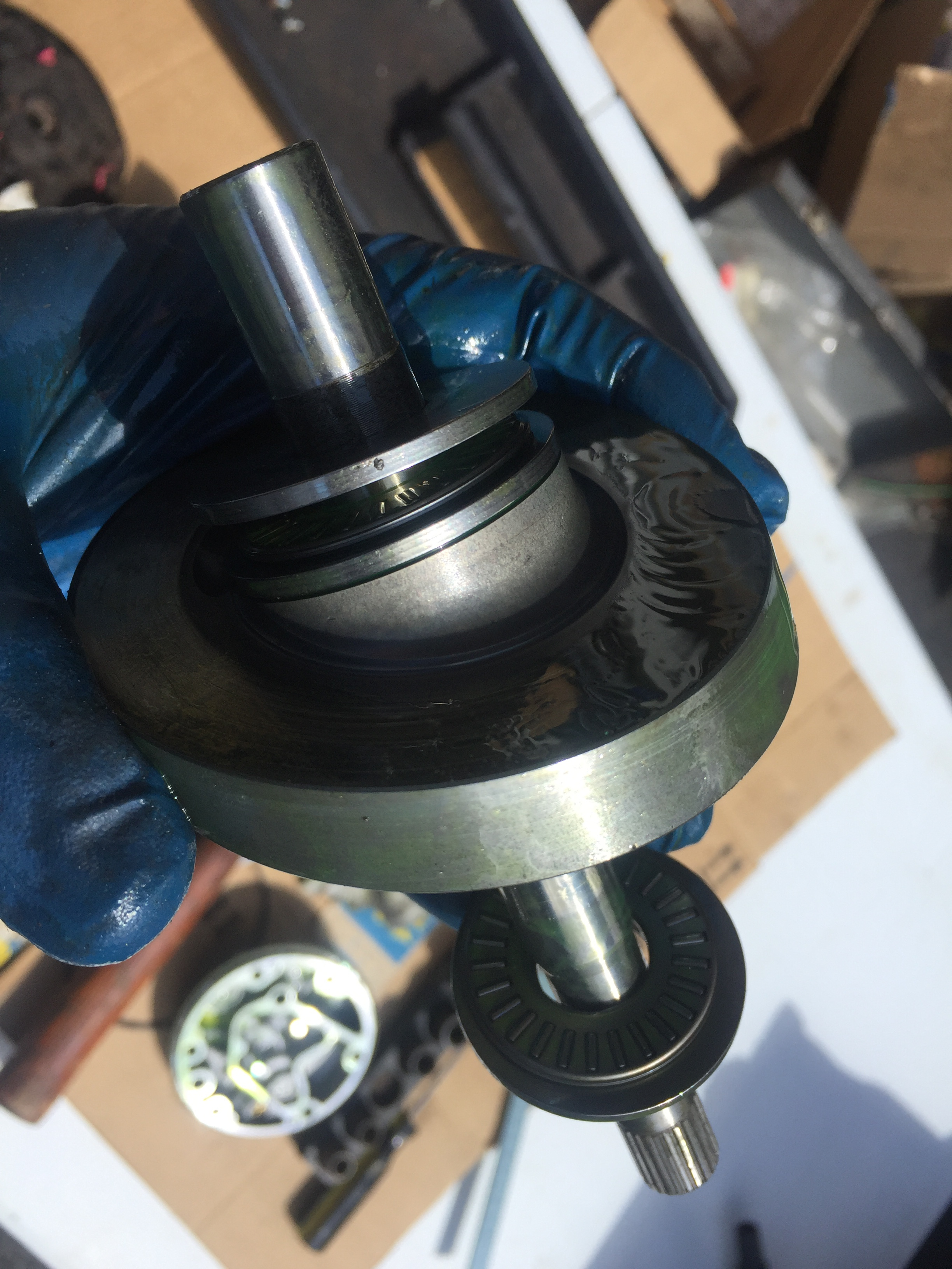

Bakelite pistons ride in the cylinders in each body half, they have semi spherical metal bearing on top and bottom

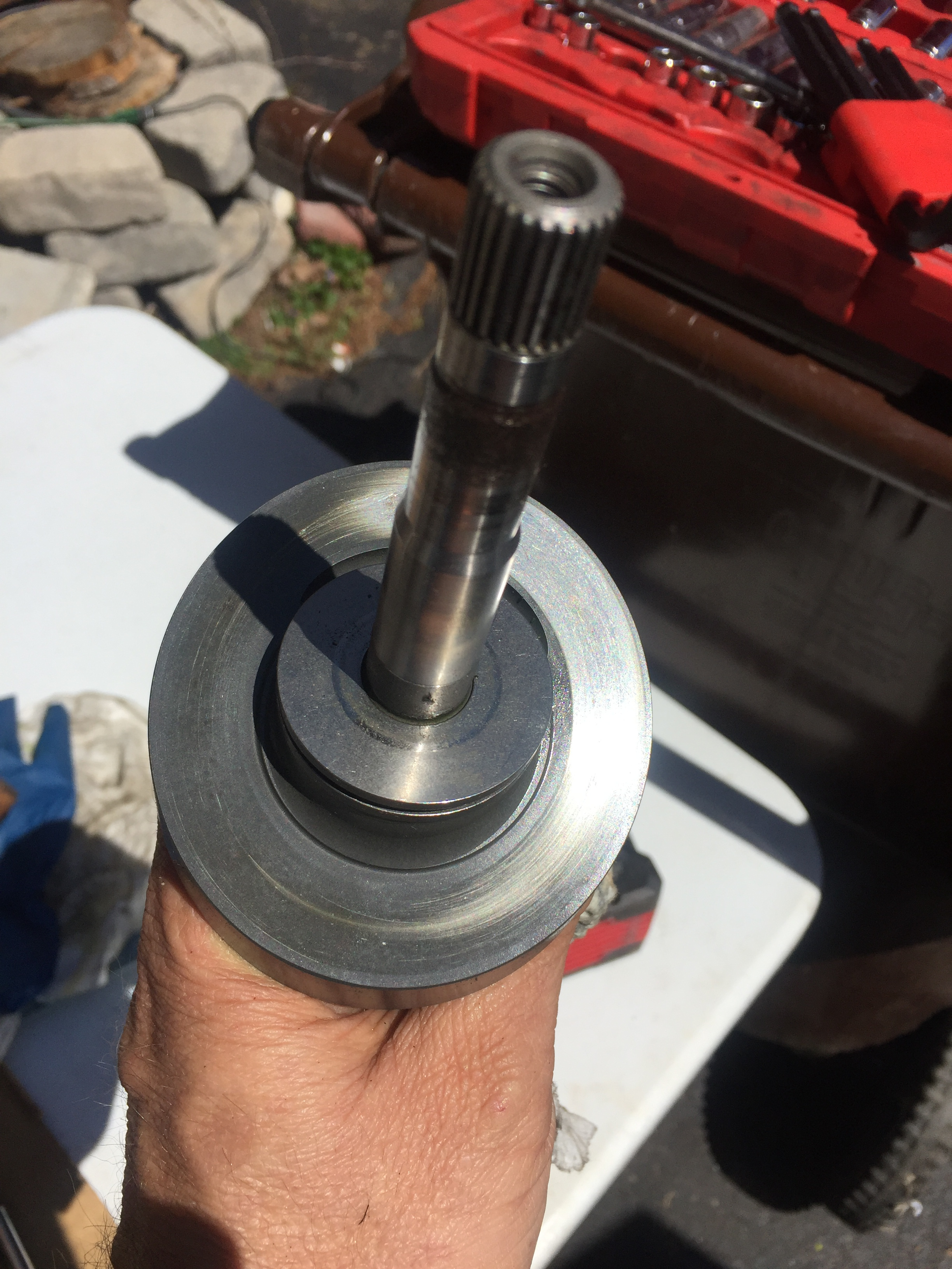

They are driven by the eccentric cam in the middle with axial float of the cam controlled by needle bearing, and radial by a rear bearing on the rear plate and a bushing/seal in the front plate

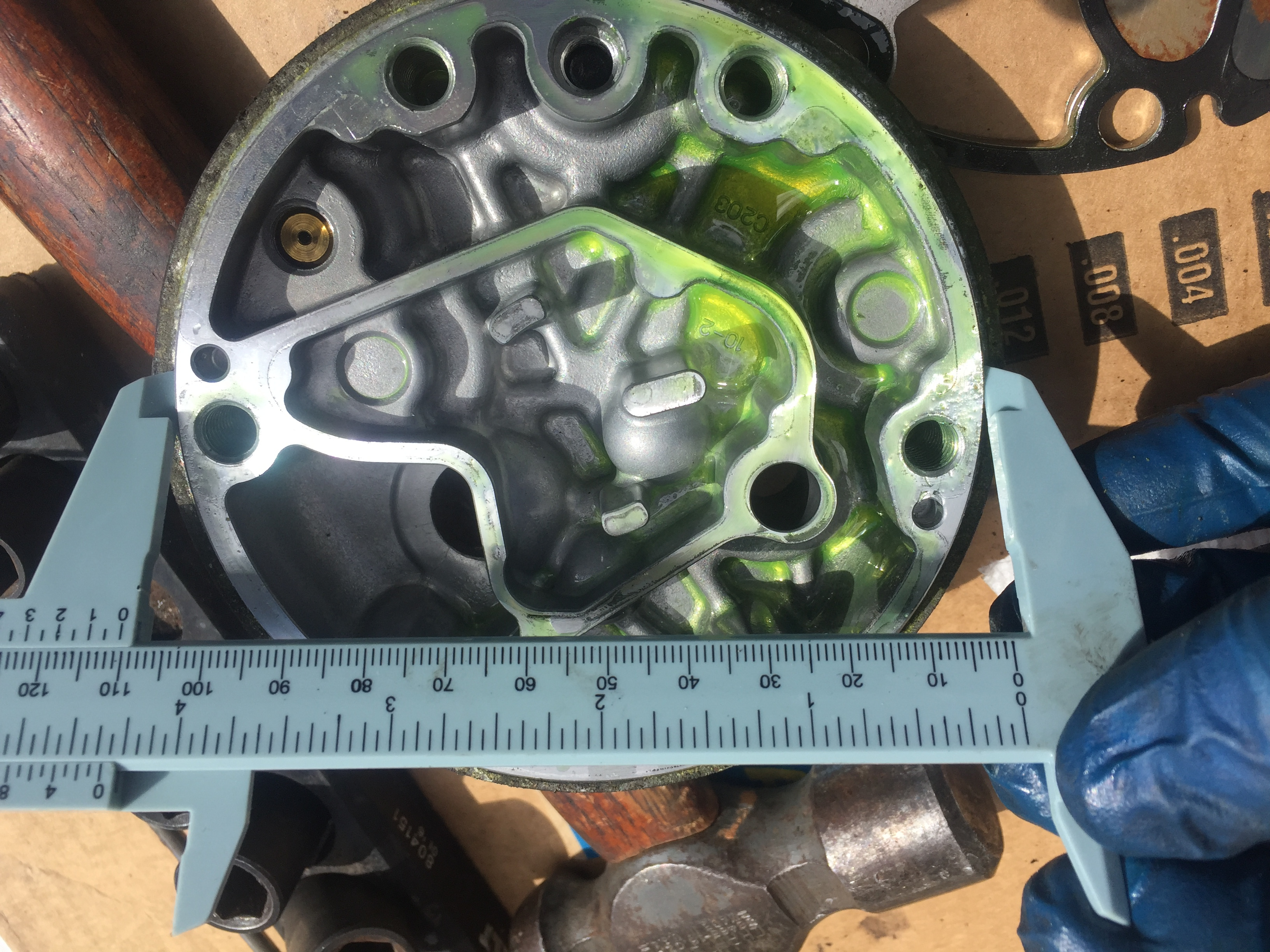

Needed refurb parts...110 x2 mm oring for the caps and body
Front bushing, that will be a pain to find I bet

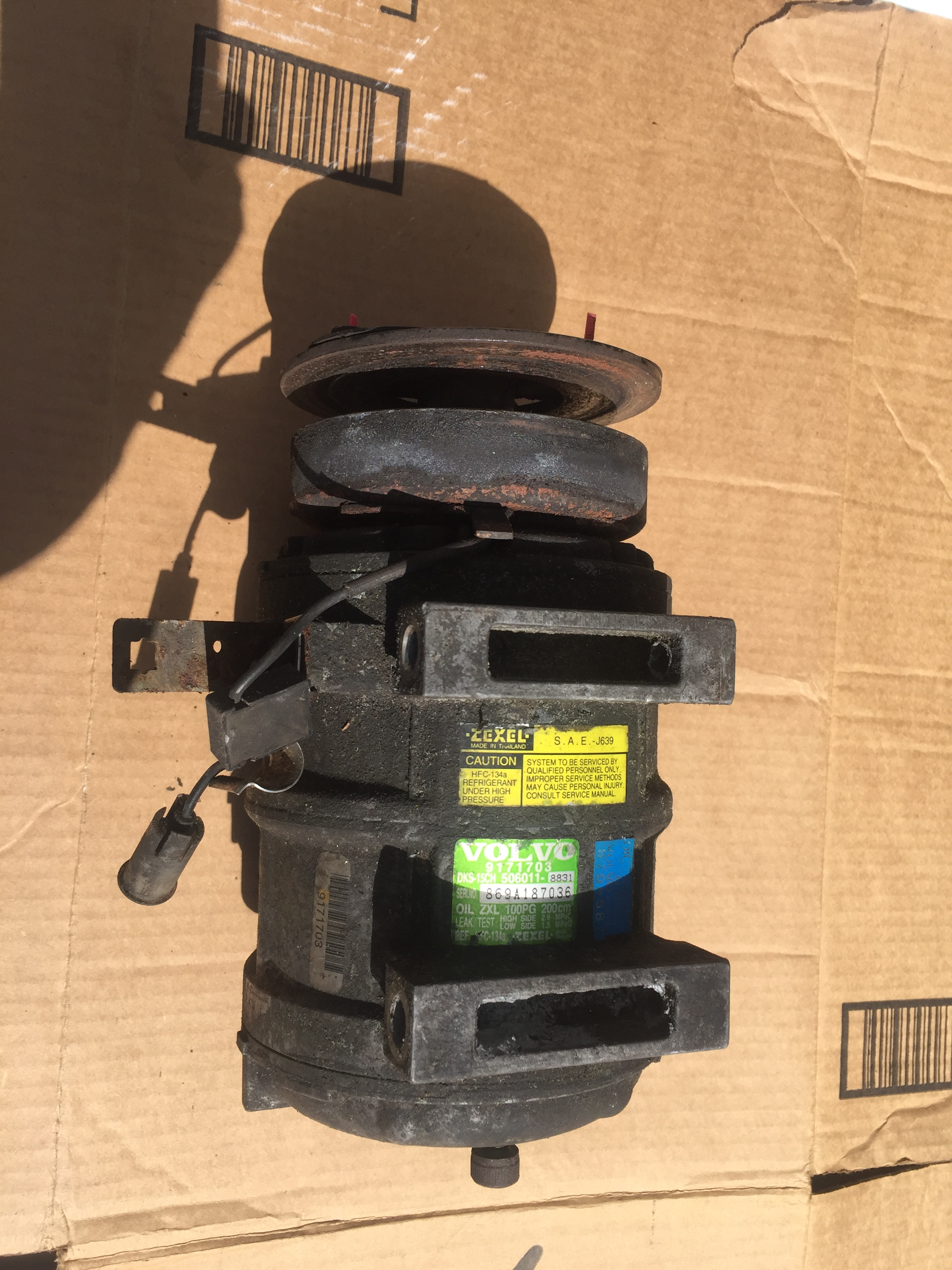

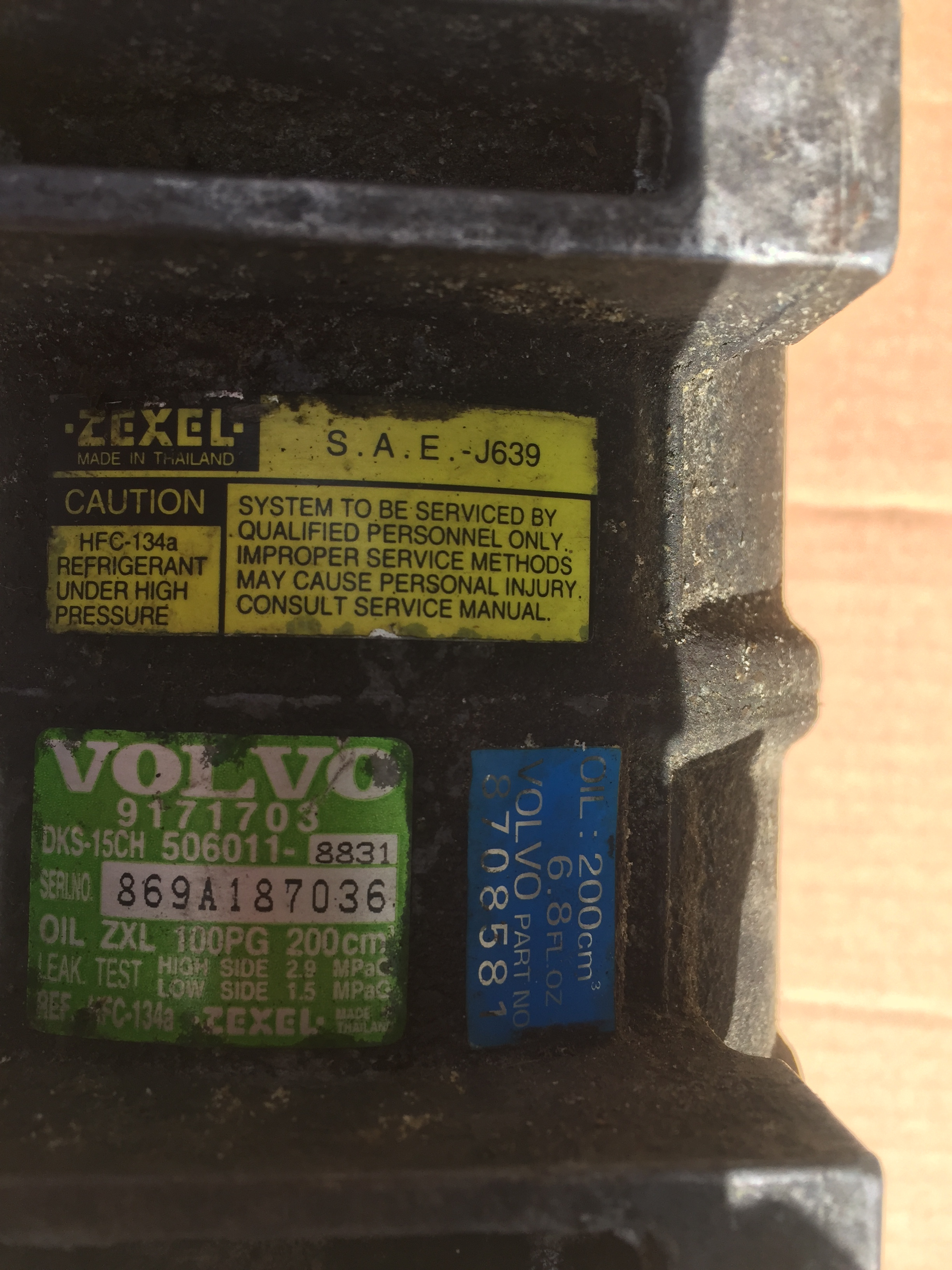

Corona bench tear down, autopsy of,a 1999 9171703 AC compressor

THis one was dead so I knocked it down
It looks tough to source parts although I did find the front seal at Volvo web store
9171344 $47
Someone sourced the clutch bearing orettty cheap too, will find
9171344 $47

Why do you need 110 x 2mm 'O' rings?
- Posts: 36137
- Been thanked: 4063 times
Big o-rings go between each body section and the two end plates seal it up.
These things are things of beauty inside. I can’t believe be how cheap they are, looking at the precision machining.

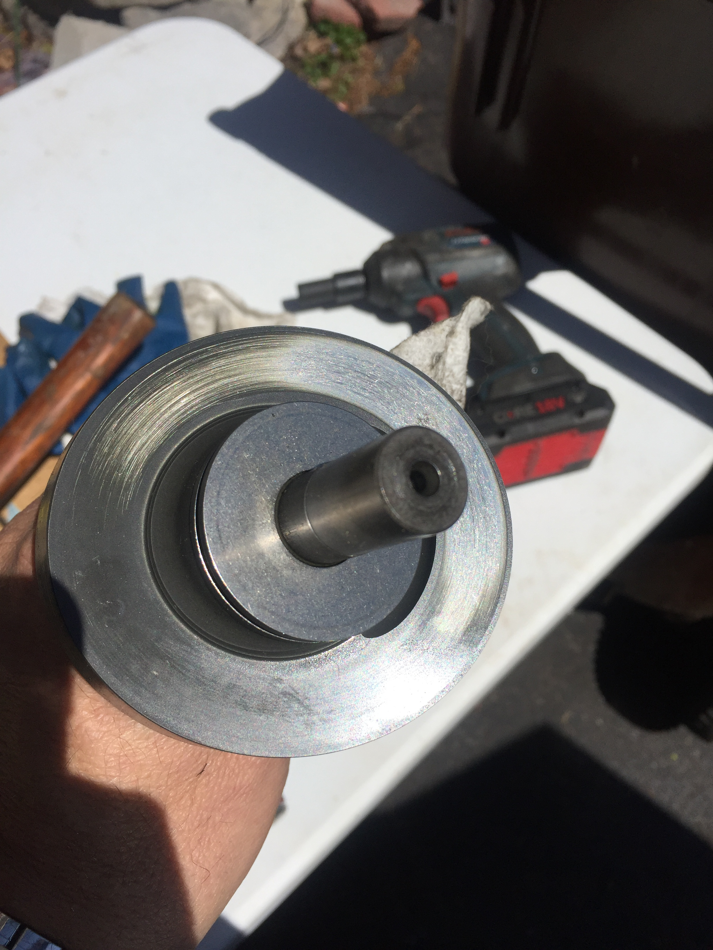

This type of design is often used on high pressure hydraulic pumps. It is called a swash plate design (the eccentric cam part in the middle). The hydraulic pumps are extremely close tolerances and do not tolerate any dirt. I have never seen one with front and back pistons.
How are the balls installed and removed? On hydraulic pumps, a foot with spherical bearing is held by pressure against the swash plate. They have no suction capability.
If the bushing is bronze, it should be easy to have some made. I think the O-rings could also be sourced. Someone could start a cottage industry rebuilding these. Hydraulic pumps are rebuilt for about 1/3 cost of new.

Found the reason this was a growler
The swash plate ( thanks Volvolugnut) has damage
