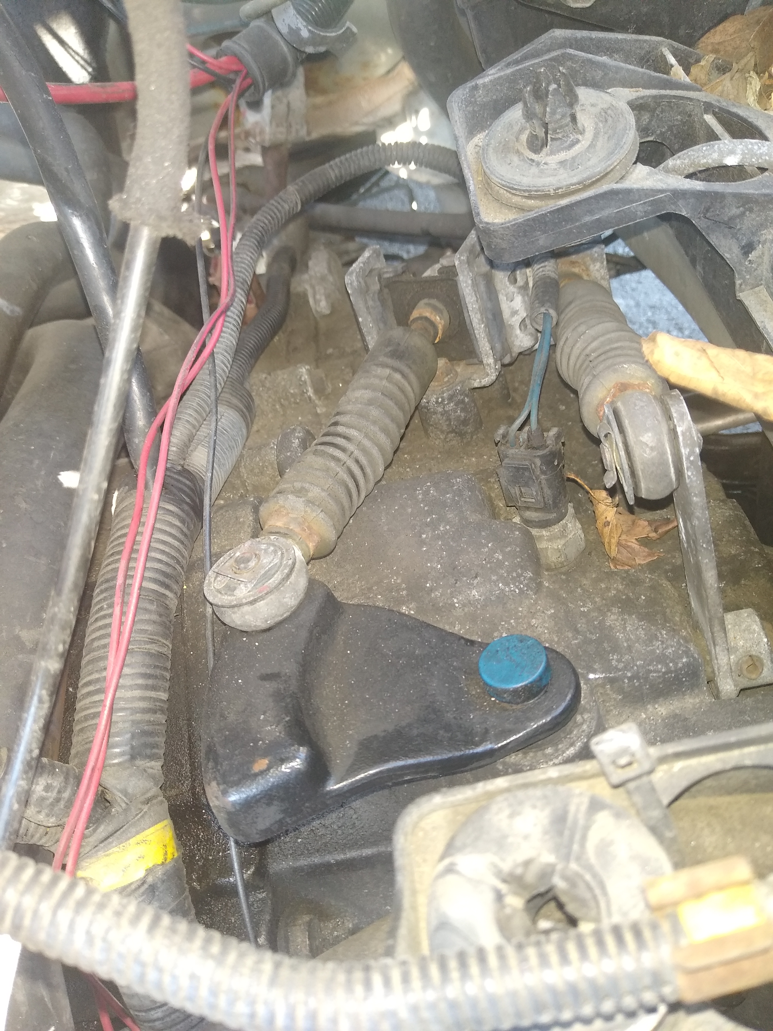

3. (Abscate help me with this one): Under the airfilterbox there's this little round thingy (cilinderform that's connected with the shiftrod/cable), in the Netherlands it's called "het rubberen busje voor de schakelstang", if that's gone it makes shifting gears really hard to impossible.
4. When the transmission was rebuild and everyting was put together, did they adjust the shifting cables properly?

It sounds like the shifter cables have come off
A one or two hour fix , should be about $200.
Here a link to a thread where you can see how these work
viewtopic.php?f=1&t=76272&p=439316&hili ... gs#p439316

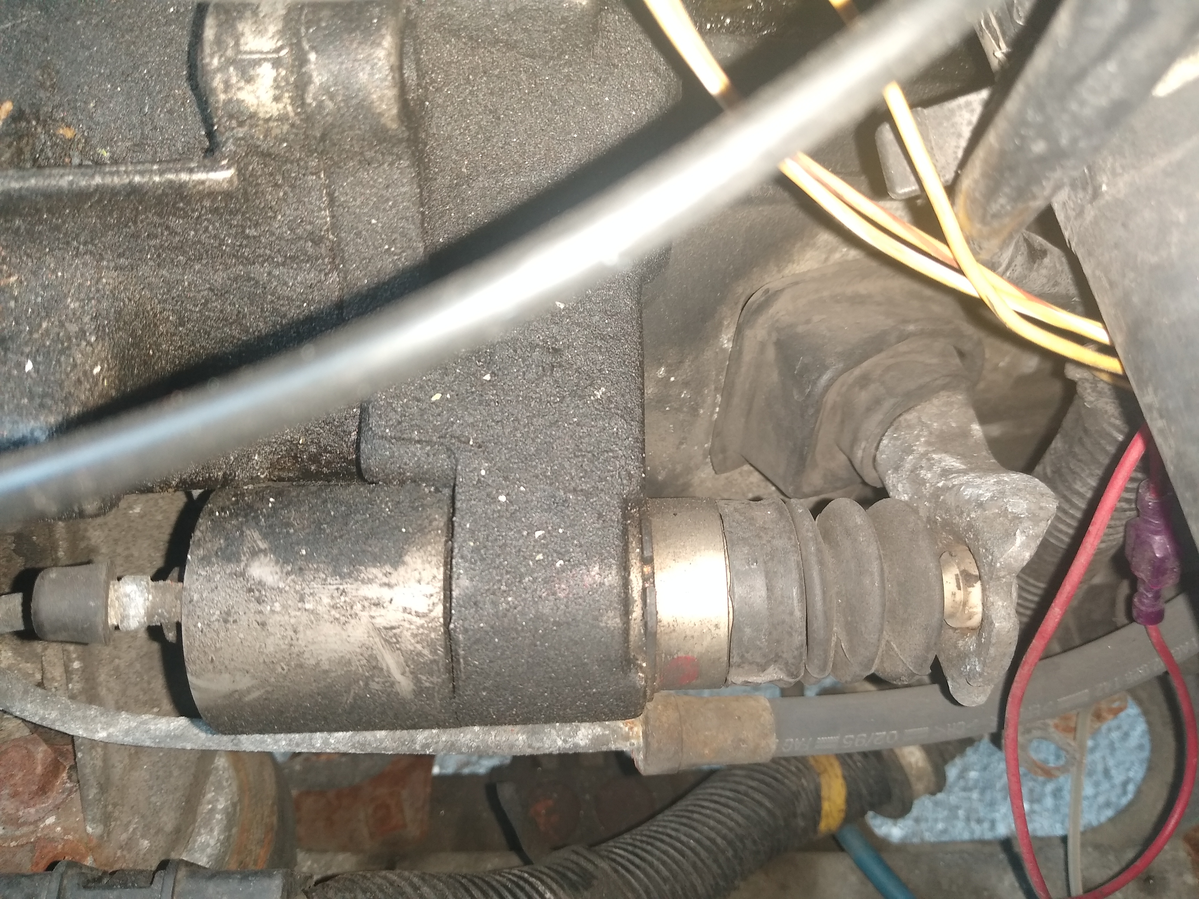

Do you have a hydraulic clutch? If so, check the clutch fluid level. Low level may not allow full clutch engagement and result in gear jamming. Can you shift into gears with engine off?

Looked at it again in daylight: the clutch still feels firm, you need to depress it to shift, but the gear just doesnt even attempt to catch, its like its not even contacting the pressure plate
Either way, it looks like Ill have to crack it open to find out...

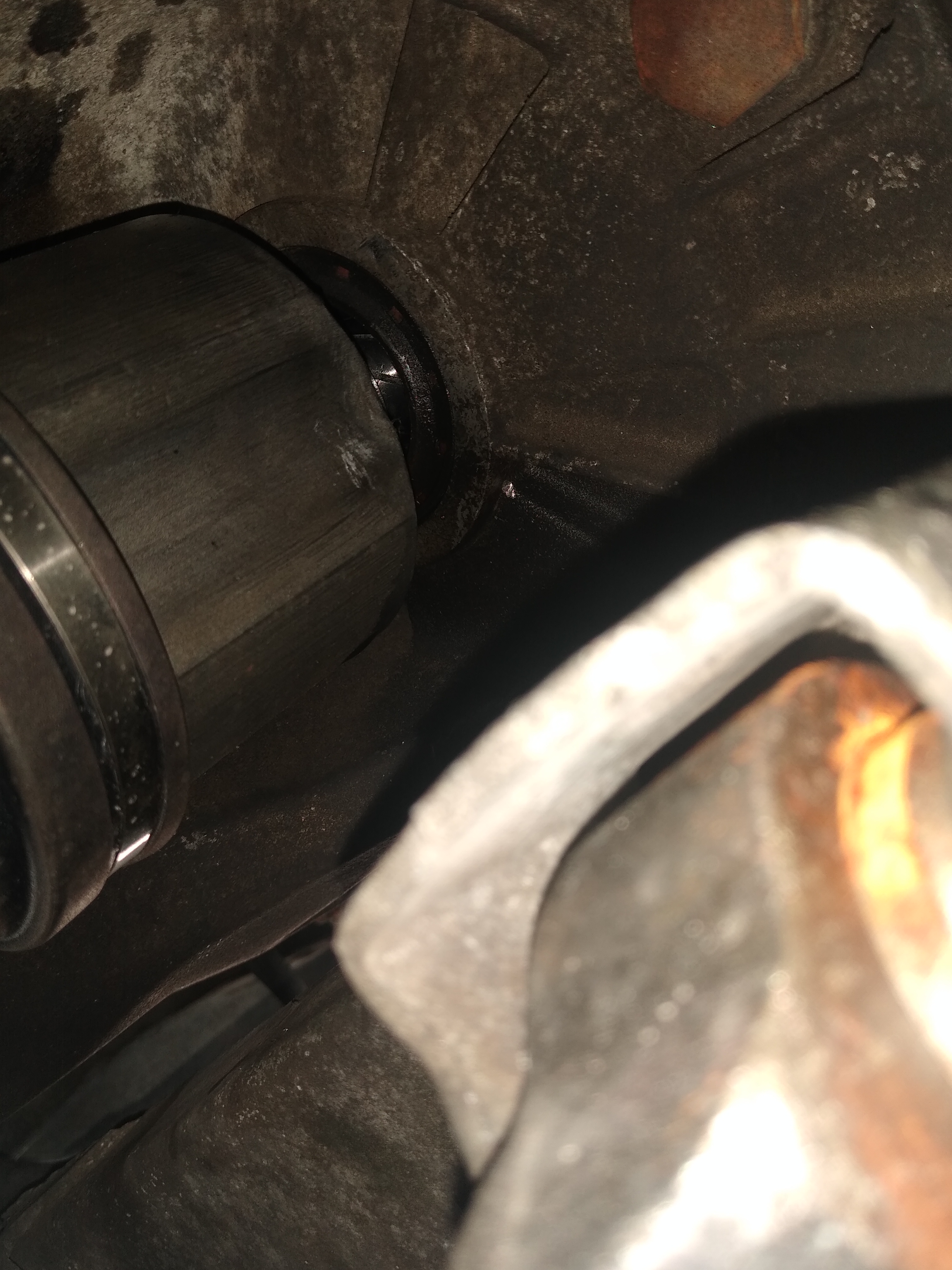

...should have mentioned i just put on a new cv axle... looks like it slipped out Neil.
I was a bit too sure of my work...
What's the safest way to tap that back in there? A hammer.... i assuming

- Posts: 36149
- Been thanked: 4067 times
It looks like the cap or boot has slipped off, too.
Use lumber on the solid part and give it a good solid whack, not crazy. It should satisfyingly click in.

So I got it back apart, and the axle has been grinded down from the tip to the lock ring... i guess its time for another axle:

- Posts: 6357
- Joined: 30 Dec 2014, 10:45
- Has thanked: 316 times
- Been thanked: 531 times
Wow! That’s a pretty extreme failure if it ground it down. I guess it’s time for an axle!
I’d also recommend changing the transmission fluid to try to flush out and metal shavings.
I had an axle pop out once about 2 feet down the road from my driveway with a cheap aftermarket axle. They’re a crap shoot.
