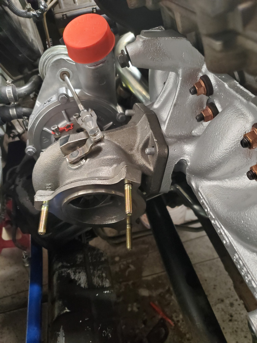

Well.. Installed the MAF backwards too. Someone save me from myself. I'm going to play the new dad card this time and say I've temporarily lost part of my mind. Car runs sweet now. Will update my car thread soon with build photos.
Here is one with the K24 mounted up in the meantime

It pays off to be persistent.. Great that you identified the issue! Wonder if it's lack of sleep that has caused it ;)
Anyway nice picture, I would really like to follow that project and good luck with it.
