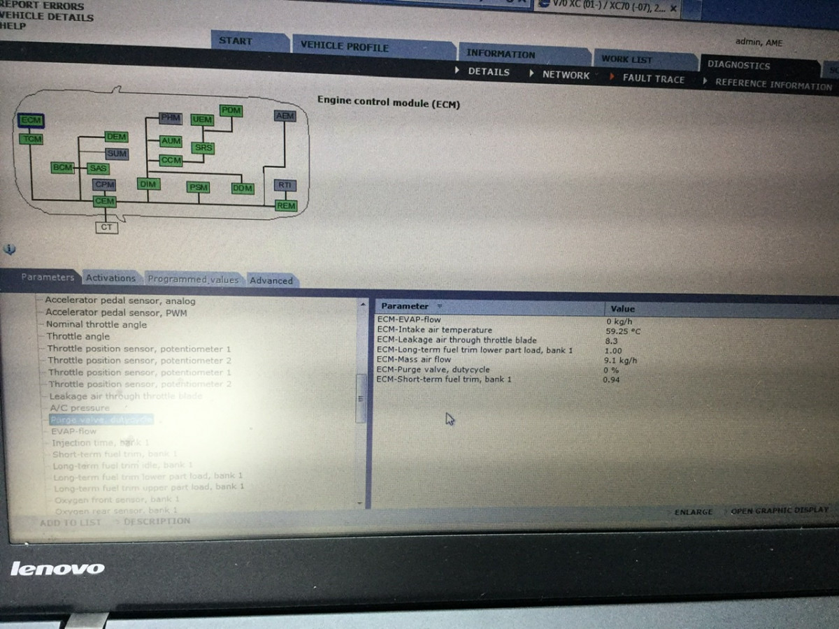

I drove the car with Vida connected and could see the purge valve was working see attached screen shot (0% when idling).

keep us updated. defiantly issues with these cars in hot climates. i notice your VIDA has alot of parameters for the purge valve, my VIDA has none only 1 parameter for the EVAP canister close valve, which the car doesnt have. what version of VIDA do you have? 2014D?
Does your car have the little fan for the ECM, mine doesnt, the ECM gets really hot on warm days. I have one on order, i hope its not lost at sea, i plan to wire it to activate whenever the ignition is on. Ive heard of people putting computer fans in there.
