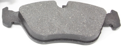

Sorry for yet another forum post on brake pads.... I know there have been a lot of them and I did search first to see if there was a recent comprehensive comparison of pad options and didn't find one....
I have replaced the pads and rotors on my '97 855 with Volvo blue box (Roulunds) pads and ATE rotors and I'm getting a squeal just as the car slows down to a stop when braking. Before switching to the Roulunds pads I used Akebono ceramics which were great -- no squeal and no dust -- but they seemed to not grab as well when cold compared to the Volvo pads.
I am using ATE plastilube grease between the pads and the calipers.
I'm thinking of switching to ATE pads as sold by my favorite forum sponsor FCP
https://www.fcpeuro.com/products/volvo- ... e-31341243
I noticed there were no reviews of these ATE pads on their website. Has anybody tried ATE pads? How did they perform? How do they compare to Jurid, Pagid, Textar, Bosch? I noticed IPD (my favorite MVS site sponsor) only carries Akebono, Bosch and Volvo... is that indicating that they are really the top brands for our car?
https://www.ipdusa.com/catalog.asp?CAT_ ... archwords=
Thanks.
