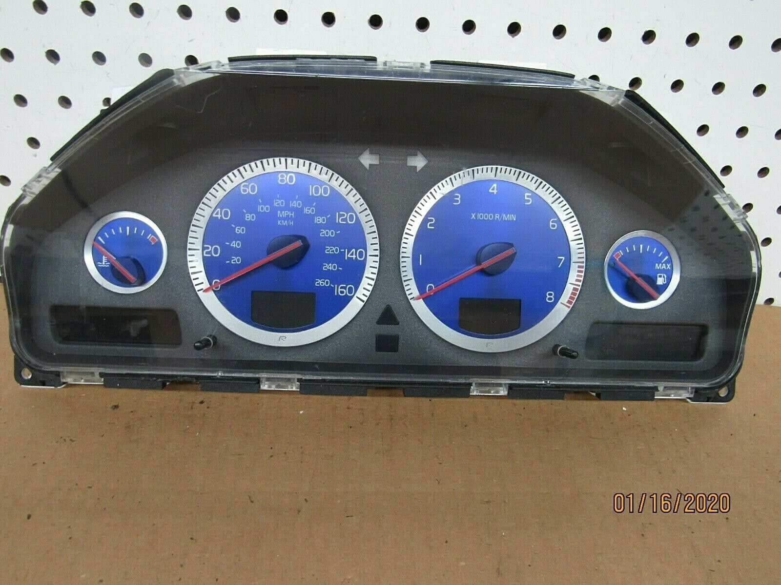

I went to my local junk yard and found a door lock, ignition lock and key for $20. Knowing Volvo and their anti-theft systems, I also grabbed the antenna ring around the ignition switch. Now, I finally got everything installed (NOT EASY TO DO) and went to turn the key and not so much as a clicking starter. Unfortunately, the previous owner (my father) tried swapping a R cluster into it and I found out that the little message area in the bottom left corner doesn't work. So I can't even tell if its the immobilizer. I also don't know how to reset the immobilizer without a key fob

Now sightly off topic, the instrument cluster.... Do I also need Vida to mate it to the car?

For anyone wanting the "R" blue facia cluster look to replace your standard DIM, the best way is to take apart your original working DIM and remove/swap the gauges, it should work. If it doesnt remove the gauge needle and replace the facia (it peels off ).
It may be possible to buy the facia aftermarket?
