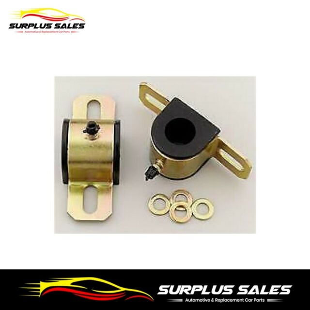

I forgot to mention i have recently fitted energy suspension poly sway bar bushings. they fitted on the bar really snug, maybe too tight, not enough grease??
The old poly mounts fitted by previous owner were very loose.
