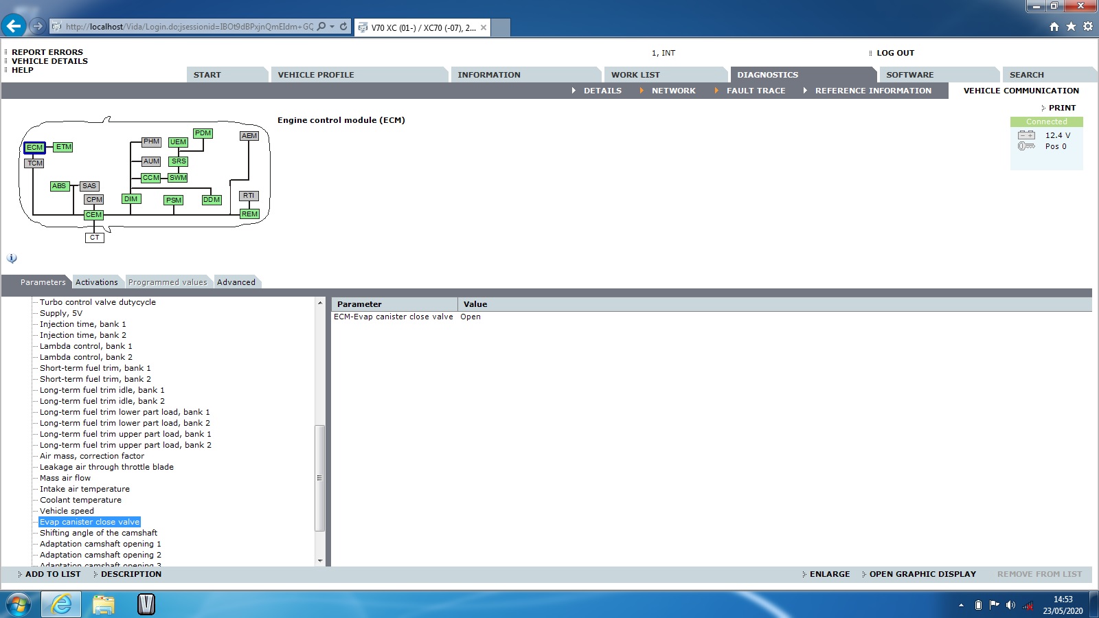

When i connect to VIDA in the parameters tab the EVAP canister valve as open when off or running. looked in the parts diagram and its not shown.
When i test it in the Activations tab nothing happens. i must not have one?
When i test run the purge valve i hear a vibrating noise?..not a closing valve noise is that normal?? (i have bench tested it and it opens and closes with 12v)
when i look in the Parameters tab to see if its open or close its not on the list only the rear canister valve is on the list.
Does my 2001 xc70 have a canister evap valve?

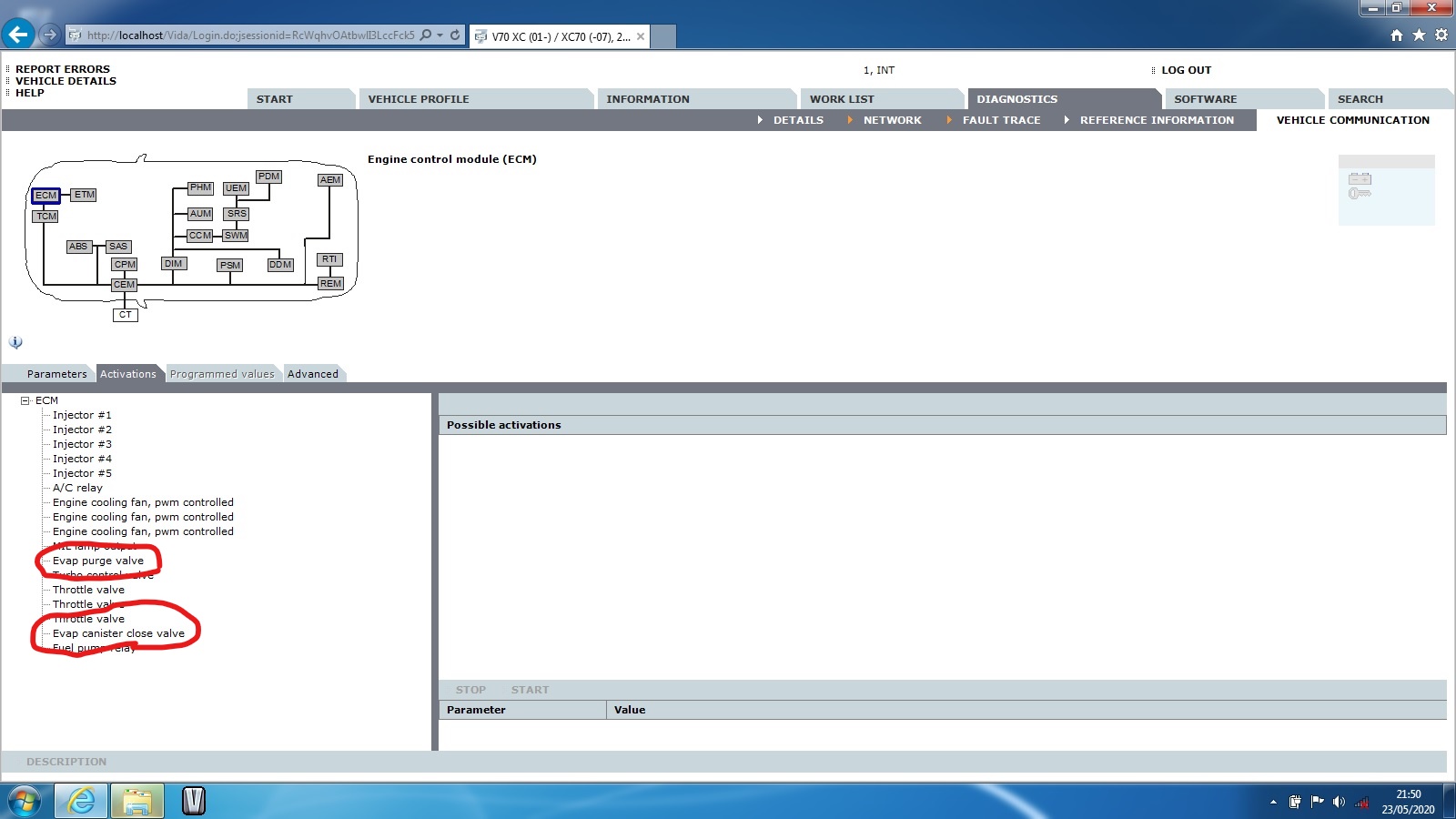

here are the two evap valves listed in the activations tab. But in the parameters tab only the canister valve is shown, the one that doesnt activate because it may not be there.
