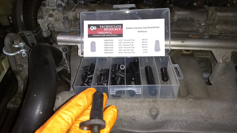

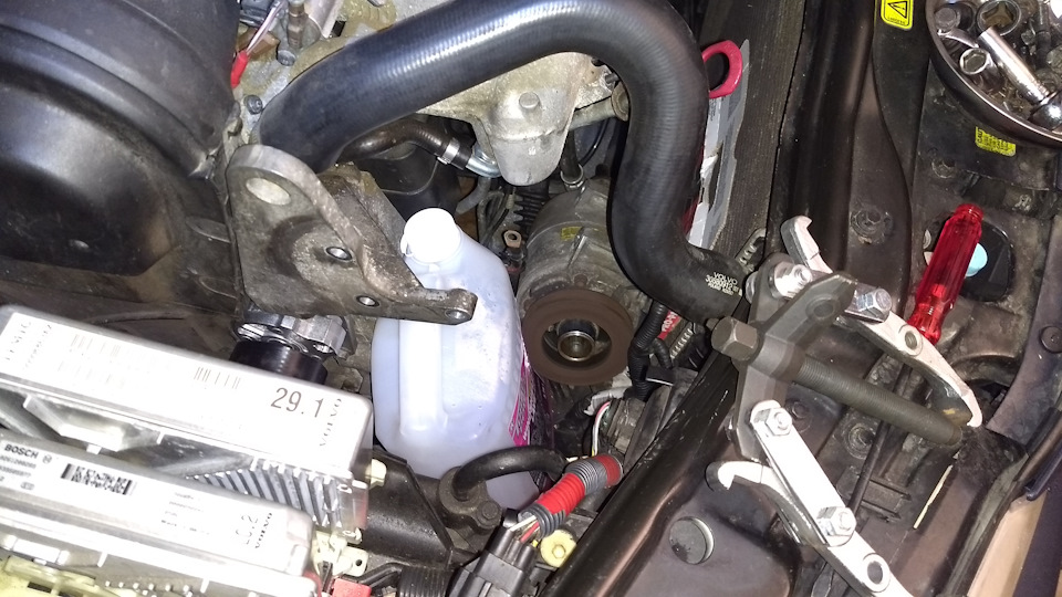

Nope, you can leave A/C system pressured. Remove engine fan, protect radiator with a cardboard, unbolt and remove PS pump, alternator and the compressor. Shift compressor backwards. You'll have enough space to remove the clutch.
I usually unbolt PS pump's high-pressure line and plug both holes with these caps:
Alternator can be taken out easily at the air box side. You see what plastic you need to pull. This is easier than opening cooling system at thermostat and loosing some coolant into alternator.

Ok vtl's picture is similar to what I did but I believe I rotated it down and worked on clutch from below laying on ground.
But overall, I removed some things and then could move compressor enough to work on it.
Tight fit and required some colorful language at times but once figured out the angles it worked well.
