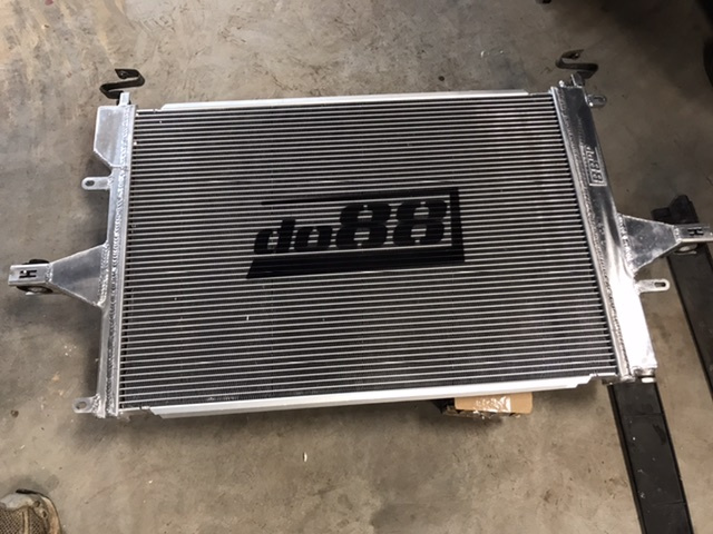

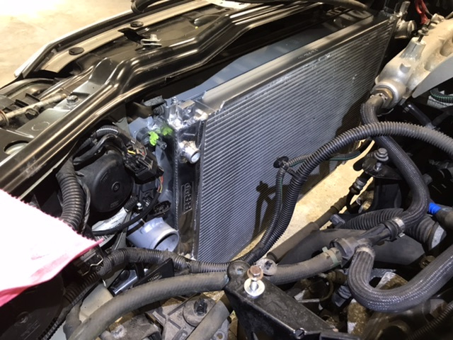

- - Pete -
- Posts: 970
- Joined: 06 Dec 2013, 22:13
- Has thanked: 81 times
- Been thanked: 178 times
I heard an ominous sound on our V70 AWD a couple months ago when mindlessly parking. I was pulling into a spot with a curb & the front of the car actually made contact. I hadn’t experienced that before, & am darn sure to never do it again. It scraped the underside of the front of the subframe, in my situation. I generally try to park in spots where I can back in or pull all the way through.
All but 1 of the aftermarket replacement radiators I’ve seen have plastic end tanks, & this is a big part of the problem. The necks crack & the end tanks separate. A company out of Sweden named do88 makes (by hand) an all aluminum radiator. It is quite beautiful & expertly crafted! I installed their radiator & their high capacity Intercooler a couple weeks back in one of my P2’s. Their radiator also incorporates ATF cooling for automatic models also.
All the places you’d usually shop can get do88 stuff, so check around for pricing.
https://www.do88.se/en/artiklar/volvo-s ... iator.html
