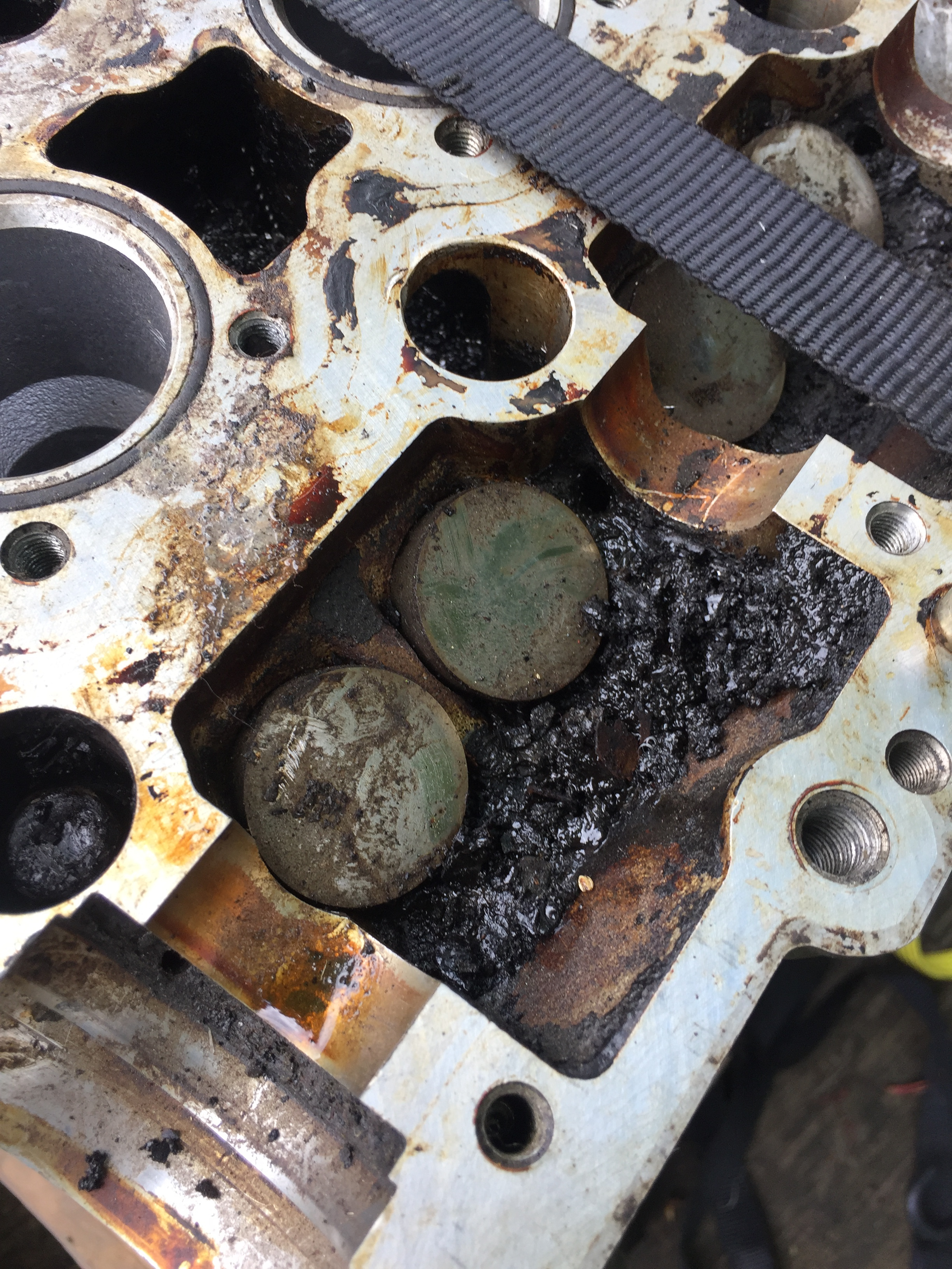

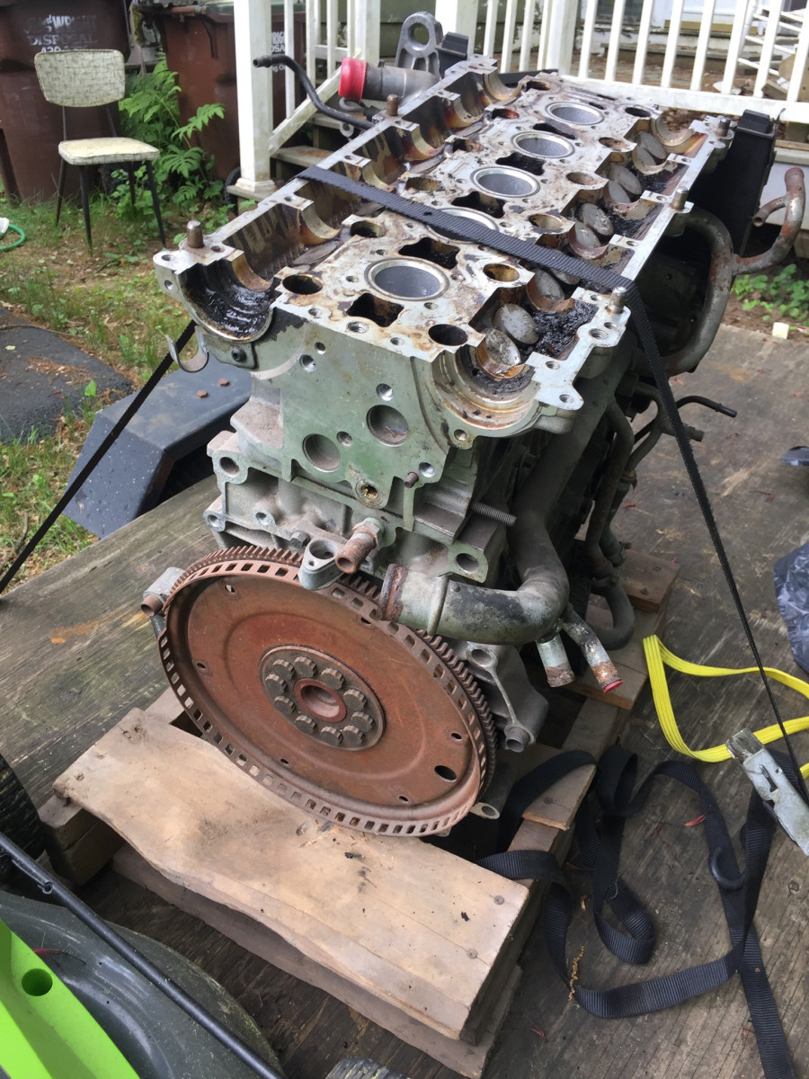

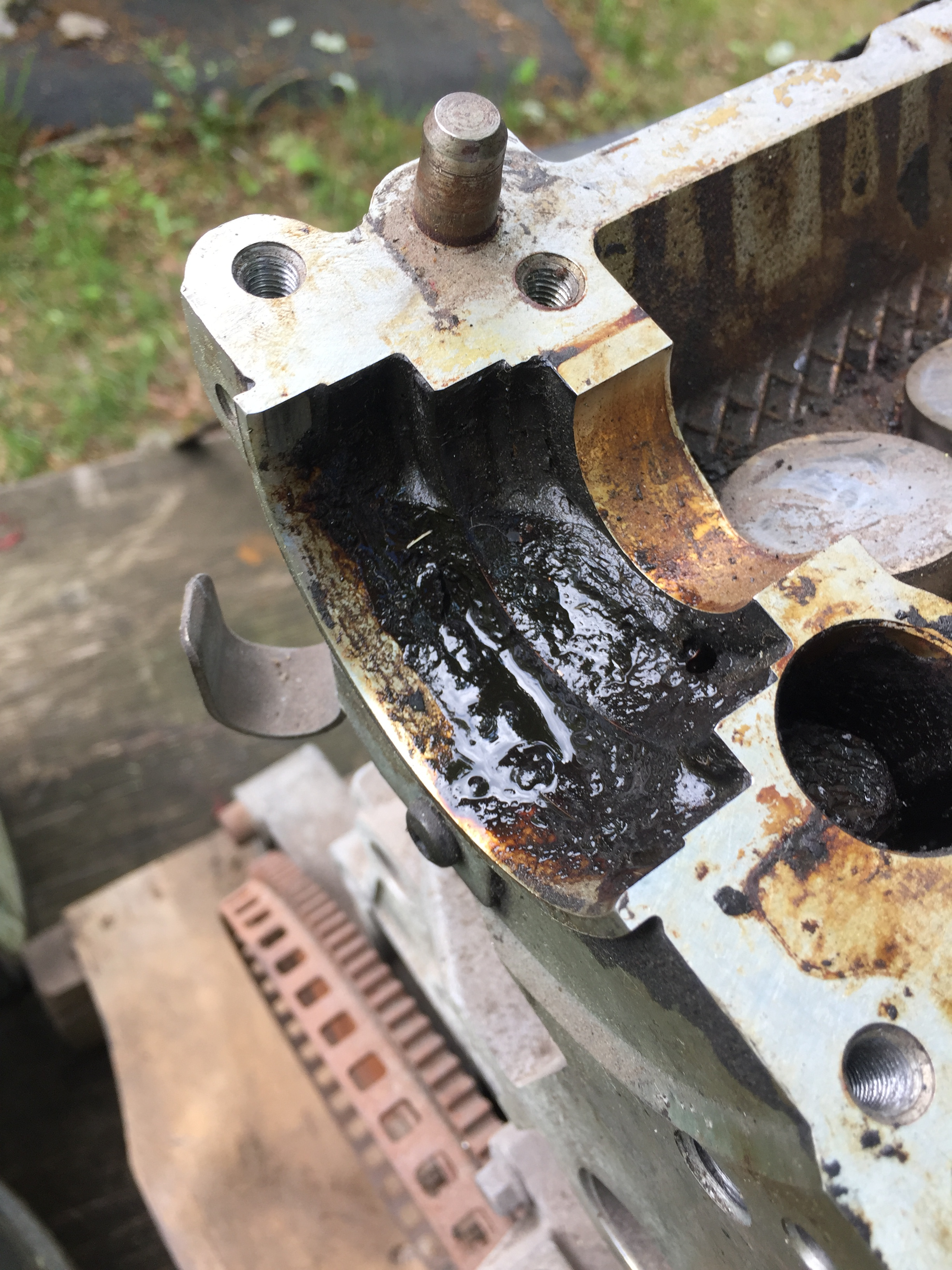

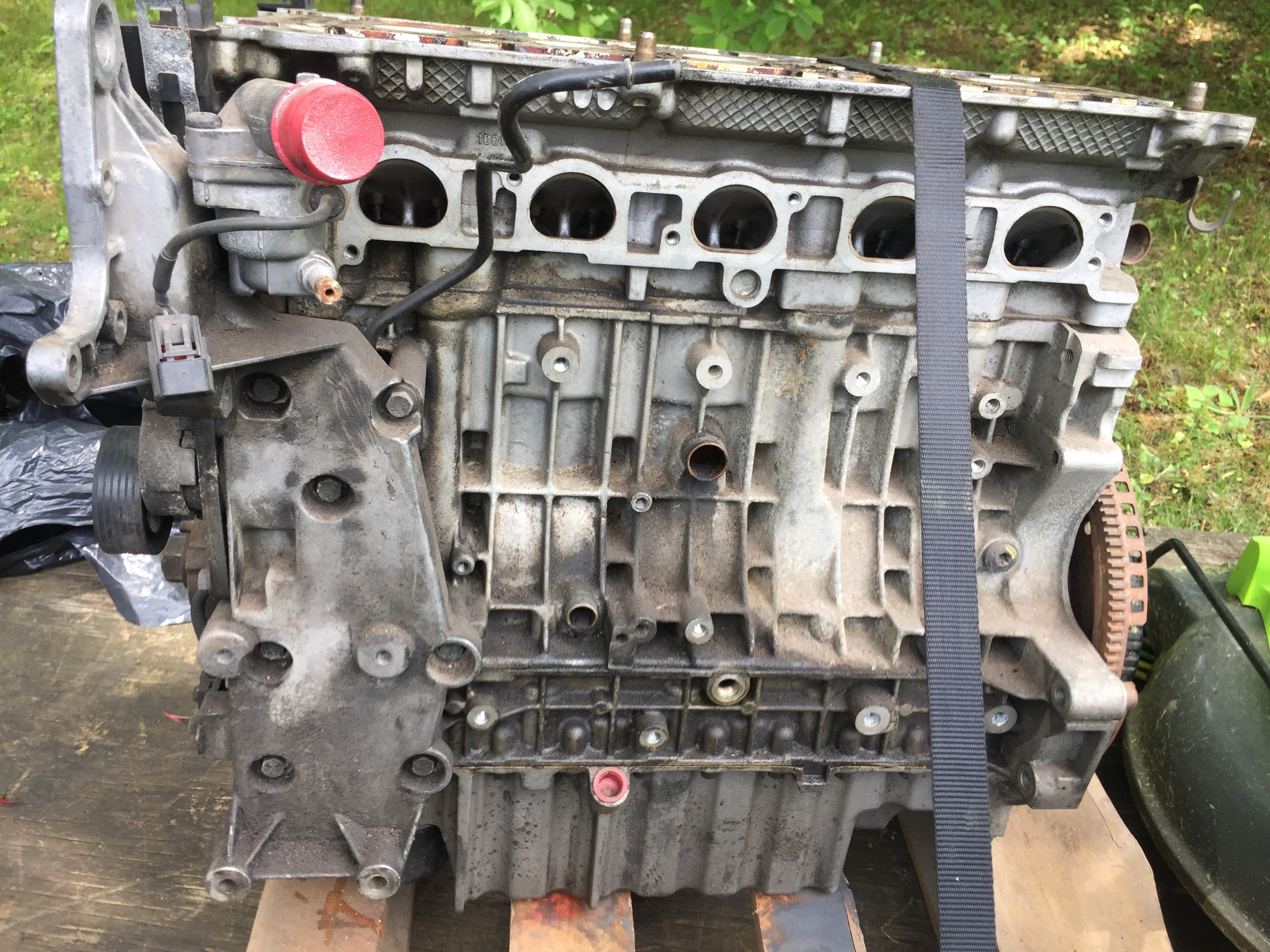

Engine running well but oil return lines heavily sludged. Plan is to remove head, rework
Remove oil pan, renew oring, oil pickup , clean crankcase.
The rebuilding of "Curious George" 2000 B5244T engine

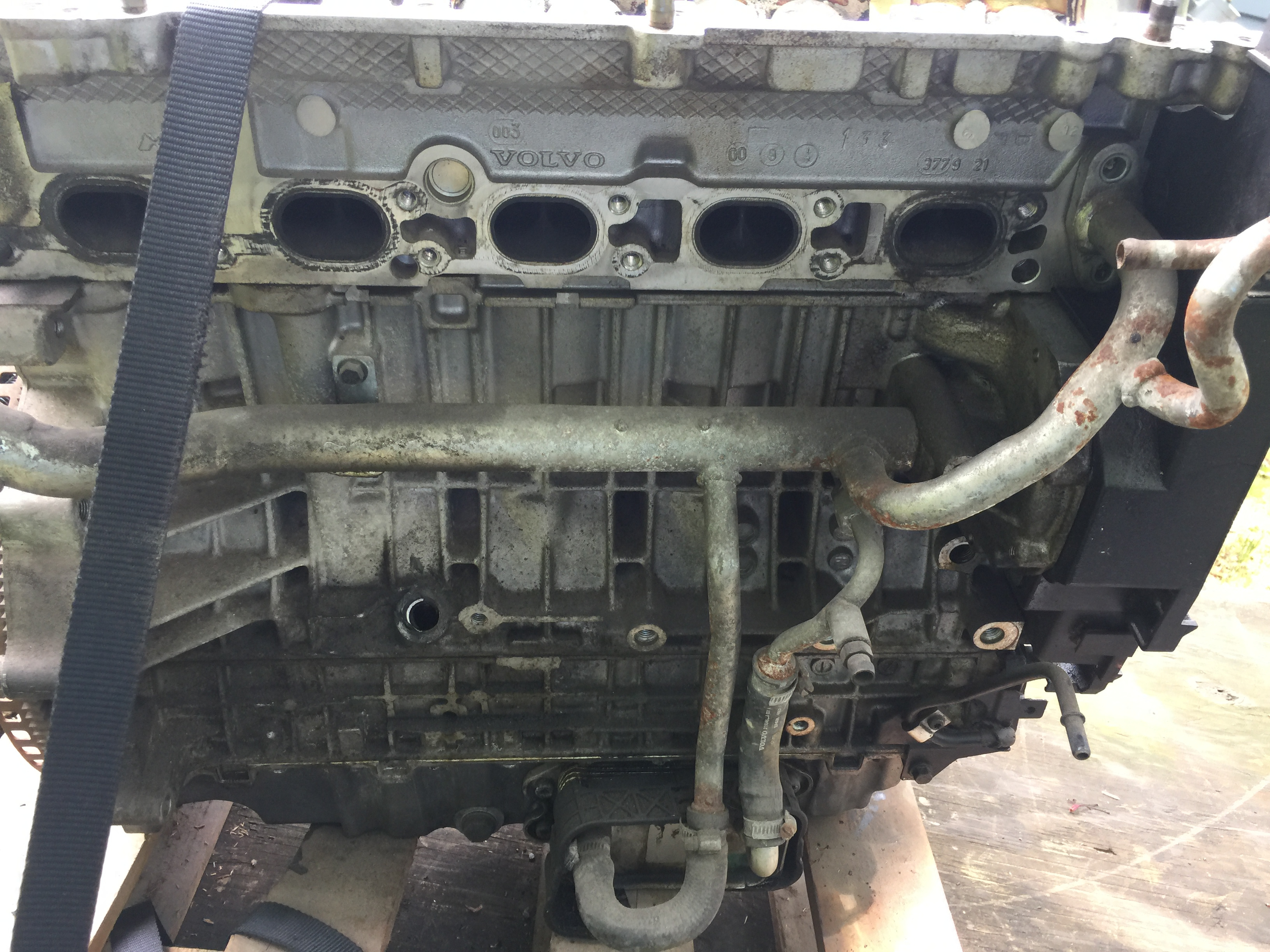

Ooh!!!!!! Those are ugly cam seal failures on cylinder #5. That poor engine.
Good luck with the clean and repair!

No, don't do the RMS! It is way more fun to pull the engine again to do the RMS after you put the engine in the car and find out it leaks... At least that's what I have been told by reliable sources.
