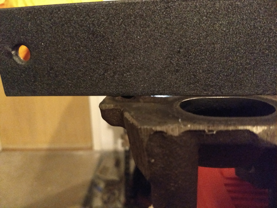

Manifold is warped. Ports for 1 and 5 cylinder are bolted to the block with 1 stud/nut only, typically they warp over time and start to leak:
Straight edge on the manifold:
Also for some reason 4th cylinder develops cracks and fractures in gasket, seen that in two engines.
You do not want to re-tighten old studs, they may break, plus it would give very little in return, since the manifold is made of steel and it is warped. Needs resurfacing. Best course would be replacing all gaskets along with the studs and nuts.
Thanks much for your detailed response. The soothe build up near cilinder 1 looks like your manifold.
Forgot to mention the whistling sound occurs with a warm engine too lately.
The cilinder head should be okay then and only the manifold needs resurfacing? From what I read this is not a small job removing the manifold.

Yes, only manifold. You can also just put a new set of gaskets and studs+nuts, they will buy you for some time to source a donor manifold and resurface it. This is what I did :)
Removing the manifold is not that difficult. Some nuts can be a pain though.
