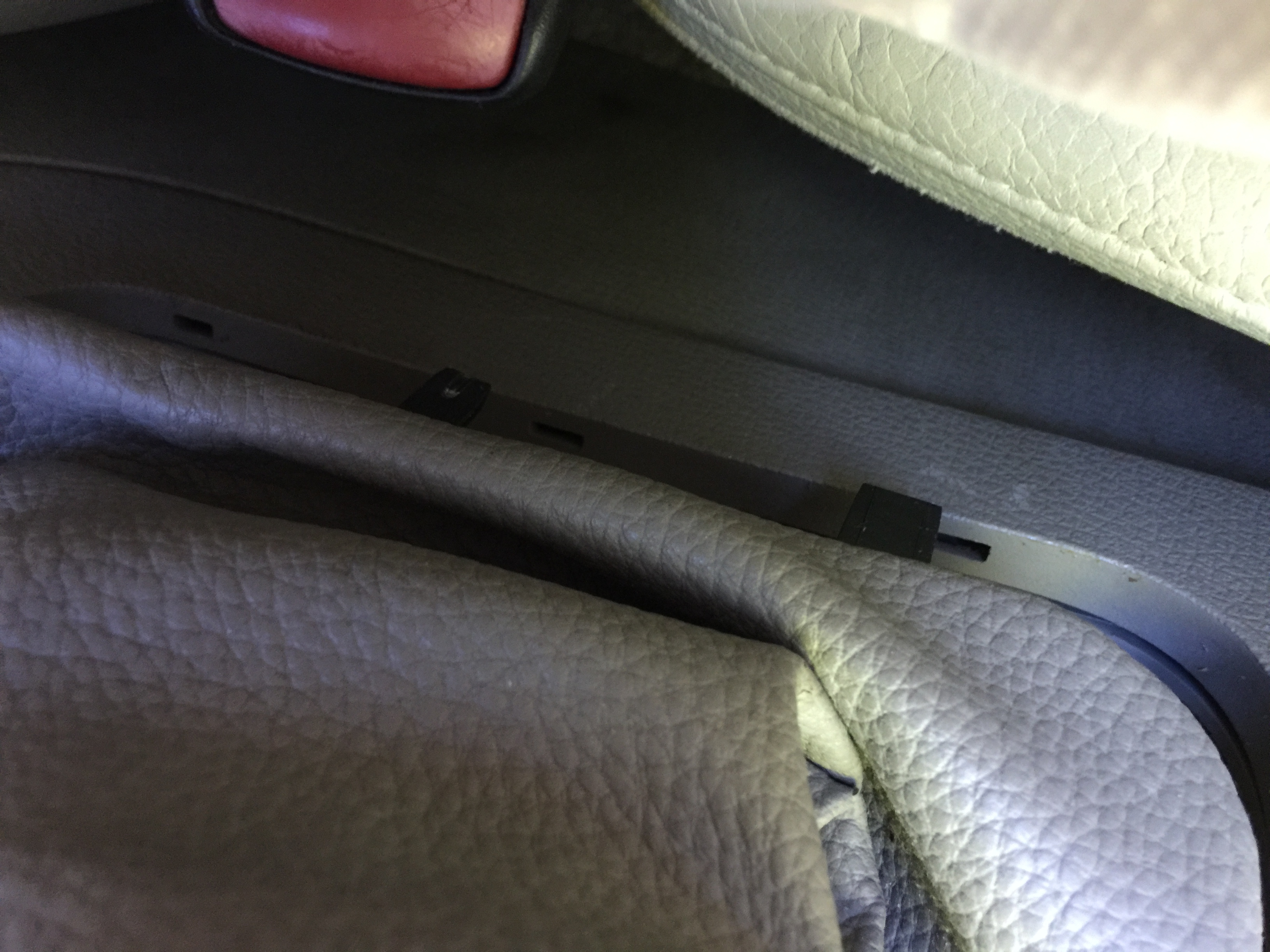

The boot comes out if the hard plastic and reveals the adjusters there.

So should I just pry along the edge of the boot?abscate wrote: 15 Jun 2020, 18:52 The boot comes out if the hard plastic and reveals the adjusters there.

It’s usually sticky from spilled soda , coffee, dead bodies so it’s a bit tough to start
I’ll meander over to my P2 and take a few pics to get the visual in this thread this morning

Just lift it up gently. I has several small pins at the bottom which easily break, so when placing it back keep a close eye at the bottom while pushing it down, so all pins engage properly - not a big deal if 1-2 break but still

Tut lifts straight up with finger pressure. Plastic fingers go into slotsabscate wrote: 16 Jun 2020, 04:09 It’s usually sticky from spilled soda , coffee, dead bodies so it’s a bit tough to start
After that, lift the brown plastic cover to see the screw

I am astonished at how easy it was once I knew where the boot separates. Never would have guessed. I just pulled up on the perimeter of the leather boot at each of the five slot locations.
Here are some additional pictures I took - same setup as abscate's.
View from left: View from right: Stealthy adjuster hiding under plastic cover that flips up:
